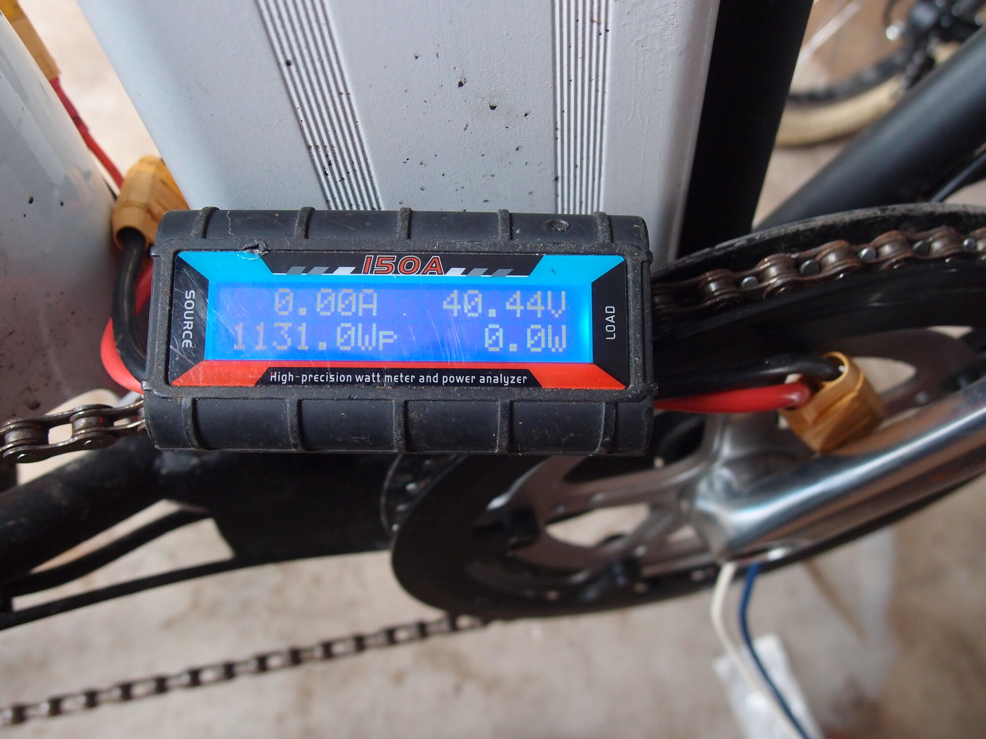

And riders with a multimeter, taking a hard ride as I explained above get to the same place. Unfortunately many riders are ill equipped to sort connectors and use a RC Wattmeter. If the battery is decent he'll have very little sag. !!KISS!!

If you want to start counting electrons, buy an RC wattmeter for about $13-15 USD. If you put it in between your battery and your charger, which is easy with some adapter plugs, you can measure how many Watt-hours or amp-hours go back into your battery when your recharge. That;s always going to be a little higher than what came out, but you can look at battery capacity with it.
The other way is to put it between the battery and the controller, but that's not always possible unless you have the wires available. Then you can measure power used by the bike, as well as peak current.
They have some accuracy issues, but for $15, you only need relative numbers.
