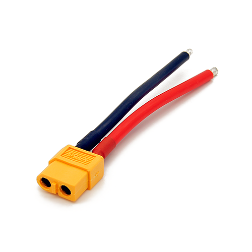

Hello I need some info from experienced e bike owners I have an electric bike and its connector for the motor to the battery is a 3-port house plug like this:

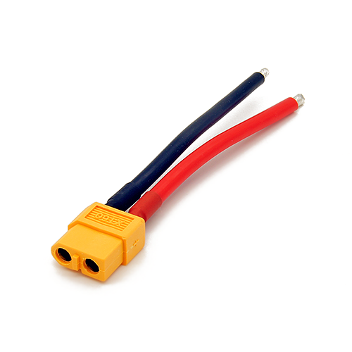

but when I search for an official name or serial number for a plug like this I can't find any. I need to know so I can find a converter to fit to the new battery I bought that uses a xt60 plug like this:
any ideas? any help at all would be great.

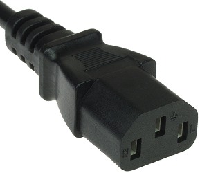

That is an IEC socket. I realize external is male, but the IEC plug is a female receptacle that has male pins.

Now I need to convert the 'controller', that receives the power from the battery, from a four blade/pin connector* to a C13 or C15 plug that is directly wired into the controller just like the four pin/prongs are. I need to do this because the battery housing does not contain the four pin connector to connect with the controller. I recall that the bike itself is the ground on this build - but do not know if I need a C13 or C15 (grounded and rated for higher utilization) connection. Can you suggest which one I should?
If I should just use a left over C13 - what does the wiring look like since the red/black scenario is not valid - the plug has green/white/black.
