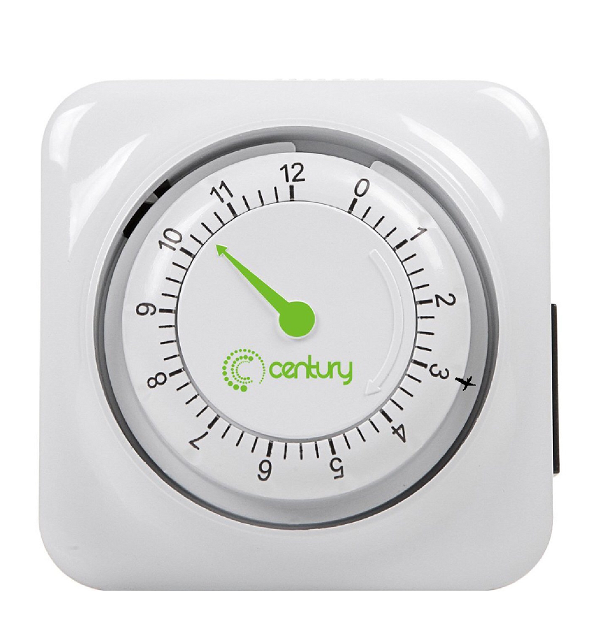

To maximize life, I use a plug in timer (like - https://www.amazon.com/Century-Plug...?ie=UTF8&qid=1524843329&sr=8-8&keywords=timer) and charge up to 80-85% under normal use. You can estimate roughly what that would be based on how long it takes to fully charge your battery.
If I am going to use it immediately or need more juice for a long trip, I may do 100% now and then. If storing battery for weeks or longer, I do it between 40-60%. Under normal use, I rarely let it go below 20%

I use the Century timer linked by Jazz, it's great. My goal voltage is around 51V on my ebike, and each pin on the timer is 15 minutes, and raises the voltage by about 0.3-0.4. So I calculate the number of pins needed - so if the display reads 48V, I need 3 more volts, so that's 9-10 pins (3V / 0.3 Volts per pin), or 2-2.5 hours.
I have used that style of charger for decades & they are great for things like Christmas lights etc, that you want to go on & off on a schedule automatically. But for purposes of something you just want to control how many hours or minutes it is on, and you'd start at varying time of day each time, something like this would be more convenient: https://smile.amazon.com/Century-Mechanical-Countdown-Timer-Grounded/dp/B00MVDTEXS

Having 3 batteries and 2 chargers, sometimes it becomes chaotic keeping track on all of them. I also have a habit of forgetting to unplug the charger for few days. There were also times that I went out with a half charged battery since it was standing for a long time and it slowly self discharged.
After seeing this thread about "Poor man's battery saver" ,
https://electricbikereview.com/foru...ttery-saver-satiator-a-10-outlet-timer.22564/ , I purchased 2 timers (one for each charger. Itched a marker at the 3 hour position for quick reference (at a glance) when turning the knob.
I only charge halfway (2-3 hours) whenever I come back from the trail. And then charge again to full capacity before heading for another ride.
I don't even unplug it from the wall anymore since it has an "off" position already.
I only charge halfway (2-3 hours) whenever I come back from the trail. And then charge again to full capacity before leaving for another ride.
i don't even unplug it from the wall anymore since it has an "off" position already.
Got the same one and I do just the same...get it up to 80%, then top it off just before riding.
