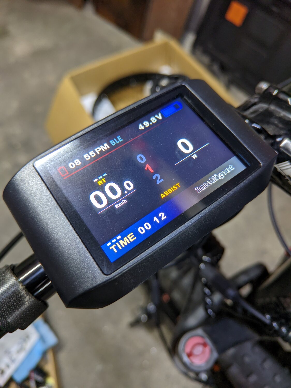

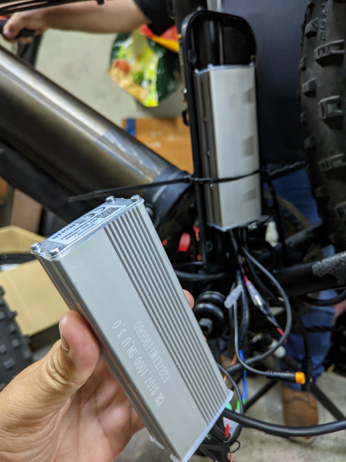

Recently I got my HUB motor from SUTTO (Bafang) with bafang 750c bluetooth display but something is wrong. My PAS never works. The throttle works fine, the walk assisty work's fine but PAS never work. I make an help assistance and bafang send me a new hub a new controller and all the accessories (except a new display) but the problem is the same. I think that the problem is configuration on my 750c or is not compatible with this hub motor. Any ideas? A new display, etc...etc..

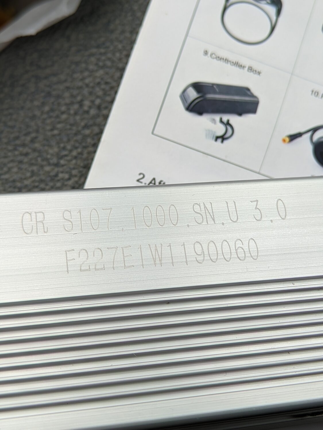

Your post/request for some help is lost here, buried under other unrelated problems. Suggest you start a new topic in this Bafang forum. That'll get your problem(s) front and center. And while you're at it, some different pics of your controller would be a big help as well - especially one showing the data plate on the controller.

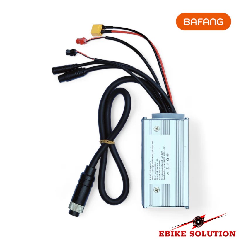

yes you can do it i have a bafang rear hub motor the trick is you need this controller AK 007 i have the same controller and i can use the bafang program tool its amazing
