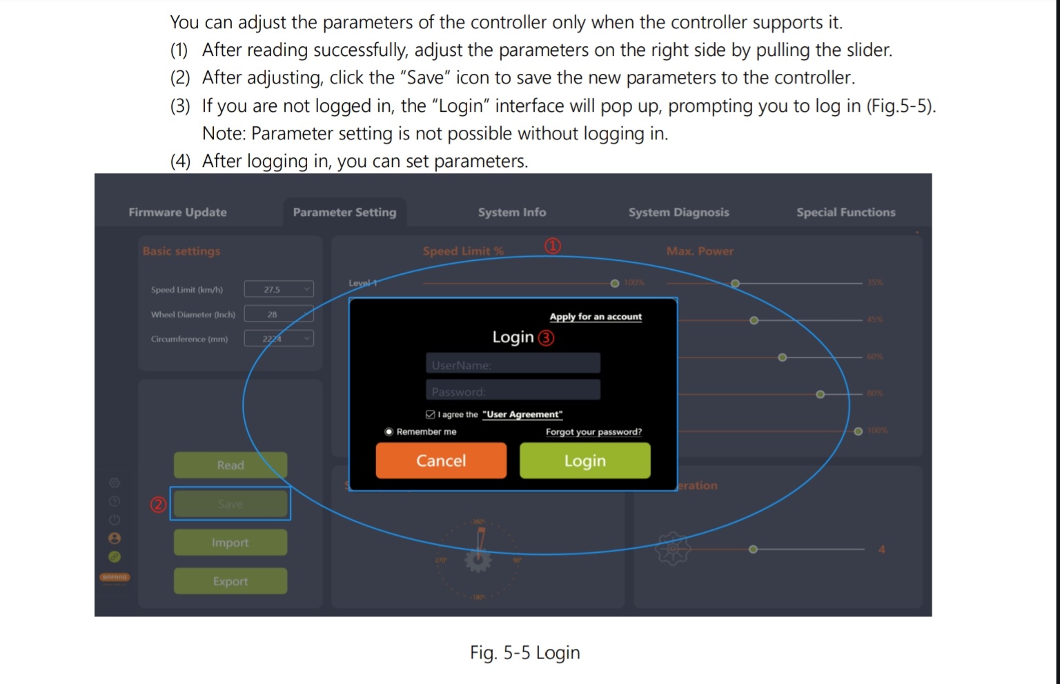

Good point, there is a tool you can purchase to be able to reprogram but it requires Bafang account. I can actually buy it from Bafang directly but not sure what documentation will be included or I can get my hands on. If I do get it and documentation, I will post on this forum. To be fair, the settings on the motor that came with by Bikes Direct Motobecane eMulekick EXPRESS are quite good with very smooth startup and transition. But when building a new bike I see how that would be an issue if you could not easily finetune it.
To get that magic username and password to be able to make the BESST tool useful, you have to be a Bafang dealership with a professional relationship with them. Its not open to end users. You can buy the thing but won't be able to use it beyond a couple of the simplest settings.

I am aware and I did see posts on some of the AliExpress listing of people getting the account setup. Not sure how at this point.
You can be sure: You have to be a dealer.
The closest thing to end user availability came from Luna for a short time. You can read how that ended by looking at their product page on the now discontinued product. Scroll down and read the product description.
