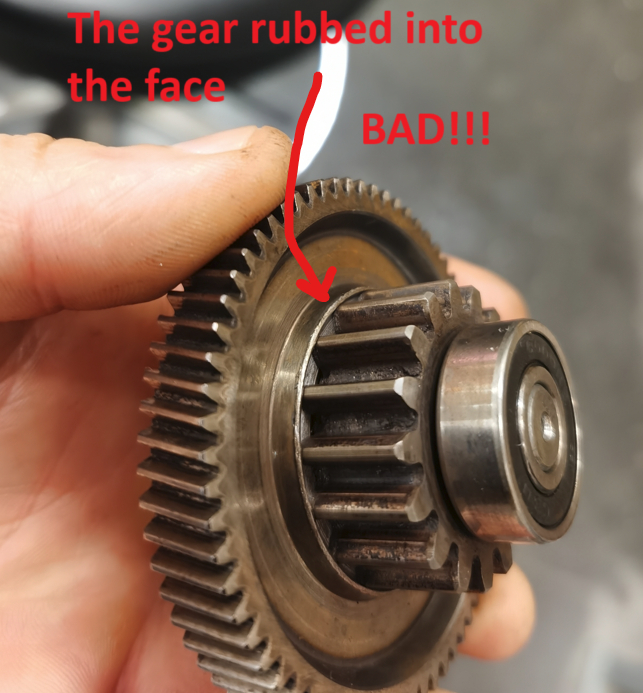

The grease pics in your link look very clean after riding for 4000 miles. When I opened it up my motor the first time the grease was discoloured, dirty and black in places! I replaced the rotor due to clear signs of wear on the teeth. I think it could be improved by another grease and/or coating. I will obtain some stuff from my work for testing but as you say, you become accustomed it to a degree, so not something I've put a much effort into up to now. I'll have a go when I next feel a grease change is needed.
