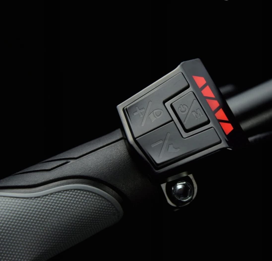

So I've never been a fan of huge screens on bikes. I like a simple battery indicator and the necessary 3 buttons in the smallest package available. I am particularly fond of simple LED units like the UART DZ39 pictured below. Unfortunately my latest bike build up has a Bafang Canbus system and it seems they are fairly limited on compatible displays. I do know about the E08 unit, and while simple, its not small or well made. I am considering getting one to gut and rehouse but that's a heap of work I was not looking to take on. Any one know of something small and simple?

I found one! It's available with or without Bluetooth connectivity for the Bafang go app. Very small, straight forward, and has decent build quality. I got it for around $40 shipped on Alibaba.
