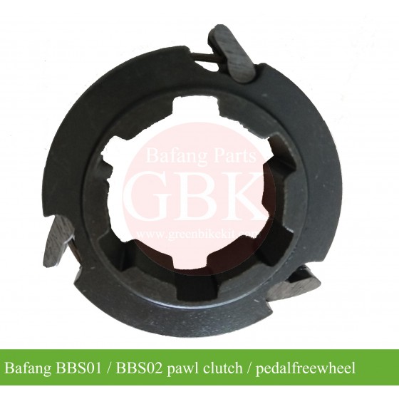

From my point of view, it seems logical that the problem comes from a freewheel. What do you think? I heard there were several freewheels in the motor, which one could it be?

Just taking a guess... But perhaps it's the clutch.
I also lean toward the pawl clutch as the suspect. It allows the motor to turn the big internal drive gear (attached to the chain) faster than the feet.
