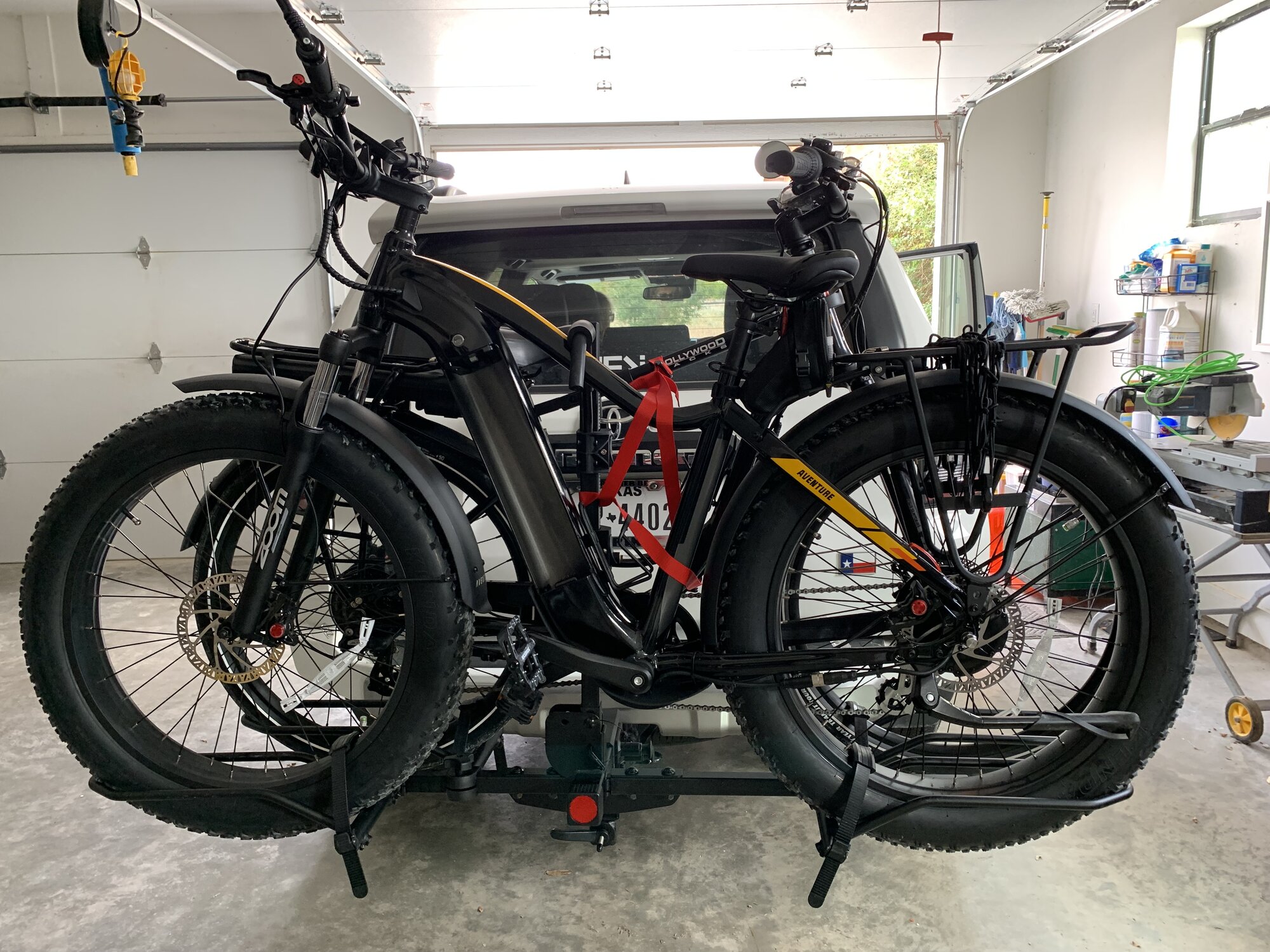

We have a Hollywood Sportrider HR1500-RAD. Carries my wife's Charge Comfort and my Aventure. Very secure.

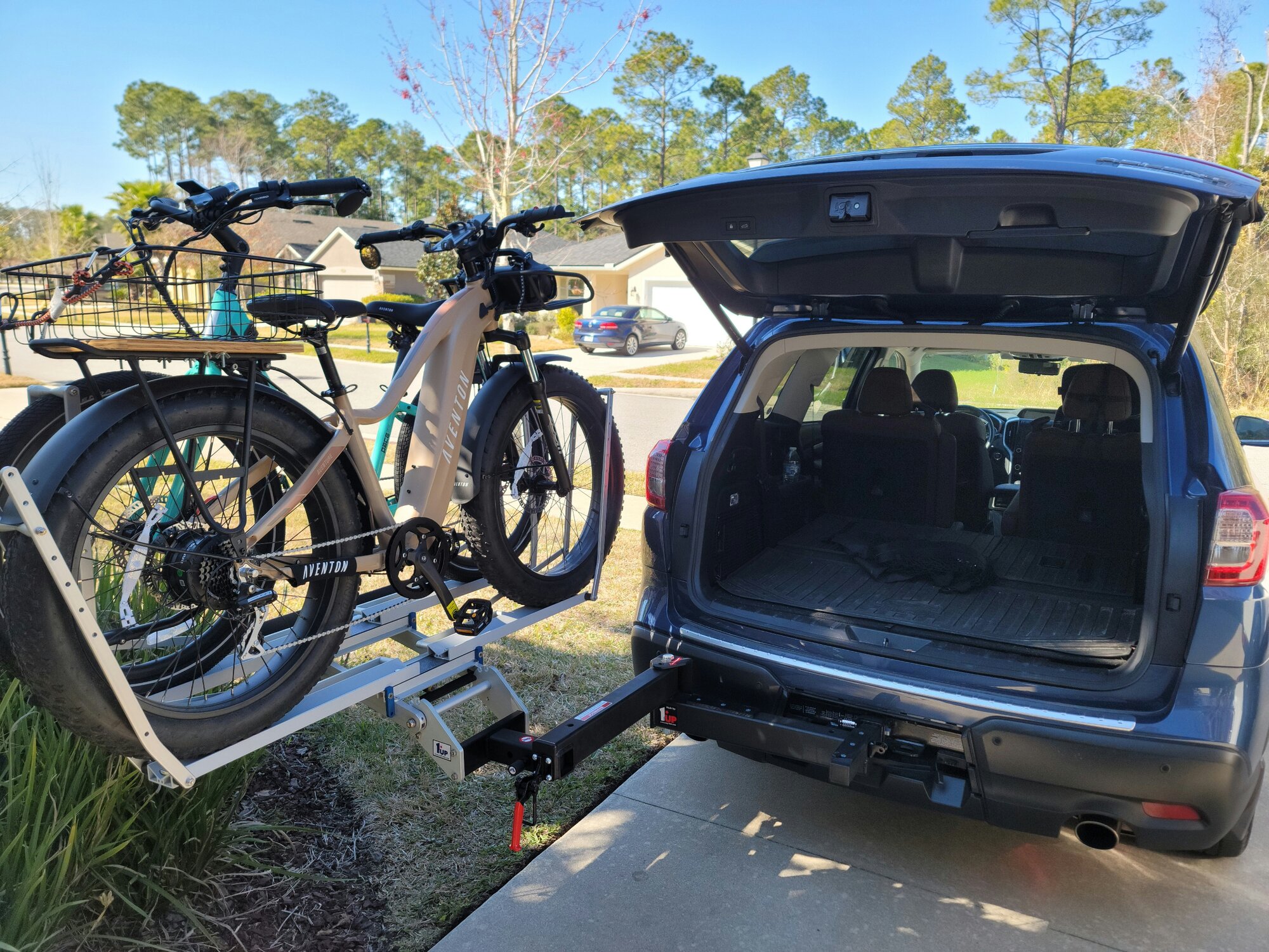

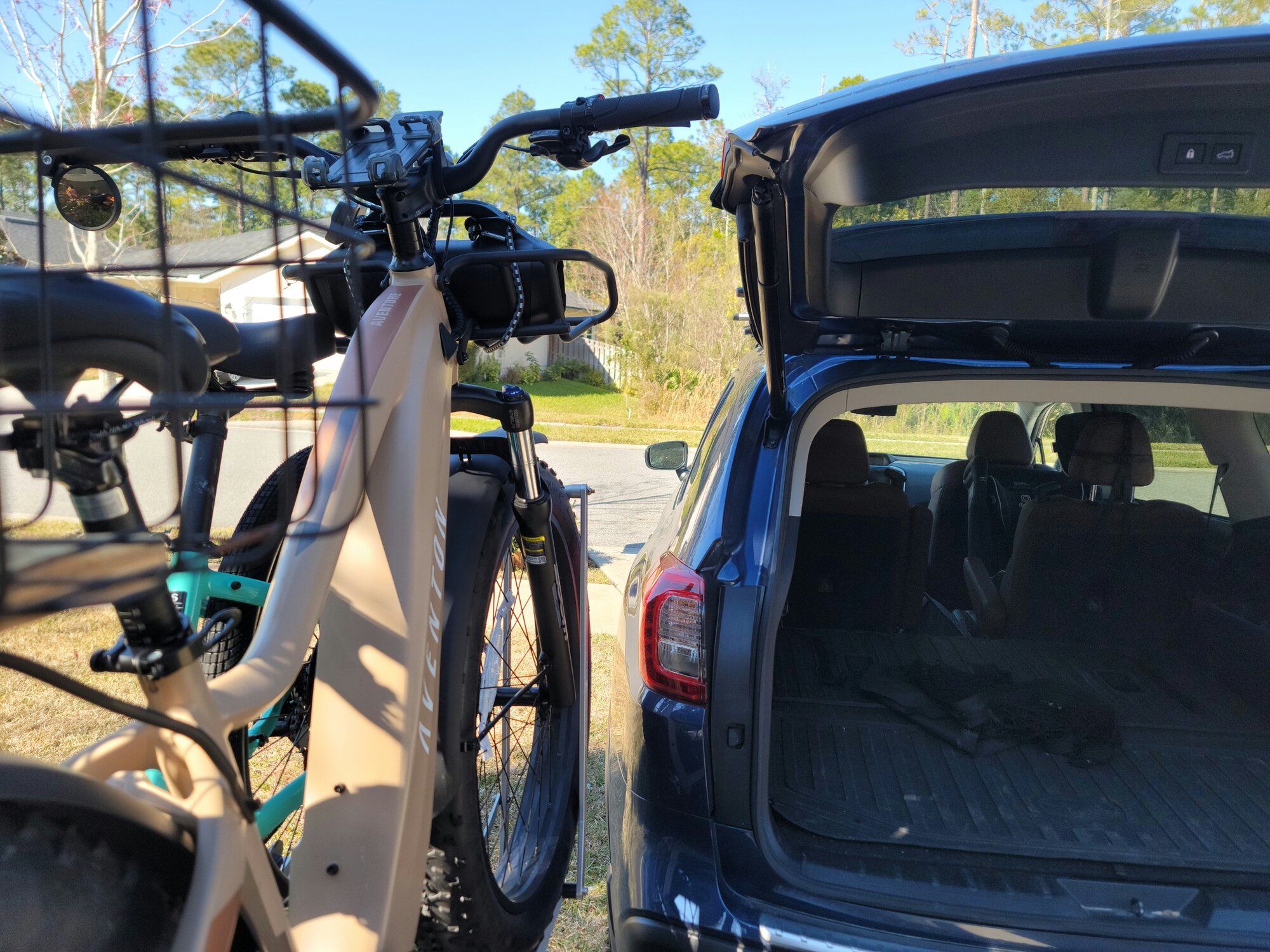

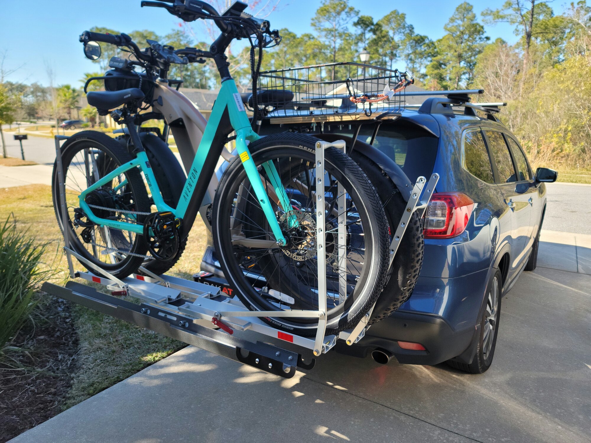

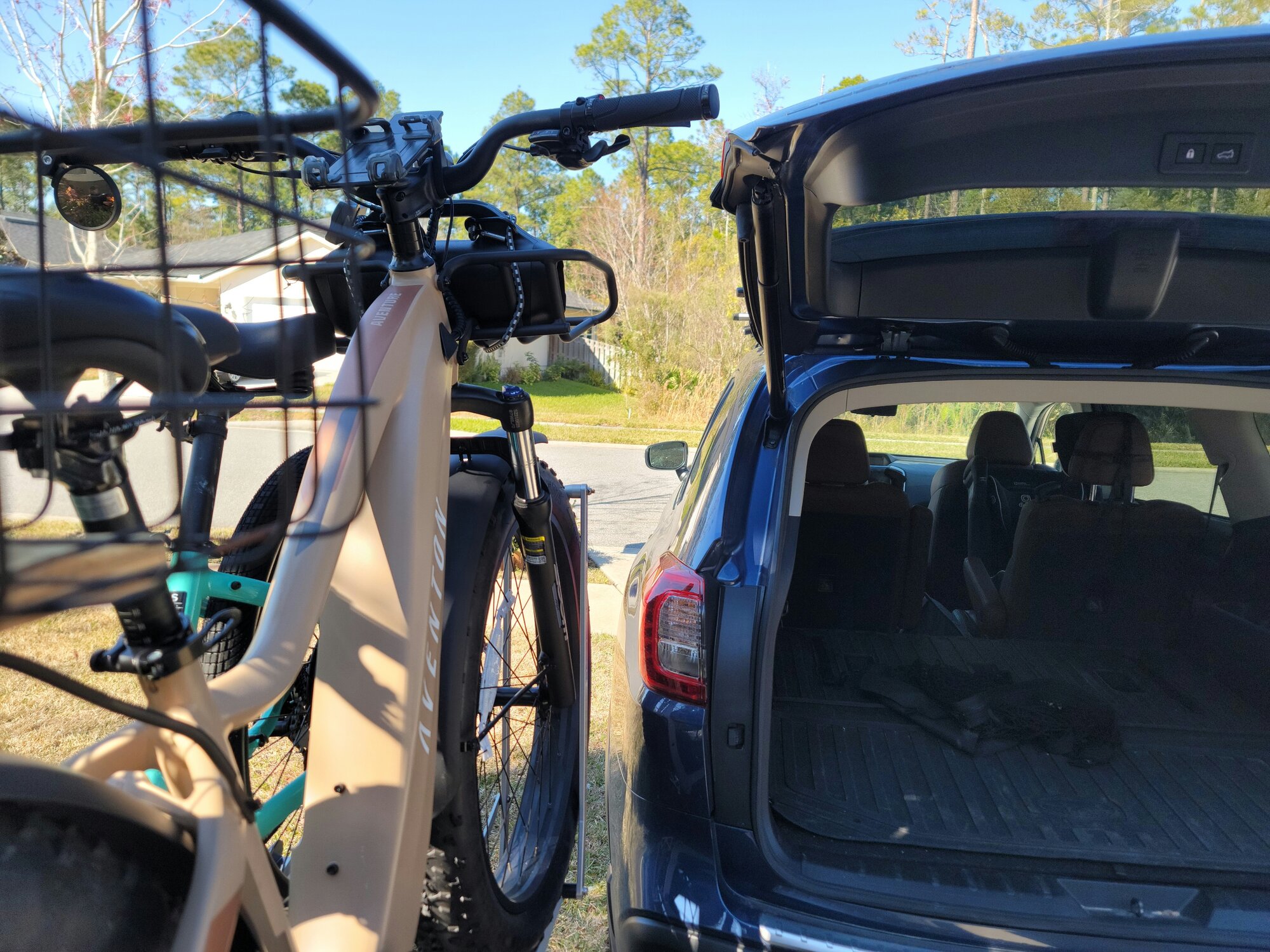

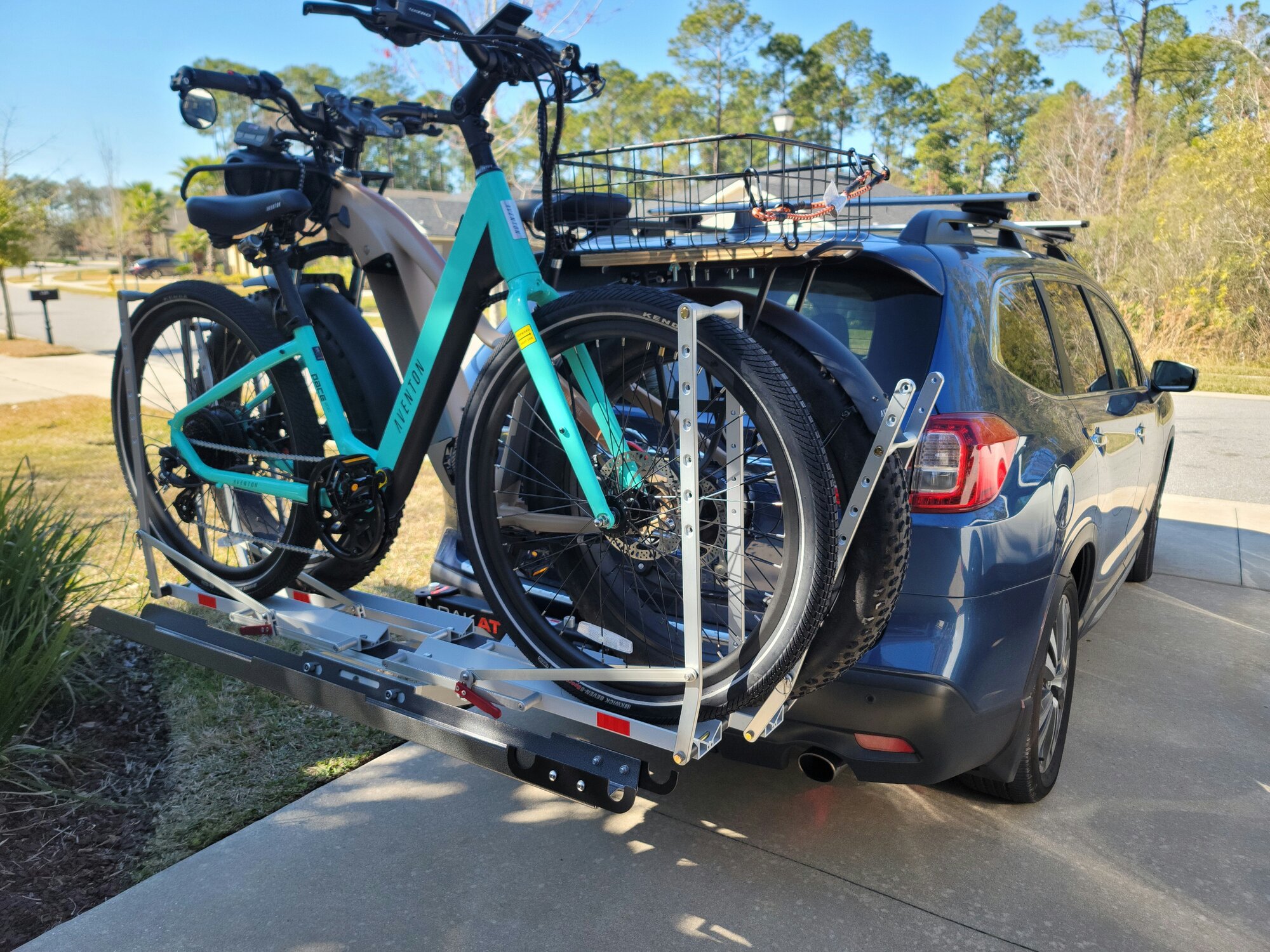

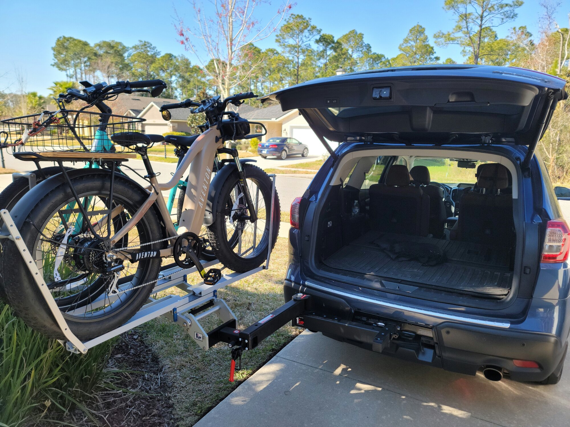

For those interested how the 1UP wheel-clamp style rack fits the Aventure fenders, here's my rack setup with our Aventure and Pace 500 on my Subaru Ascent. There's no issues with fender clearance when you adjust the ratchet bar down as pictured, and the bike is still firmly held in place. This rack is built like a tank. I took the load for a test down a very rough, washed-out, and pot-holed road and there was zero rattle or bounce. Loading is a breeze with ramp add-on attachment. Those interested in my setup, here are the rack details - 1UP Super Duty Double Rack, Fat Tire Spacer kit x2, Rakattach (Swing arm) sz med., and 1UP Loading Ramp (pictured attached for travel). Attached to factory Subaru 2" receiver.
For those interested how the 1UP wheel-clamp style rack fits the Aventure fenders, here's my rack setup with our Aventure and Pace 500 on my Subaru Ascent. There's no issues with fender clearance when you adjust the ratchet bar down as pictured, and the bike is still firmly held in place. This rack is built like a tank. I took the load for a test down a very rough, washed-out, and pot-holed road and there was zero rattle or bounce. Loading is a breeze with ramp add-on attachment. Those interested in my setup, here are the rack details - 1UP Super Duty Double Rack, Fat Tire Spacer kit x2, Rakattach (Swing arm) sz med., and 1UP Loading Ramp (pictured attached for travel). Attached to factory Subaru 2" receiver. View attachment 113128View attachment 113129View attachment 113130
Wow, that's an awesome setup. I'm thinking about getting exact same thing. My guess is the whole setup is in the $1000-$1200 range.
Thanks! Yeah, in the $1100-$1200 range plus tax, depending on how many fat tire spacers you need and if you decide to get a ramp. I got lucky and they had the right size/swing direction RakAttach I needed in stock in their bargain garage listings and saved about $100 off MSRP.
