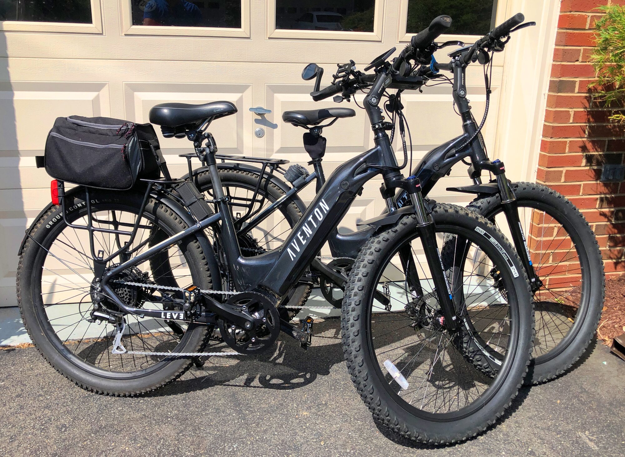

3" will fit on the front, 2.8" in the rear.
Tom, thank you so much for posting. BTW, is there a reason for going with larger front tire as opposed same size front/back? Do you change was worth the effort? Thanks again
Flyingjack, I had originally purchased a set of 3" tires for my one Level (I have two). The 3" did not fit the back so I split them and put them on the front of both bikes, and purchased the 2.8" for the back of both bikes.

I have the first gen. You should be able to measure the clearance. Also it will depend on the tire style. The front fender had to be removed.

Tom, it really looks like you have absolutely no remaining clearance on your 3.0” and 2.8” tires based on your pics. Since you have pretty aggressive knobbies I’m assuming you ride off road (which is my plan as well). Can you comment on trail performance (tires as well as the bike as a whole)? Is there any rubbing? What about in wet/muddy conditions?
Regardless, since you’ve somehow been able to fit 3.0” tires on the front and 2.8” tires on the rear of your Gen 1 Level, there should be no issue with 2.4” or preferably 2.6” knobbies on the Level.2, which is my tentative strategy.

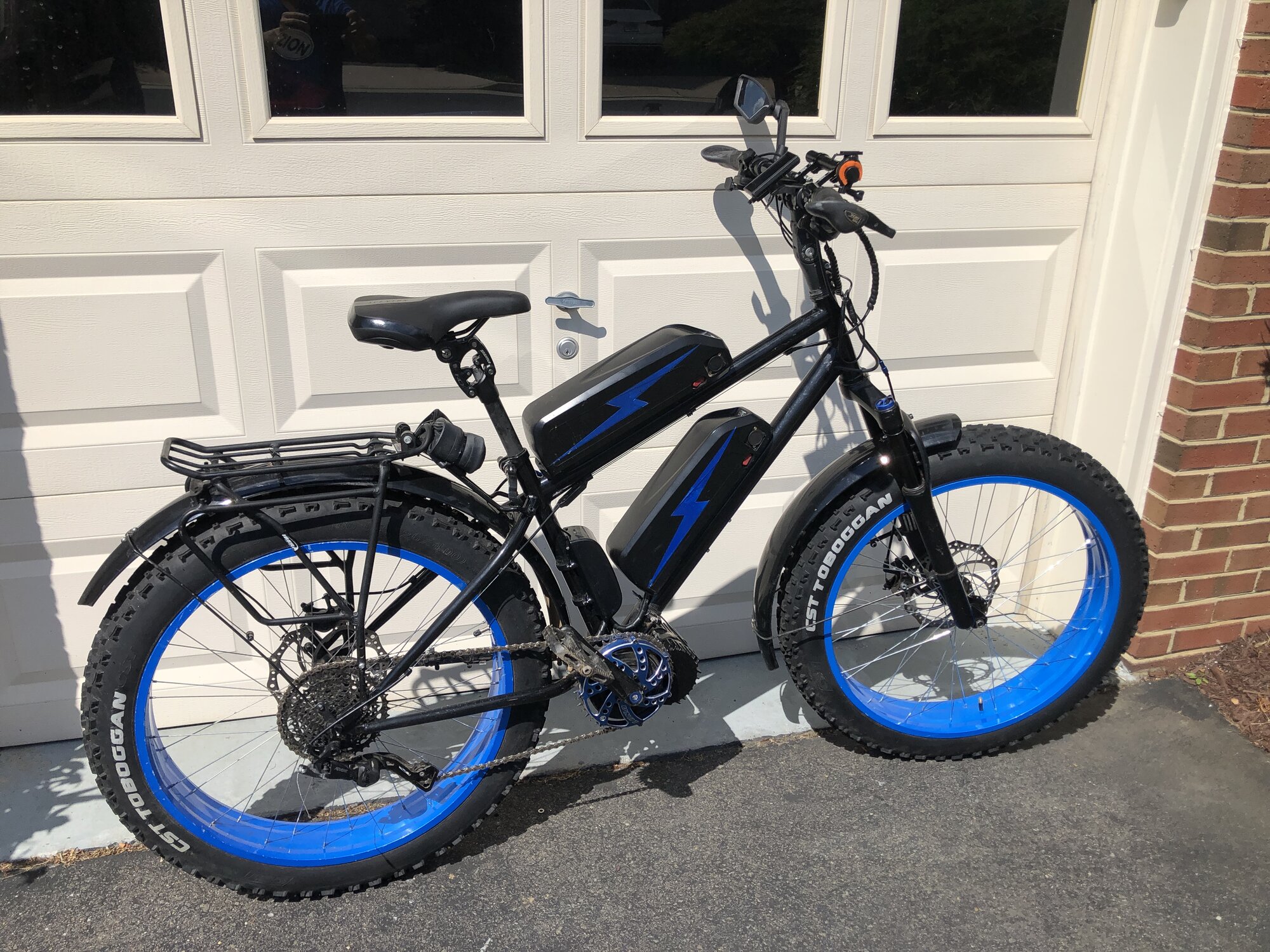

I do not really ride "off road" with my Level. In the beginning I did ride on the grass a lot, but on wooded trails it was a "bone-shaker". When I did go "off the paved trail", sporadically and I wanted larger knobby tires because they could offer a softer ride (when run at lower pressure), and they offer more control when transitioning from sidewalks, roads, grass, curbs ,etc. They are safer in that regards. I wanted my wife to have a softer ride, with more control. I also use the Suntour Suspension seatpost on both bikes which makes a huge comfort difference. The clearance on the tires is fine. Clearance will depend on the type of tread you get on the tire. The tread pattern on the front tires would never work on the rear even when I removed the rear fender. I do not experience any rubbing and they work fine. I wouldn't go with a 24" wheel bike. The lower diameter makes negotiating (rolling over) obstacles more difficult. A larger diameter is smoother. The seatpost suspension is a game changer on paved or hard packed dirt trails, but it cannot compete with rear suspension. On my Fat bike below I run with 7-10lbs of pressure.

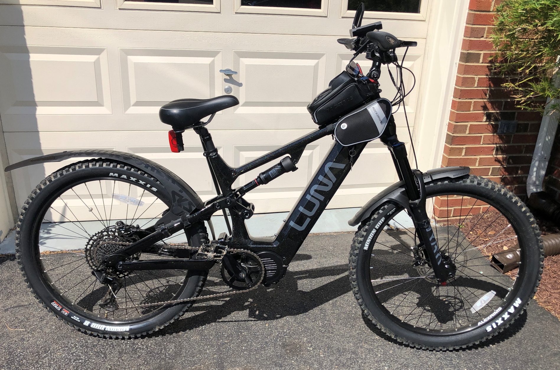

I wanted to ride aggressively off road, so I built my mid-drive Fat Bike 5 months after purchasing the Level. Now I exclusively use my dual suspension Luna Z1 Enduro for all of my riding. My Aventon and Fat Bike have been retired and relegated to being used by the occasional guest rider.
