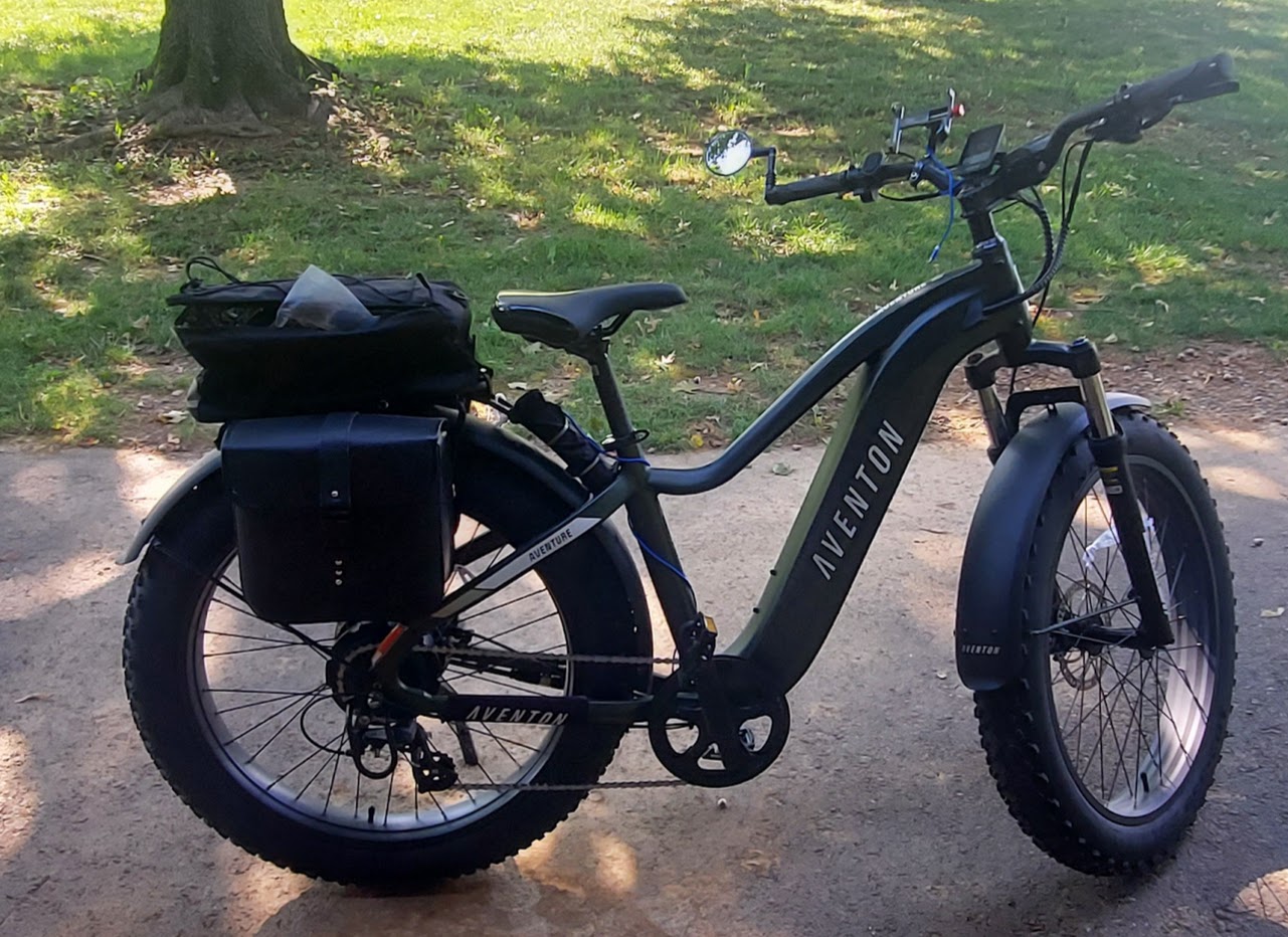

I don't care for plugging into the USB port on the display. What I did was mount a 20,000 mah "Pocket Juice" power pack below the seat. I ran the cable up through the wire track in the battery compartment and out to the handlebars. I can charge the powerpack while it's on the bike and it lasts for untold hours. Still need to spiral wrap the cable.
