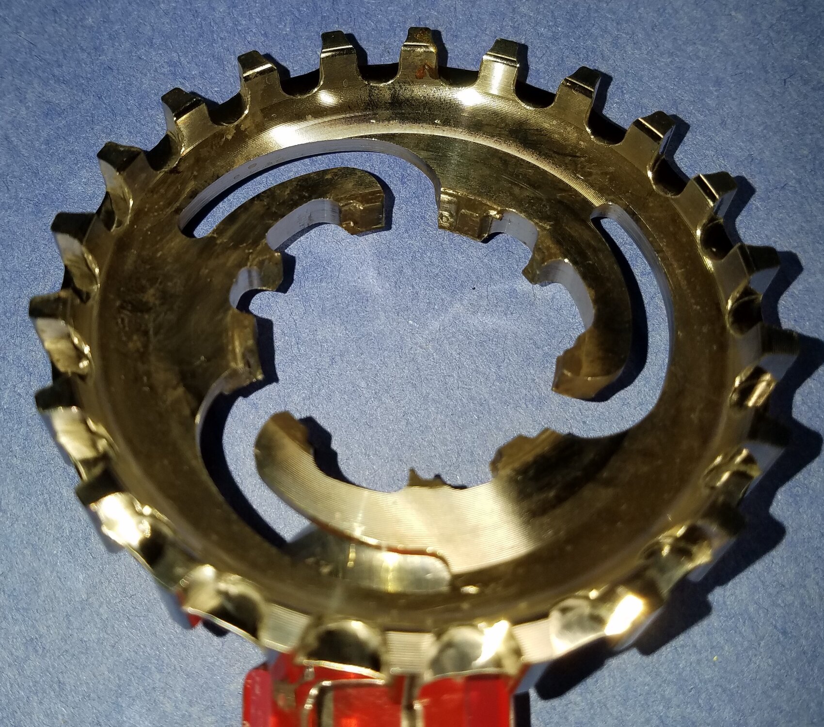

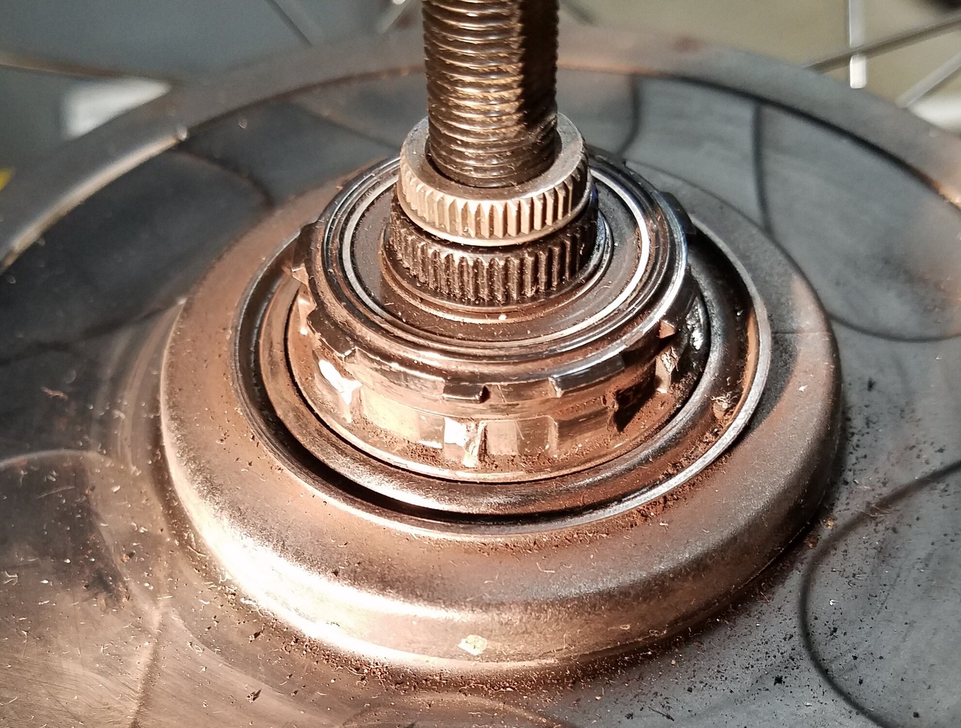

Update to the popping/snapping/knocking noises: After 1500 miles of experiencing these annoying sounds intermittently, the culprit was finally found. It turned out that the rear cog was skipping on the hub's freewheel causing a metal-to-metal knocking sound. Excessive belt tension may have resulted in the early failure but I quickly reduced the belt tension after I first received the bike so I'm not sure that was the cause. Evelo suspects that the rear Gates cog had a manufacturing defect and they quickly provided me with a new cog and freewheel along with instructions to reduce the belt tension even more. Inspection of the damaged cog and freewheel revealed fracture of the inner teeth of the cog and on the splines of the freewheel. See images. After everything was replaced, the bike is perfectly quiet and a delight to ride!

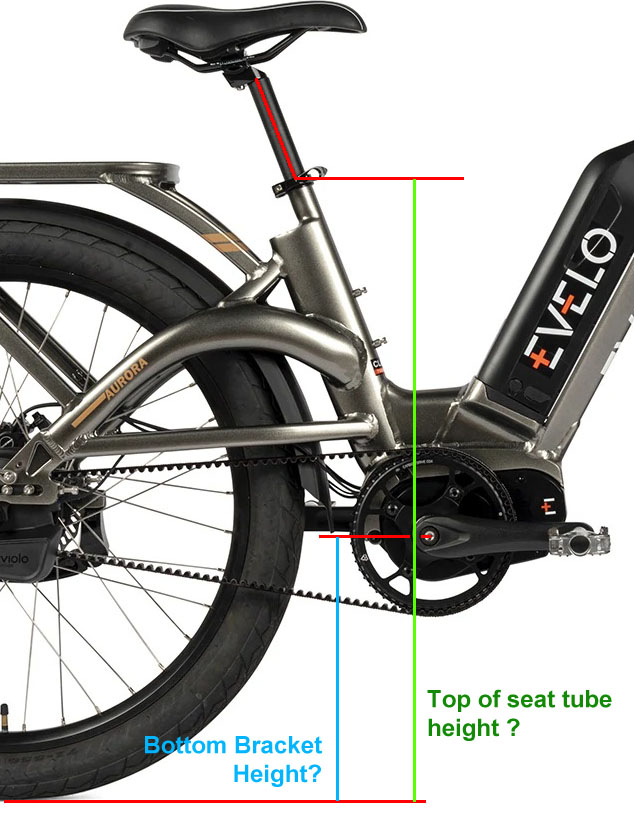

@smorgasbord , @Aurora Maven, @Don Adams, @MuttonChops or any other owner of the Aurora Limited, could one of you confirm the two dimensions below on the Aurora as illustrated in the picture?
Thank you in in advance for any help you can provide :)
Sorry for the late reply but I have been away from the forum for awhile. Anyway, the top of seat tube height is 29" and the bottom bracket height is 12.5'. Note that these measurements were performed having 26x2.4 inch tires installed. You may want to add about 0.25 inches to these heights if you have use the Innova 26x2.8-inch tires that come with the ALE.
