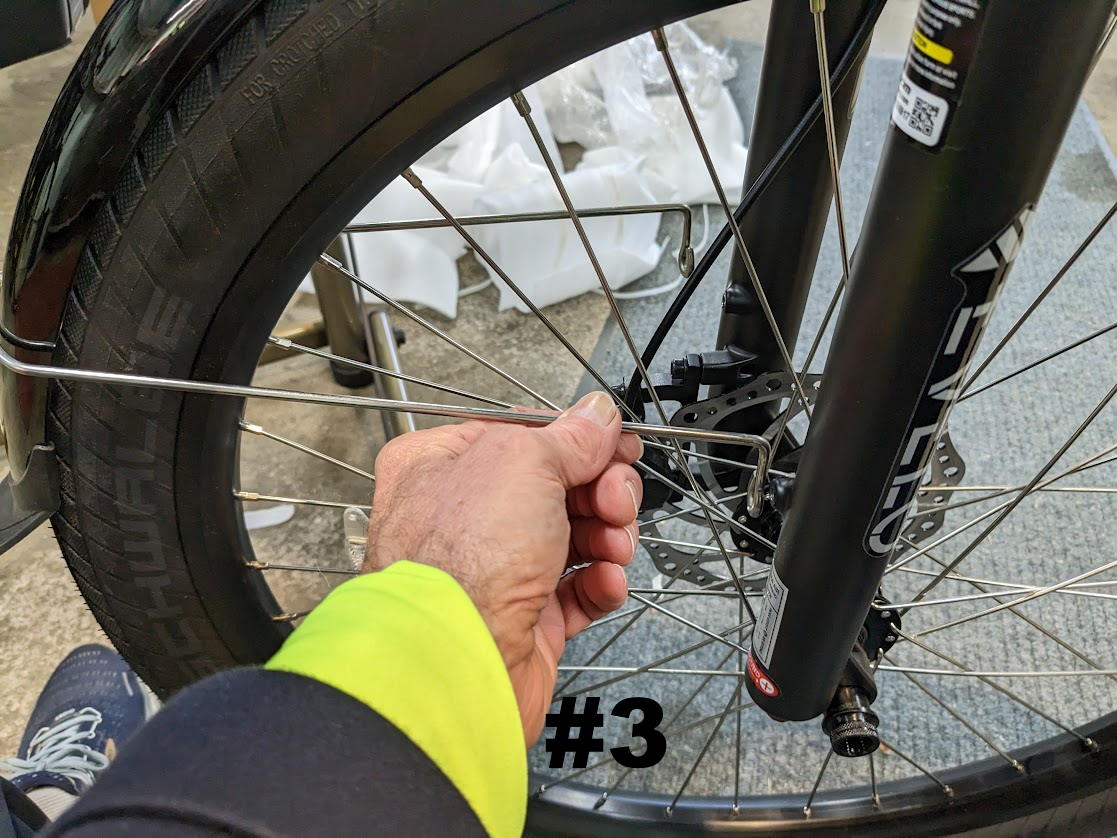

One of the issues I have with the ebike is the length of the front lower fender support is too short. I tried re-angling the arm with the attachment loop to lengthen the support but I ended up having to add a longer bolt to accommodate 3 flat washers and a nut as shims. Here's the communication with Evelo's Support Team:
ME: "I’ve included some photos of the fender stays on the front wheel. Did I install these incorrectly or is there some other problem? The stays are too short to reach the mounting points on the fork. The stay was installed with the looped end facing UP. I noticed in the assembly information that they are pictured facing DOWN (photo #1).
I reversed them and they still did not reach the attachment points. You can see that the fender is smack against the tire (photo #2)!
With the fender positioned properly for tire clearance, the stay loop is ± ½” short (photos #3 and #4). I bent the stay to try and meet the fork but it was still too short. I added 3 washers and a nut as shims to complete the connection (photo #5)."
EVELO: "I am happy to address your concerns and issues on your Atlas.
It certainly looks like your front fender stay is too short. I will ask the warranty department for a longer option and get back in touch with you."
That was on January 13, 2023. I haven't received an answer from the "...warranty department..." yet. (See attached photos)
