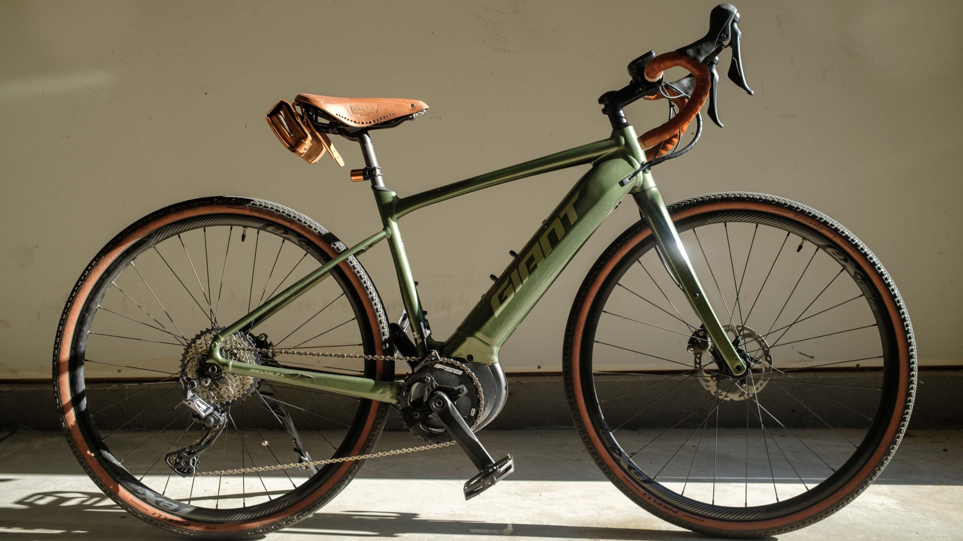

3000 miles in and loving every minute!
Just put on a new chain, Pirelli Cinturato 40s, Brooks saddle, bag, rear light and bar tape.

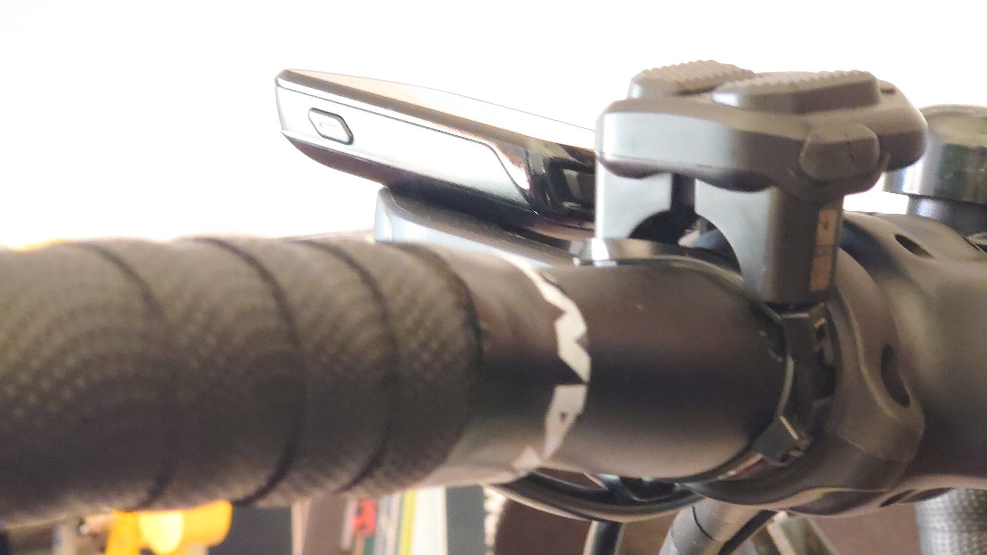

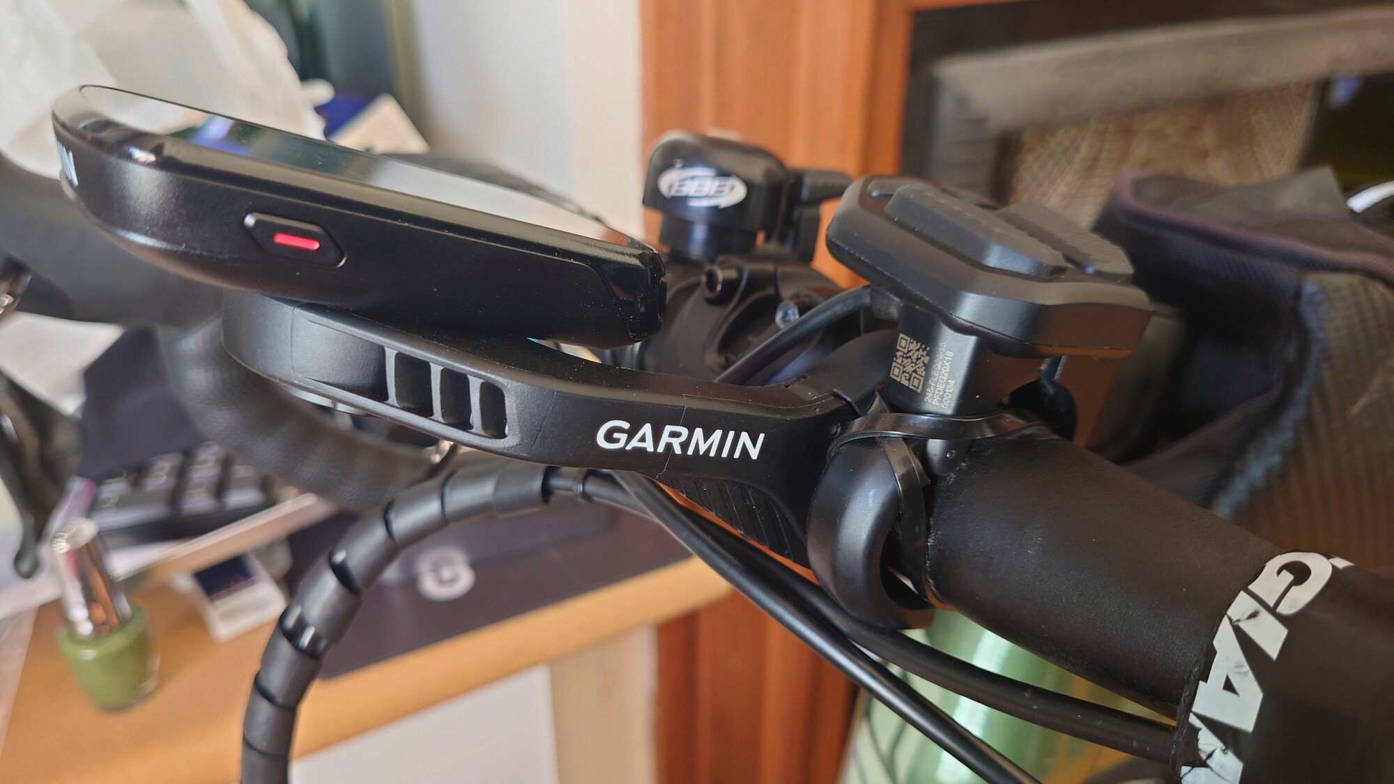

I've had this beast for almost a year now and love it. I want to thank @jabberwocky for the inspiration to clean up the bars. It makes me so much happier to get rid of that horrendous screen.
My LBS swapped in the new controller and with a couple of cable ties it is pretty much perfect!
In the past I had the motor cut out issues but they sorted that too. I must admit that I lust after the new red model but I'll stick with this for sometime yet.

Sweet! I like your ziptied mount for the MTB controller. I ended up putting mine further over on the bar and it was still a little difficult to clamp down. Definitely designed for flat bars. But yeah, if you're running a modern garmin theres no real reason to have the giant screen on the bars.
Any other changes? Aside from that swap and changing the bars to a pair of Ritchey Venturemax (stock were way too narrow) I haven't really done anything to mine. Still solid, no issues. Might grab a 500 battery this year (wish Giant offered an upgrade because I have two 375s).

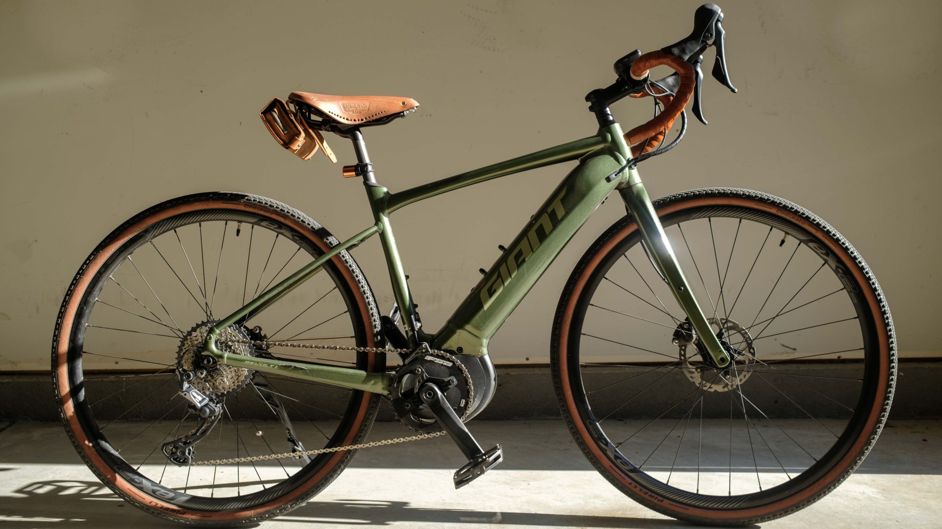

Hi, I am Frank, from Wilmington, Delaware [USA] and the proud owner of a Giant Revolt e+ Pro.
I am 76 years old with 35+ years of acoustic bike riding experience. With a few years off the bike, I ‘discovered’ ebikes and found the perfect fit with the Revolt.
I have added the TPK Explorer back rack and MTX Trunk bag. Also added are a GNT direct mount kick stand and Selle Italia Eyelink road bike mirror. I swapped the stock tires to Teravail Rampart tires [700x42] and am riding them tubeless.
I added my old Brooks leather saddle, SPD clipless peddles, my Knog flashing lights [white front, red on my helmet] and Giant Recon TL200 LED red flashing light on my TPK Explorer rear rack.
I only have 100+ miles on it, but we are becoming one – I love this bike.

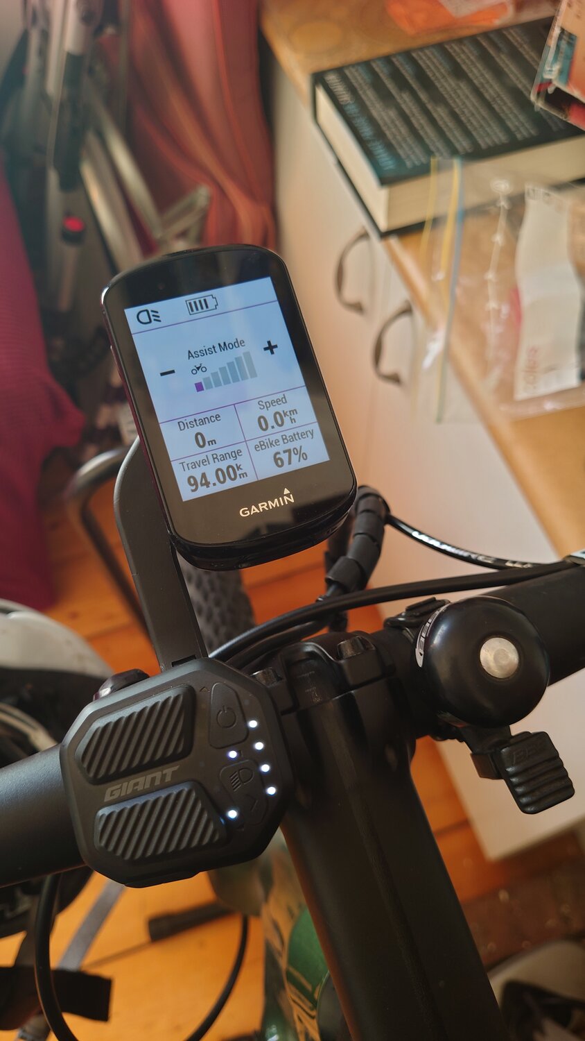

So, finally got my Energypak extender a few weeks ago, and then had to wait for the shop to update the firmware so I could actually use it (Giants app decided it hated my bike on every device I tried to connect with). First ride was today, and I figured I'd pass along a few thoughts in case anyone is looking at the Revolt (or other 2020 Giant) and was wondering how the extender works.
First, mounting and connecting it is pretty simple. Charges off the same charger, but has a different plug So now I have the charger, which has a plug that plugs into the charging port on the bike to charge the main battery. Or I can remove the battery and use an adapter to charge that. Or I can use a different adapter to charge the extender. I feel like they could have standardized those a bit, but what do I know. :p
As for how it works, it seems to talk to the computer, which displays a percentage based on the combined capacity of both batteries. It also seems to draw from both of them while riding, though not totally evenly (after my ride today, I was at 31% left. After unplugging the extender, that dropped to like 14%, so the controller favored drawing from the main battery). Not sure how it decides how much to pull from each one. The extender has a USB port on it if you want to use it as a giant mobile battery bank for whatever reason.
Also, you can't use the bike with just the extender on the bike. It throws an error. It seems to need a main battery plugged in before it will go.
