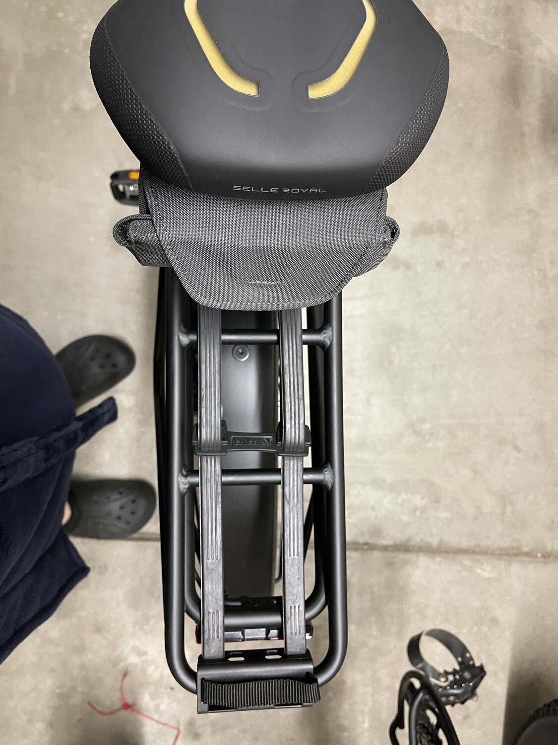

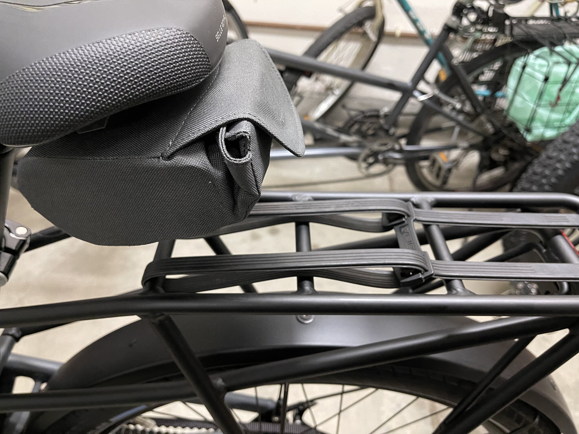

Thanks for replying @DiggyGun, here are a couple of photos - the MIK mount, I think, is comprised of the placement of those three bars, but as you can see, the front bar is actually under the seat. Every photo I can find online of an MIK bag has the rack far enough out that the mount is behind the seat, not several cm under the seat like this.
I have the seat post set pretty low as I’m not a tall guy - if my post was fully extended perhaps the seat would just go over the top of the bag. But as it is, even if I removed the lock bag, I don’t think any bag mounting to that front bar would fit.

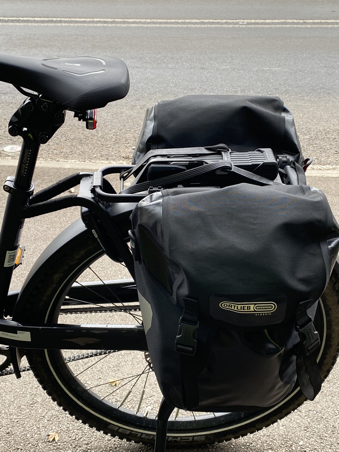

We use the Ortlieb panniers on both of our bikes and they are an excellent piece of kit.

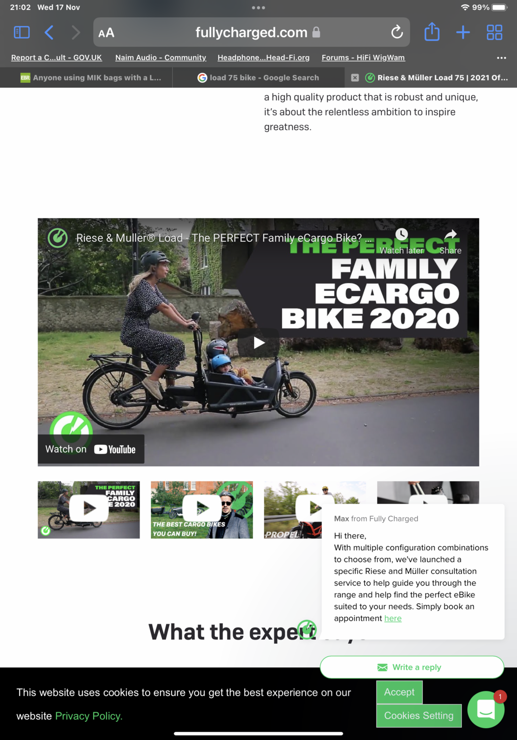

This is from the Fully Charged website and it shows that the front end of the rack is well under the seat. Strange set up…

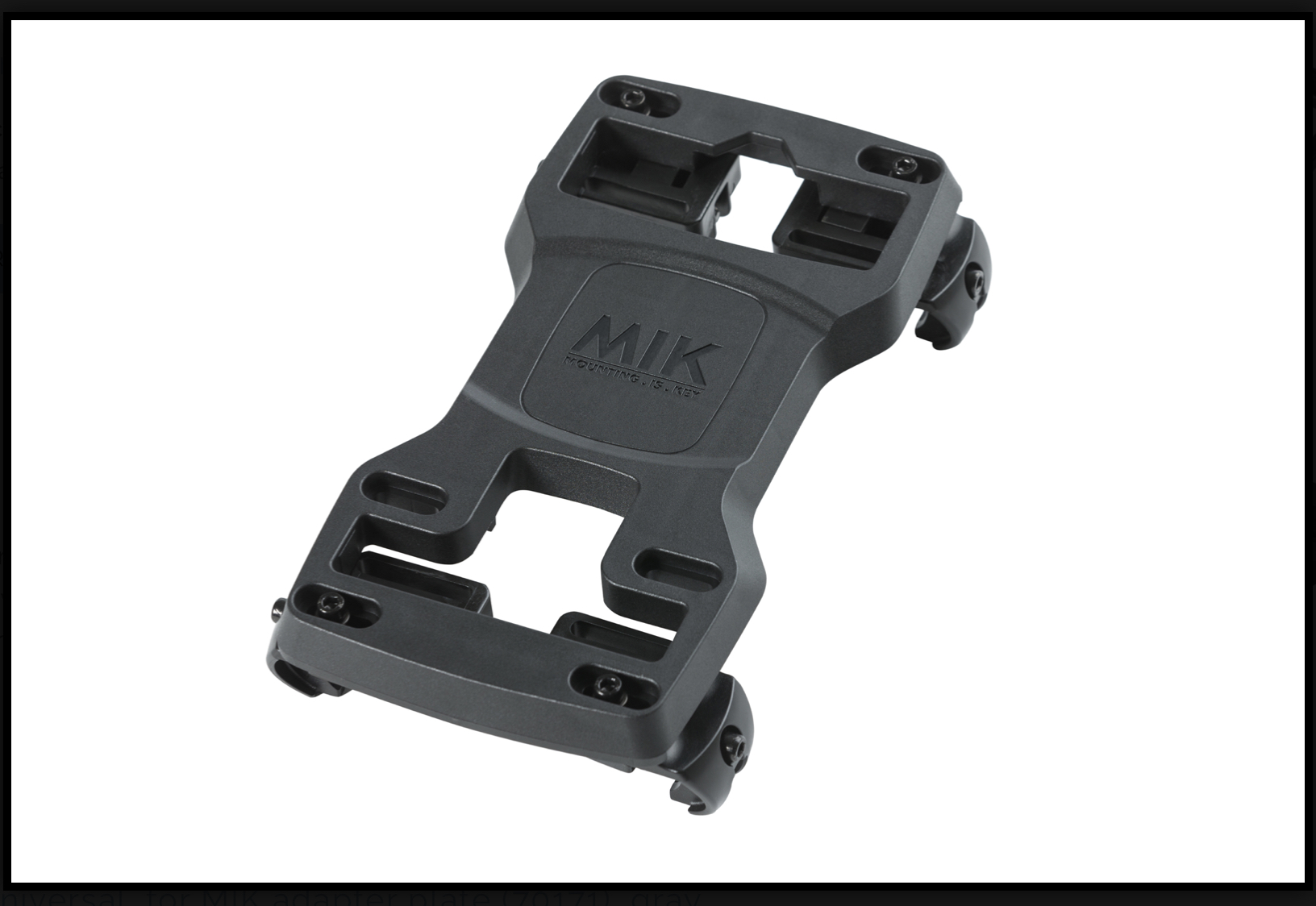

Hi. At the moment all you have is a basic rack. You still need the MIK adapter for your rack to attach MIK compatible bags to.
Thanks, and that’s odd, maybe this was my mistake - I thought R&M racks were MIK compatible without the adapter? (And I swear I also read someone’s review somewhere of an MIK bag going right onto their R&M rack with no adapter needed…)

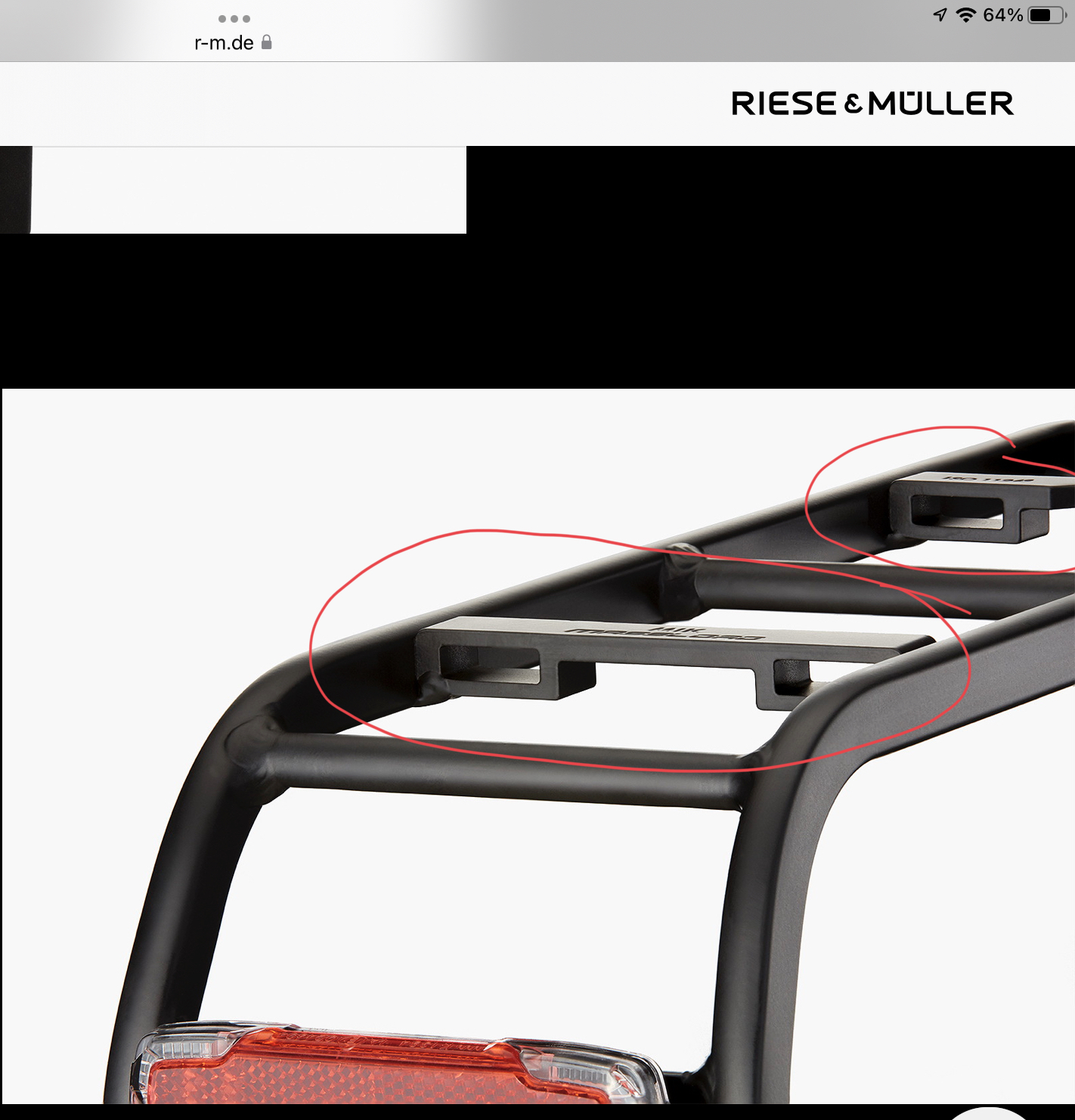

R&M bike specs are not clear on their site but it looks like the R&M Charger3 rack is MIK compatible. It has the MIK mounts built into the rack. See pics. My Giant Explore rack is like that too so no additional adapter needed. I don’t think the adapters are too expensive though. Just a pain to now have to get one if you want the MIK capability.
429D53FD-53FC-4911-8E56-9C290D57BFD9.jpeg B6316EBF-A590-4702-A876-7A0BDAFB85BE.jpeg
View attachment 107182 View attachment 107184

The Trunk bag has the adapter plate built into it so to answer your question yes.
You will need MIK compatible bags with built in plate or the adapter to put on your own bag. I added one to a milk crate and use it for larger items.
