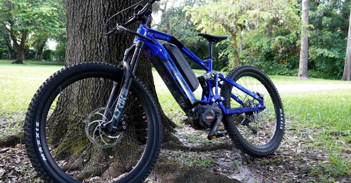

Thanks for posting the video review on Electrek... here is the link to the article and final specs.
FREY EX Pro eMTB tech specs:
  • Motor: 1 kW continuous, 1.5 kW peak-rated Bafang Ultra mid-drive motor
  • Torque: 160 Nm
  • Top speed (tested): 59 km/h (36 mph)
  • Battery: Dual 48V 14Ah packs (1,344 Wh total)
  • Range: Varies considerably by ride style/terrain, but 30-100 km (20-60 miles) is the ballpark
  • Frame: 6061 aluminum
  • Front suspension: Rochshox Lyrik RC Boost 110*15mm, 180mm travel
  • Rear Suspension: RockShox Deluxe 205x65mm, 160 mm travel
  • Transmission: Shimano Deore XT M8000
  • Brakes: Magura MT5-e hydraulic disc brakes with 203 mm rotors
  • Extras: 3 frame sizes (M, L, XL), color LCD display, side stand, Maxxis 27.5*2.8″ REKON+ TLR tires
