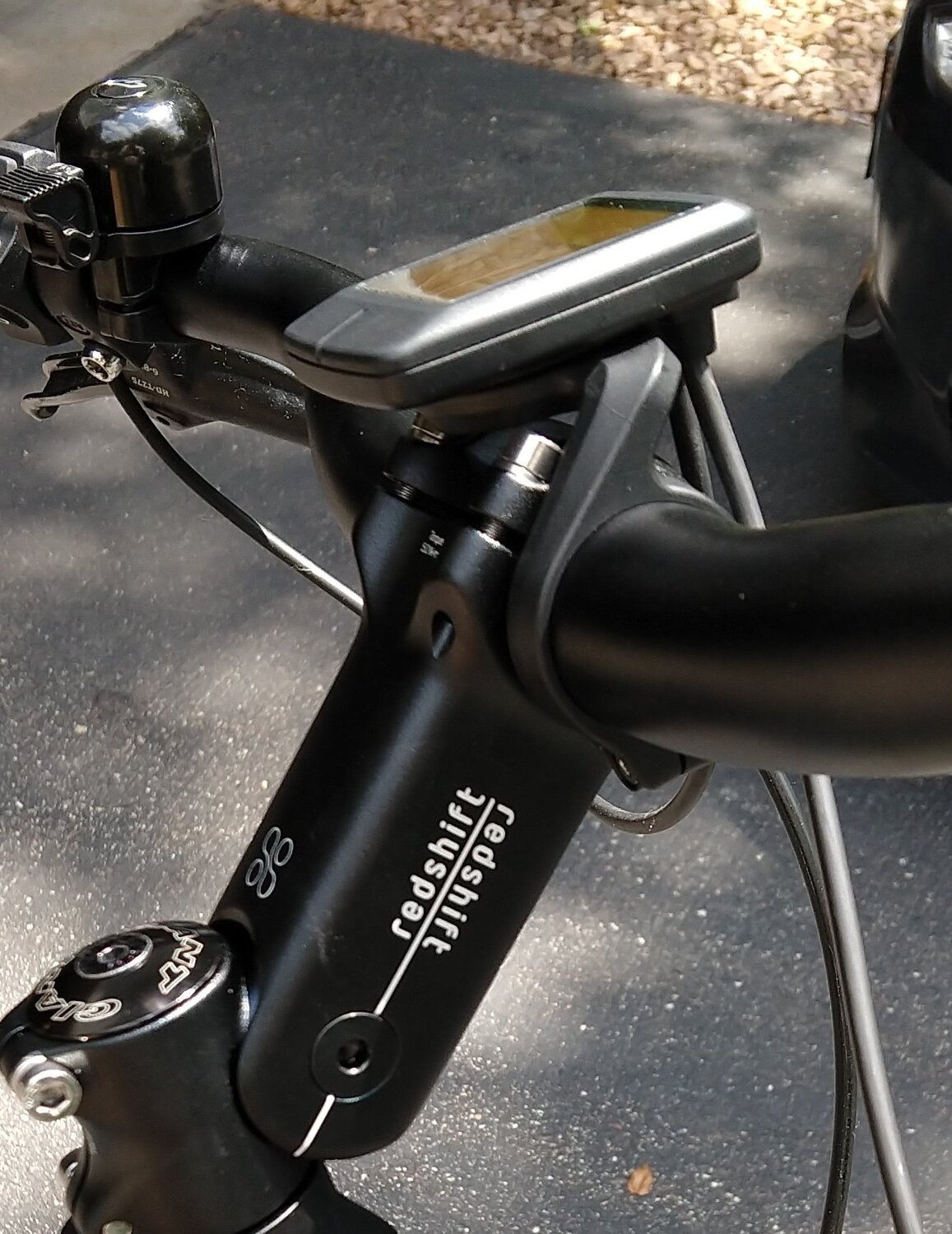

Hi Scott, I put a Redshift stem on my Como and it works great. Much simpler than swapping out the fork
View attachment 61988.
Tedd in the twin cities
How do you like the ride... is the rebound dampened?

I'm very pleased with the added comfort this stem has provided. I'm prone to wrist and shoulder soreness while riding and it has helped a lot with minimizing that. Adding Ergon gp2 grips have been a helpful upgrade as well.
I wouldn't say that the rebound is dampened but it certainly doesn't have any jarring snap back.
