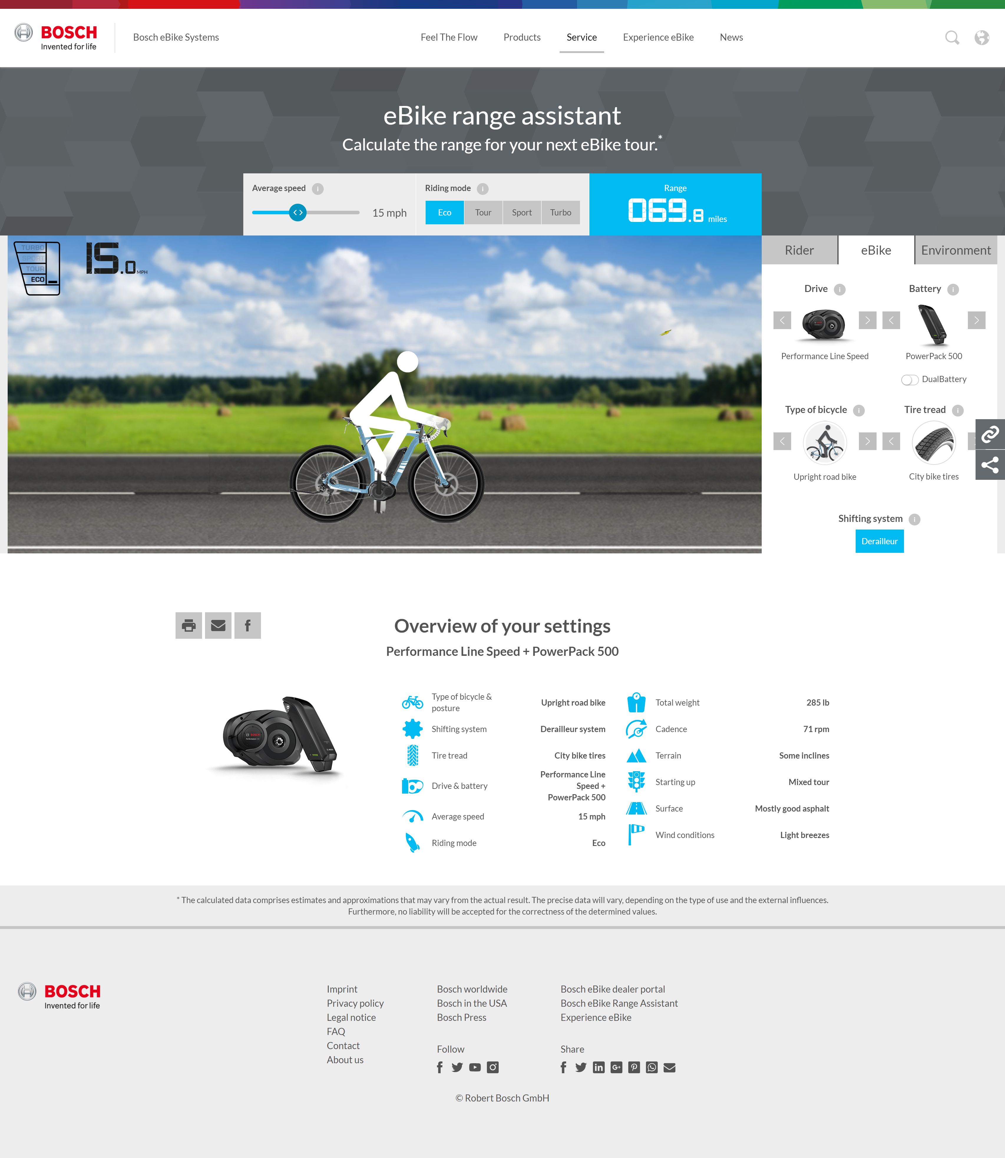

Perhaps, my fear level is exaggerated? This Bosch app estimates 53 miles, when I expected about half that amount. #57
Would you might trying the Bosch app to compare your actual results with the estimation?
https://www.bosch-ebike.com/us/service/range-assistant/
I appears that the Bosch estimate is on the conservative side as I am actually getting better distance than estimated.
With all the same parameters I get the following
Tour 45 miles
Sport 37 miles (no EMTB on a HS drive)
Turbo 33 miles
FireShot Pro Screen Capture #028 - 'eBike range calculator for Bosch drive systems – Bosch e...jpg
Keeping everything the same but adding 4mph to average speed (from 14 to 18) took 12 miles off the estimate.. Given your stated love of speed and fitness level, you might be able to offset much of this differential.
