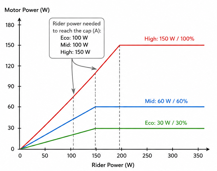

Had my BMC for a couple weeks and been playing around with motor settings. What seems to be working for my riding style and location follows. At these settings I can get +60miles of range with 3000-4000ft of climbing. Also suggest that TQ40 would be plenty for my type of riding. Curious to hear what others are using...
ModePower CapSupport %Pedal ResponseRationale
Eco30 W30%LowOffset bike weight/tire penalty while preserving analog feel and range
Mid60 W60%Low / Medium“10 years younger” mode
High150 W100%MediumShort-term boost for steep climbs, wind, or fatigue

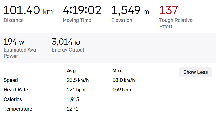

It really depends on the rider and too many other factors. Here's the stat page of a gravel rally organiser who rode a Raymon Norza Pro (a carbon Bosch SX gravel bike).
63 miles, 5,082 ft elevation gain, with some 14% grade climbs, an area consisting only of climbs and descents. He rode in a Tour+ assistance, which is 45 Nm max and 300 W motor mechanical assistance max. Tour+ is a dynamic mode, which automatically switches between ECO and TURBO as needed. His e-bike (rented for tests by Bosch E-Bike to him) had a 400 Wh battery, of which he used 94% for that ride. The man is a 40-yo able-bodied rider. Given the e-bike had an EU 25km/h restrictor, I assume he rode all descents and flats without any assistance.
E-bike weight 32.4 lb.

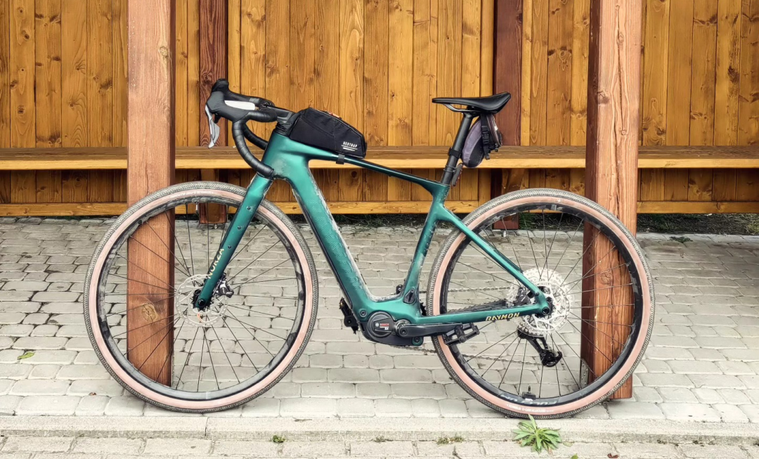

Pinarello Nytro E Allroad, 32 pounds, HPR50. I'm still tuning.
Eco: 120w/71%
Mid: 200w/111%
High: 300w/200%
I ride about 40% Off, 60% Eco, with an occasional bump to Mid. I have never used High except for experimentation. As I get fitter, I expect to drop the Eco assist below 100.

I am new to this but from my observations so far it appears TQ motor power is somewhat linear until the max motor watts are hit for each mode. Rider power is the input variable while riding.
Pm = min(A, B·Pr)
where:
  • A = max motor power cap
  • B = support %
  • Pr = rider power
  • Pm = motor power
That said, I suspect more happening behind the scenes than this simplified steady-state model — cadence, motor RPM, transient response, smoothing, efficiency curves, thermal limits, etc. The following illustrates the relationship for 3 settings.

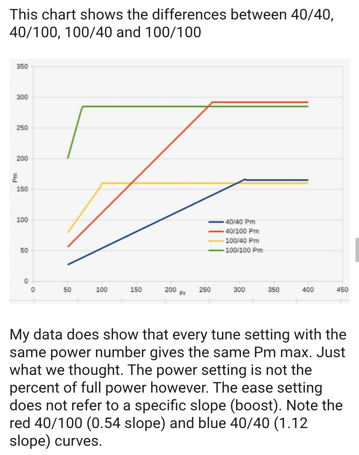

Makes sense. However, the relationship between how hard a rider pedals, how much the motor assists, and the maximum assist power is a fundamental equation in all e-bikes, no matter how it is measured.
I'd like to see the data behind that statement.
If you plot empirical mechanical motor power Pm vs. rider power Pr on a Specialized Vado SL 2 mid-drive, you get a ramp and flat geometry with a ramp of constant slope. You see this consistently in the excellent field work by @mcdenny in steady-state riding.
This screenshot shows representative SL 2 data from the post linked above. Official Specialized documents imply that all of its mid-drives have this Pm-Pr plot geometry.
And @apctjb above has reason to believe that his TQ's Pm-Pr plot has this geometry as well, though we haven't seen his data.
I'm prepared to believe that this Pm-Pr plot geometry is a common in mid-drives. But not prepared to say that it's universal.
Complicating all this is the reality that we have no idea how manufacturers who use these ramp-flat relationships choose their actual ramp slopes and flat heights.
For example, there's no simple relationship between Specialized's slope and height choices and the E/M settings @mcdenny tested on his SL 2. His data shows a clear cadence dependence in the ramp slope that we have yet to understand.
No recorded data, just observation of power while riding which is imprecise at best. That said it appears to be a somewhat linear relationship between rider power and motor power until max motor power setting is reached.

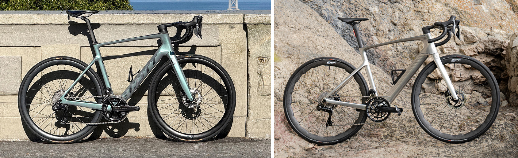

i test rode a fastlane today. very tempting !!! here's a summary of my quandary on the pros and cons of this bike and my current e-road bike.
now i have a major dilemna!
i still have my s-works aethos, which fits me like a glove and rides like air, but i can't ride it on any interesting rides any more due to the absolute need to keep my HR <110 and average 90-95. OK for flats, not for hills. so i mostly ride my scott addict eRide, which is a nice bike, but not perfect. today i test rode the newish scott fastlane, and man, it is nice. here are the pros and cons. help me decide!
addict eRide Pros
  • i already have it. it's set up nicely.
  • it's a hub drive, so it uses a totally standard crank and i have a matching pair of 12 speed dura ace cranks with matching 4iiii dual sided power meters. obviously i use the same HRM, same head unit (phone), so i can jump back and forth between the aethos and this one with completely comparable metrics/stats, and i really like the 4iiii units
  • it really looks just like a road bike. the bottom bracket area is totally standard, standard cranks, small downtube, close inspection reveals that the rear hub is bigger than you'd expect but still much smaller than the cassette
addict eRide Cons
  • the electronics are getting fritzy, and it's out of warranty. about one in every 10 or so motor engagements (i ride motor off until it gets steep enough to need it, then turn it on) the motor doesn't come on, it flashes red, then turns off after a few tries it works.
  • the bottom bracket creaks and pings in a very annoying way sometimes
  • the motor is not silent. not horrible, but i can hear it, it harshes my smooth buzz and flow, and i'm sure other riders can hear it too
  • it's a hub drive, so it's not super efficient going up very steep hills, where the wheel (and thus motor) speed drops
  • the control to change modes is on the top tube, not the best, especially when it's not working right
scott fastlane pros
  • slightly lighter - 22lb vs 24lb.
  • the motor is damn near silent. i rode it at full power at 25mph on a flat and at 10mph up a 10% hill, and while it didn't sound quite like a normal bike, there was nothing you'd identify as "that's a motor" sound
  • since it's a mid-drive, motor speed matches rider cadence and it's able to deliver full power going up a hill slowly, if needed. within reason. it's a low power bike (200w max) but that's perfect, i never need that kind of assist. more like 100.
  • presumably it would work perfectly and be under warranty AND NEW BIKE DAY
  • the drive unit is integrated into the di2 buttons on the hoods, so nice
  • there's no top tube display or control, it's got some tiny lights in the bar ends. super tight and clean.
  • this doesn't really matter but it's a class 3 bike, addict is class 1 so if i wanted to really haul ass (on a commute type ride maybe) there's assist between 20 and 28mph.
scott fastlane cons
  • biggest con : since it's a mid drive, it doesn't use standard cranks. the 2x front ring and cranks are not shimano standard, and there are no power meter arms available. power is really important to me, so i'd have to switch to power pedals, and i ride speedplay. their power pedals are OK but not amazing.
  • i don't love the color that the dura ace model comes with - it's a glossy, metallic silver, pretty color but too bling for me
  • the mid drive drive unit is very small, but not so small that the bottom bracket doesn't look a bit e-bike. it's very sculpted and has a cut-off profile on the non drive side. the addict eRide is stealthier and more beautiful, IMO
  • the zipp 353 NSW wheels have that crazy scalloped pattern, which seems to generate a sort of harmonic "whoosh" sound when riding... they're very high end wheels but i don't love the look. the shop said they'd swap them for something i like with a 1k credit, so not a huge deal
  • $10k plus outlay, then the hassle of getting my addict completely fixed and sold. this is definitely NOT an N+1 situation
it's a tough call! one approach is perhaps to get whatever gremlins the addict eRide has worked out, and then decide, since i'd have to do that anyway to sell it.

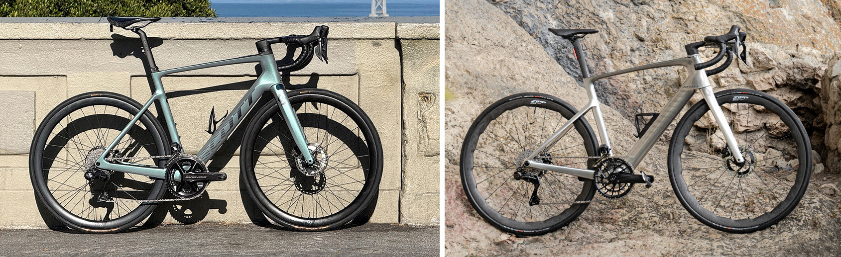

addict eRide Pros
addict eRide Cons
scott fastlane pros
scott fastlane cons
