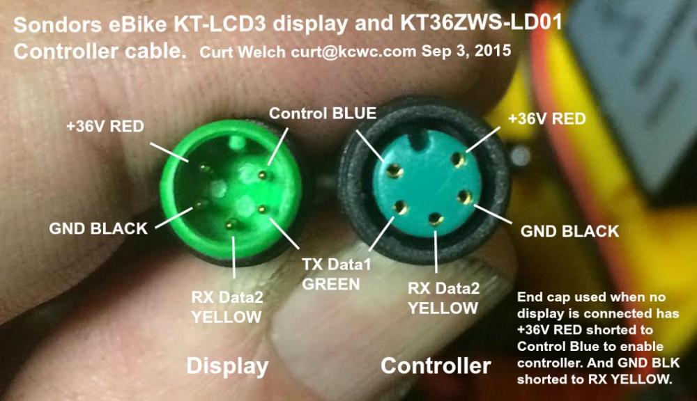

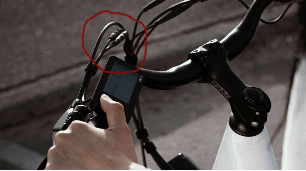

Here's a picture of a KBO. The display, throttle. and brakes should have round connectors. You can open the connector from the display. Then you can access the battery voltage.
I had to edit this post because I posted a picture of the wrong display connector. This is what my KT displays use. I checked my cable, and it agrees with what Curt Welch put here. Power can be checked on the right hand side. This pic is for a 36V bike, but it will work for a 48V bike too. providing it uses the same connector.
Take care when measuring. Do not short circuit any wires.
