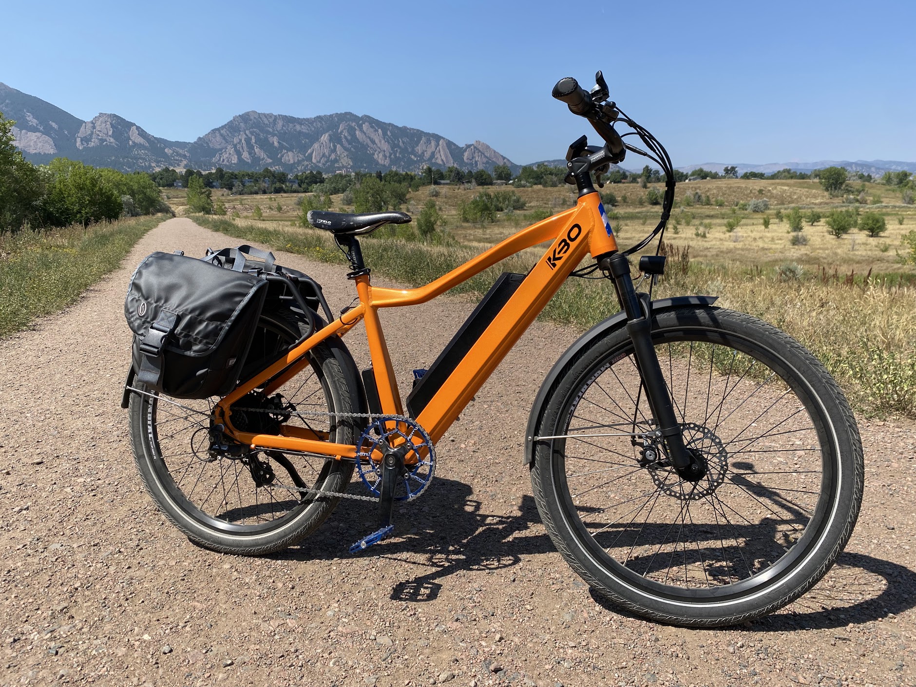

I received the Breeze a couple of weeks ago and have generally enjoyed my experiences so far. I mostly use the bike to commute to work 10 miles one-way on a combination of bike trails and public roadways here in Boulder, CO. I've put a little over 200 miles on the bike in that time and here are my experiences.
The bike was very easy to assemble and fits me well- I'm about 5'8" and it works well for me. The components are pretty good, running gear and brakes are similar to KBO's competitors- Shimano and 180mm Tektro respectively. The inclusion of aluminum fenders and a good rear rack were part of what helped me to decide to go with the KBO, in addition to the higher capacity of the battery (16 Ah) as compared to competitors. It's been reliable and capable from my experiences. So far so good.

I've made a few changes and ridden ~700 miles since this initial review. Overall, I'm still pretty happy with the purchase, with some caveats.
-The controller tuneability still remains a sticking point for me. It is much less functional than at least two of the most adjacent competitors, R1U 500 and Radpower Radcity. I simply cannot access many of the parameters on the KBO that both R1U and Radcity have easily accessible by default, and the KBO has no available "Advanced" menu set in the controller. For example, I can't change overrun time (the time power is applied after loss of signal from the PAS system), tuning individual power levels for the different assist levels, wheel size, top speed in the KBO- I can for both the R1U and the Radcity either through the default menu or through an advanced menu. This is the primary reason I'd rank KBO 3rd.
-I changed the chainring from 46t to 52t for a much improved match between pedaling cadence and PAS assist. I was almost always in 7th gear and spinning while on city streets, now I actually use the lower gears. This should have come this way from the factory.
-After sufficient complaining to the factory about the controller issue I explain above, they sent me a video showing me how to unlock the top speed limitation, allowing me to go from 22 mph to 28 mph. This is also something that should have been changeable from the factory. They let me know that this would void the warranty, but after I found out that if I had a warranty claim, that I would need to completely re-package the bike in the original box just like it left the warehouse, I was less concerned with even trying to ask for a warranty replacement on anything. I can fix or replace most anything that will likely fail myself for less cost than packaging and shipping a bike.
-The radcity uses a direct drive motor, while the KBO and the R1U use a geared hub motor. This means that while the Radcity has about 1/2 the torque of the other two, the torque delivery is much smoother and quieter. Nothing that most don't already know, but it is noticeable when going from one bike to the other.
-I doubt that the 3 extra amp hours will affect me until the battery starts to lose capacity due to age. My commute to work is 20 miles round trip, I use less than 1 bar of battery capacity for the entire ride. I don't see a real life scenario where the difference in battery capacity would make me regret one over the other.
-The included rack and better lighting setup (tail/brake light included) on the KBO is the best of the three for sure.
KBO is definitely the best looking of the three though!
