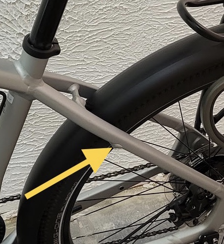

One thing to note with the frame lock (I looked into that to have in addition to the U-Lock, but opted with a folding lock as my 2nd) in case you aren't aware, is that there aren't bosses on the Allant frame where the frame lock mounts. Abus has an official solution for that situation, but I saw a review from someone who said that a pair of zip ties actually worked better to hold it in place (and save $10).
Maybe I’m misunderstanding you but I believe that these bosses are for frame locks.

Maybe I’m misunderstanding you but I believe that these bosses are for frame locks.View attachment 90542
Well I'll be damned - neither the Trek person in the store nor I noticed those. I was looking for bosses on the top/side like my last bike had and how I had seen most frame locks mounted, but I did just google image search and there are definitely frame locks that mount that way as well. I even asked the sales person how the frame lock would mount and he said that he had no idea (Trek employees' lack of knowledge of this bike is for another post). Thanks for pointing that out!
I asked the question of what they were for on this forum in the first month or so of owning my Allant+7 last year. Glad to help.👍

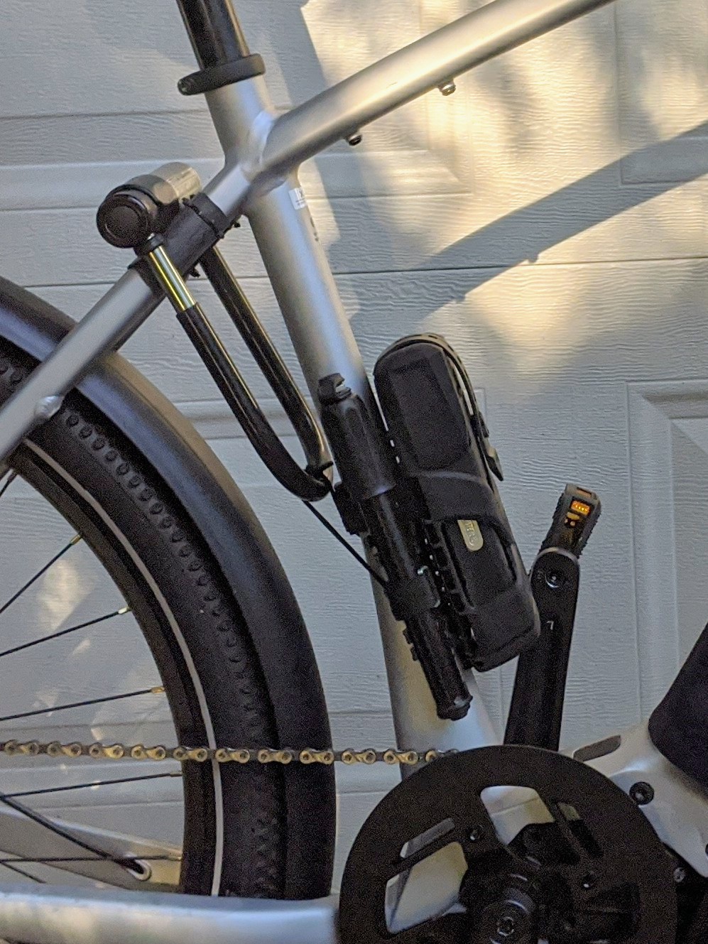

I struggled with this too. Here's what I came up with:
I zip-tied a couple strips cut out of old tubes to protect the frame at the seat stays. Then I added a short length of small-diameter bungee looped through the bottle-mount braze-ons. This bungee is then looped through the u-lock and keeps the lock from bouncing around (it keeps it really stable in place). It is quick and easy to remove and remount and because it is so stable it doesn't make any noise riding over bumps.
Yes, I also use a folding lock in addition to a u-lock. This bike was not cheap! I figure it takes multiple tools to cut through two different types of locks and hope a potential thief will consider another easier target instead! It takes about 30 seconds longer to lock up with two locks, but not a big deal.
