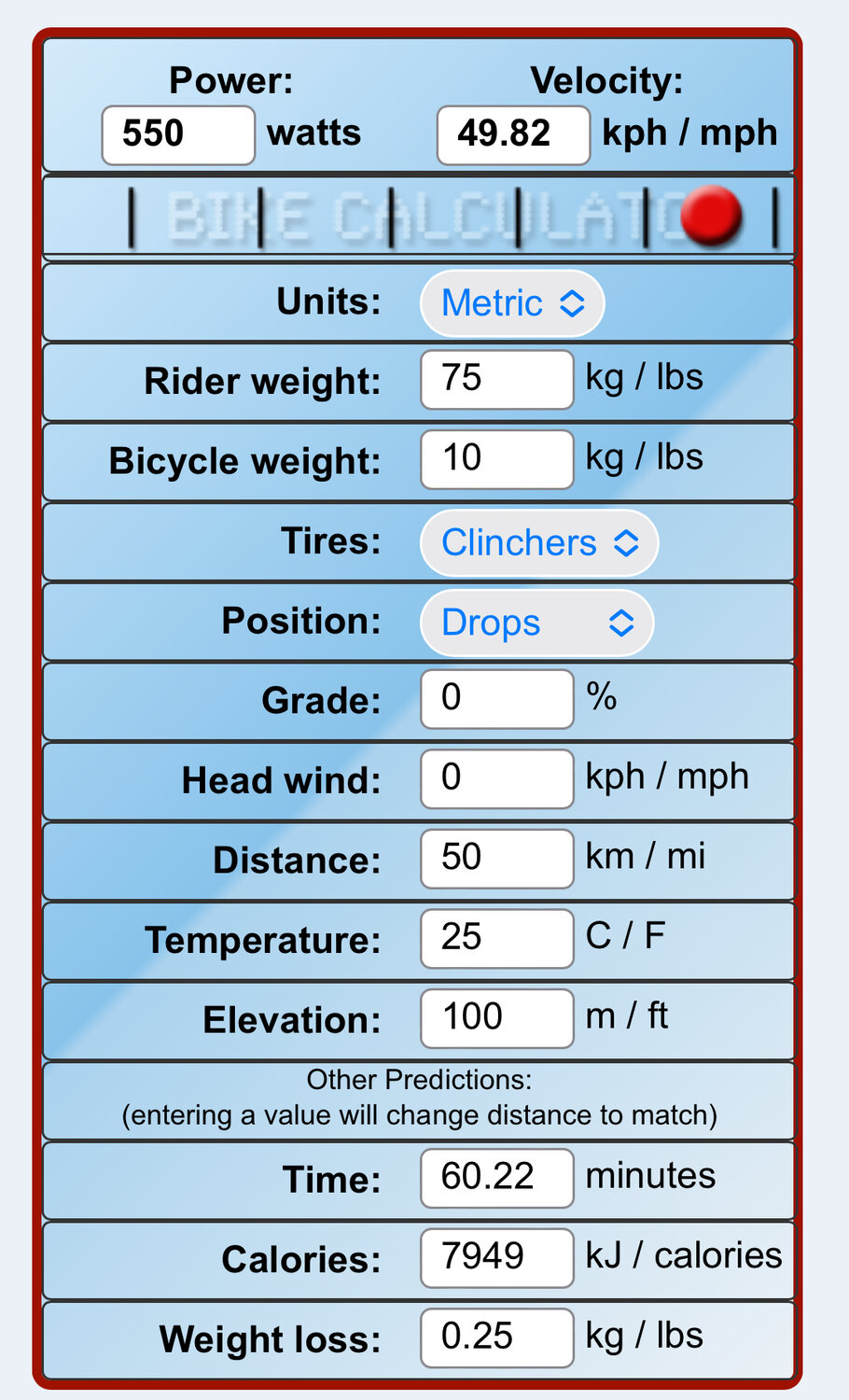

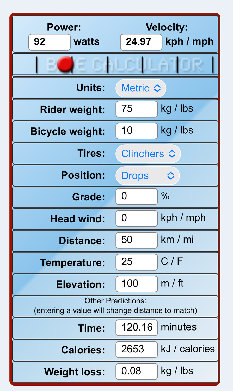

I can see some error in this reasoning. The energy spent would be indeed lower if you rode a given distance twice as fast but that would not cancel the third power term for the power demand.
I'd like to see some numbers to prove the energy spent on a very fast ride is closer to the square term.
going twice as fast takes half the time! use bikecalculator to see a more nuanced expression of it, you’ll see that it shows around 6x the instantaneous power to travel at 50 than 25kph (since not all resistance comes from wind), which means it’s only 3x the total work done to go 50km. 550w for an hour vs 92w for two hours. a bit less than the third power for instantaneous, a bit less than the square for total. as speeds increase it’ll get closer to the square and third power.
