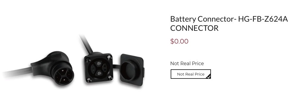

Greetings to all - looking for some info and advice on adding a 2nd battery to my Evelo Omega. Evelo makes an add-on rear rack upgrade unit "Super Range System" with 48V 15aH battery included - but it's been out of stock every time I go to look to purchase. And, being the frugal type and DIY'er, I am not wanting to pay their hefty price for the upgrade: $799 +tax. I am finding what appear to be good Li-Ion batteries for about $250 and I have a rack I can install to attach the battery to. So, today I began to research how I might accomplish this myself. The Omega comes prewired for this upgrade/2nd battery - it has a socket to plug the aux battery into at the rear of the bike:
The confusion I have is this: is that socket non-standard/proprietary to Evelo? I've seen quite a few aftermarket batteries today and all the connectivity plugs are square or rectangular - and certainly will not plug into this round socket. Although I do have the knowledge and skill to modify the connectivity, I really don't wish to cut wires on this really expensive bike unless I have to.

That OEM plug looks real close to this one:
This plug is a twist lock, so it can't come undone.
There is another that is real close, with just a slight change of the internal angles dividers.
Check that site to see the differences etc.
What are the battery connection points look like,
Hailong 4 or 5 lug pins?
I would also carefully check the bike side of this plug to confirm the Red/Black sides and any other wiring in that plug. Hth
Nvreloader (is that NV as in Nevada?) - thanks for the response. I agree that what you linked me to is close to the Evelo plug but not the same. I went to that site and was able to locate what I think is the match:
Pretty sure that is it. Not sure I'll be able to purchase from that site - clearly a Chinese corporation and it's not clear if they sell a single piece or they are a bulk seller - I've sent an inquiry email to them.
The battery connection points you asked about - here's a pic:
Not sure what that plug is called - it seems to have 4 small and 2 large pins.
Agree that it will be wise to closely check where black and red attach to the plug to prevent miswiring.
Thanks again for the response and feedback.

Yes it is, it used to be my CB handle back in the 60's,
Glad I could help you, as for your battery OEM plug,
I have never seen one with 6 flat lugs in that configuration,
and I am willing to bet Dollars to Donuts, that is a non-standard/proprietary for Evelo only.
All you'll have to do is match whatever the battery connections port is to the extended plug you are buying.
If it were me, I would be checking on both ends of this plug/battery to make sure there is NO other wiring connected to the plug/battery.
Being proprietary to Evelo, they may have sensor wiring for the battery hookup?
When I made my extension cable for my Juggs 4 bike (so I could use any of the 4 Wart Hog battery's), all I had to do was get the Hailong plugs to match each end, and I used the OEM detachable battery plate for the connection point etc.

Well, to my surprise I *think* I am getting 2 of these plugs shipped to me from a Chinese company called "ETOP". Panmtrade was a no go, they would not consider any order less than 100 pieces. I politely discussed what I was trying to do with a very nice sales rep from ETOP and they eventually agreed to send me two plugs as "Samples".....these sample ended up costing me $83 when shipping was calculated.
