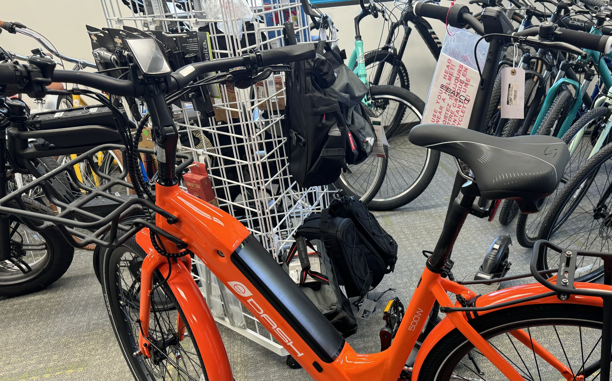

I finally found a bike that felt just right on a recent test ride, quickly comparing the geometry to the Zen Photon when I got home. The reach was less than a half inch difference, but the handlebars seemed to be higher relative to the seat height compared to all the other bikes I test rode. I noticed when comparing the head tube length, the bike that fit was over 3” longer, 8 7/8” vs Photon’s 5.5”. If the head tube angle was the same on both, would that mean an extra 3” of handlebar height? The other bike had no head tube angle spec, unfortunately.

The reach on the good fitting Serfa with the 15 degree back sweep handlebar is almost identical to the Photon reach, making me think the Photon 38 degree sweep is not going to work at all.

That’s interesting as my concern is that the Photon bar may be too low based on my comparison to the Serfa that seemed to fit just right. The Serfa that fit so well has a 3” plus longer head tube than the Photon, but maybe I’m not understanding that spec and it does not actually mean the handlebar is 3” higher on the Serfa. When I rode the Serfa it felt right and instantly noticed there was no pressure on my wrists, a problem on some other bikes I tried.

I was thinking about your “handlebars 5-6 inches above my saddle height” comment. Wish I had measured those distances on that Serfa that felt right, but didn’t think of it at the time. I did take a photo of it at the dealer after test riding, and looks like the distance difference is in that 5-6 ballpark:
I just measured my Photon and right at about 6” difference with no adjustments. The fit right out of the gate is just about perfect for me.
