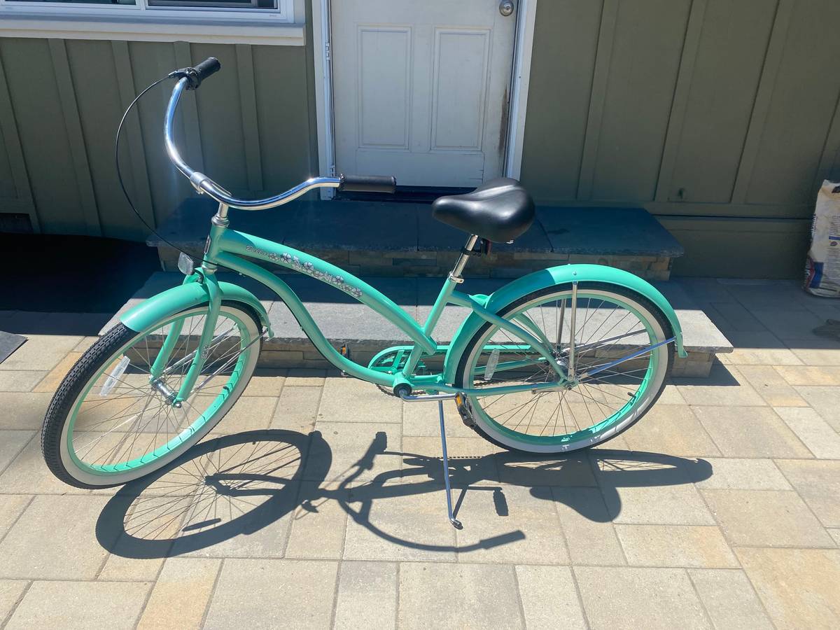

I just spotted this example of a comfortable easygoing bike in the next town. It is in new condition and is $275. It is a three speed with a coaster brake. I make electric coaster brake bikes mostly for people with hand issues. I like them because they are fun. And you don't have a bunch of cables and wires. I would route internally on this bike and maybe paint the battery to match or do a Miami color to contrast, like terracotta peach. The clunky and heavy American forged crank set and the solid steel chainring would be tossed. I would keep the chainguard. In looking again, I like that top tube for internal routing. I needs a cup holder. It says Summer.

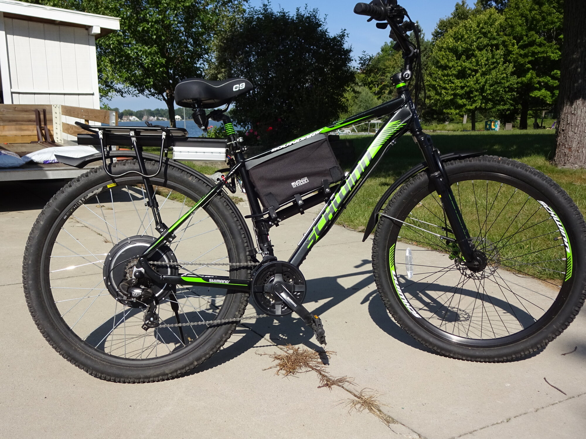

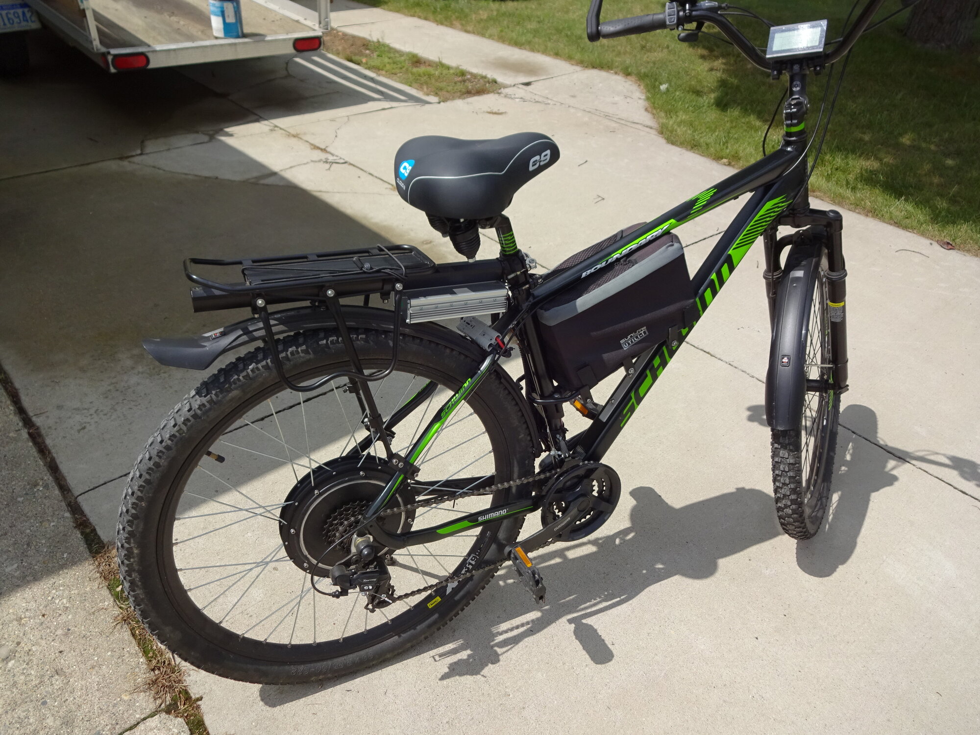

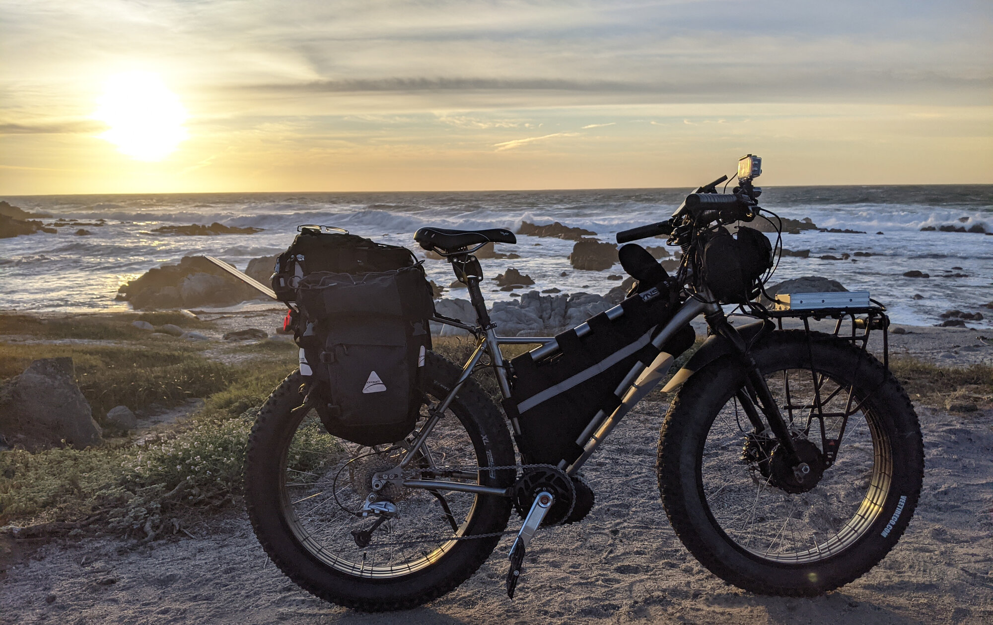

This is the bike I dropped and fell on. Picture taken after my little lesson/learning how bad the plan to mount the battery on the rear rack really was, FIRST HAND. Pic shows the final location of battery. When the battery you see in this pic was mounted on that rack, and the bike was pulled over far enough for me to swing a leg over the battery and seat, the weight of the battery would lever through the frame of the bike, with enough weight to literally lift the front wheel off the ground.
At this point, I could care less what you (or anyone else) believe or have to say on the topic. If you can't muster the respect to accept that what I said happened really did, you can kiss my (use your imagination here). And no further BS on the topic regarding this bike necessary. Lessons learned here. 2 of them. One bike related, one not.....

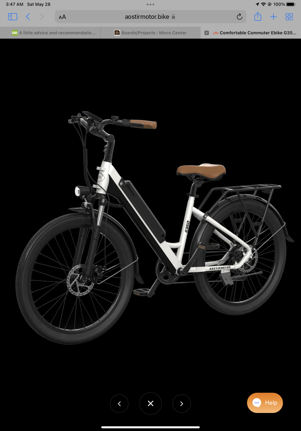

Well I had a nice "Bay Pointe" located( cheap GC) it was sold before I could get there,I think the next time I want to build I will just look at the discount priced bikes,I am sticking an "Aostirmotor" together right now, it was heavily discounted,it has some really nice features I was not expecting( the "Touteg" is a horror, plenty of power about all I can say I want to test it off the beaten path)
On another thread 'Coaly Rollers' we were just joking that the Overstock.com's marketing team is from 1958 or is Russian because the cheaper the bike the less clothing on the models! Anyone who did that around here would be fired in three seconds. Anyway they have a ton of cheep bikes. The BB and crank will go anyway. Then you can upgrade the shifter to a $12 microshift and get a $22 nicer cluster and $15 better brakes. After the first set of tires you can upgrade those. Components can be gradually swapped out so, each month the bike will be a better bike. They have a bunch in the $200-$300 range. Step throughs too.
@kmccune This one? The G350?

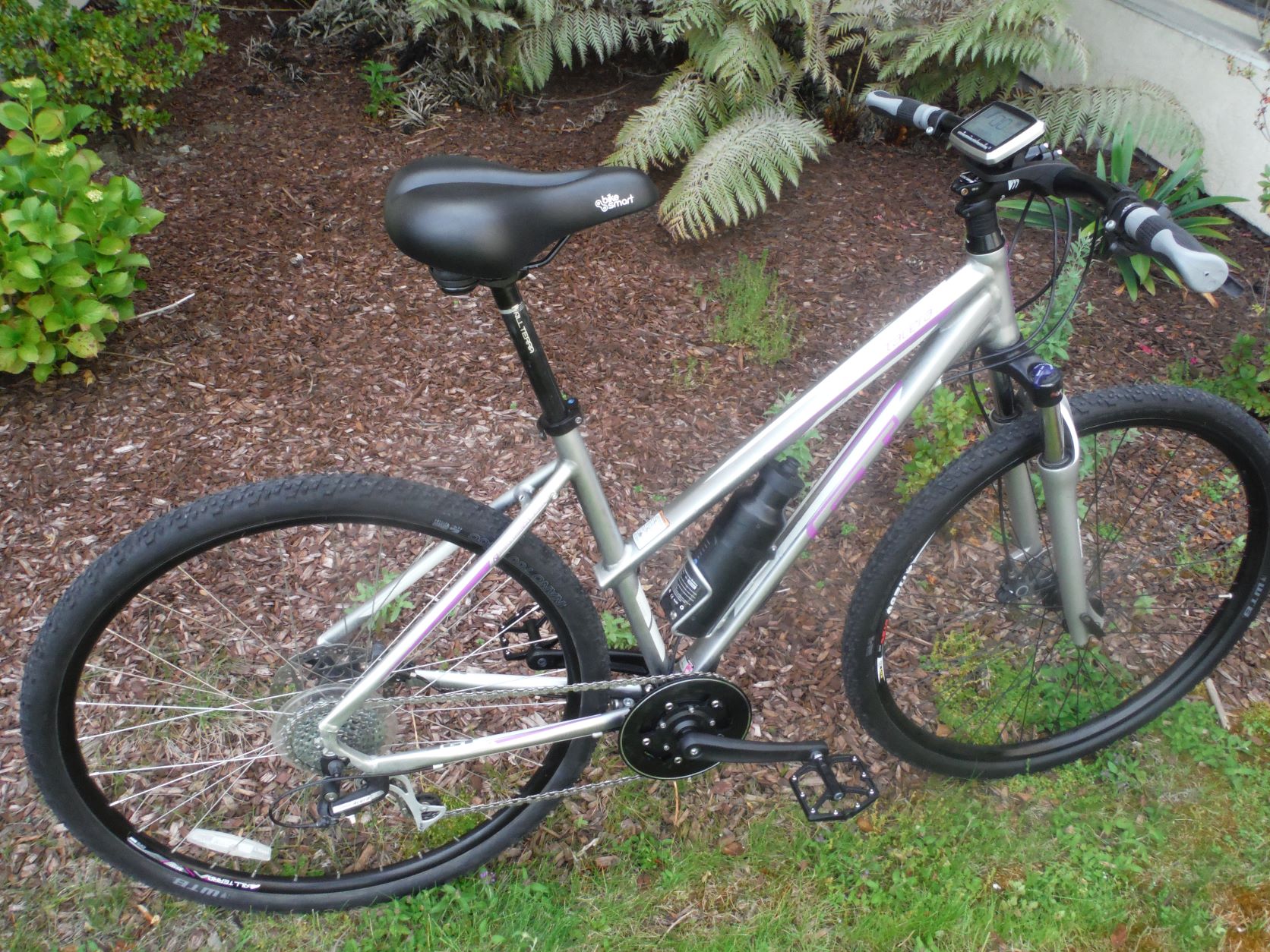

I just made this step through. It was a $200 bike. On the test run it was perky and fast. I like the hydro discs with the updated touch points and gravel tires.
