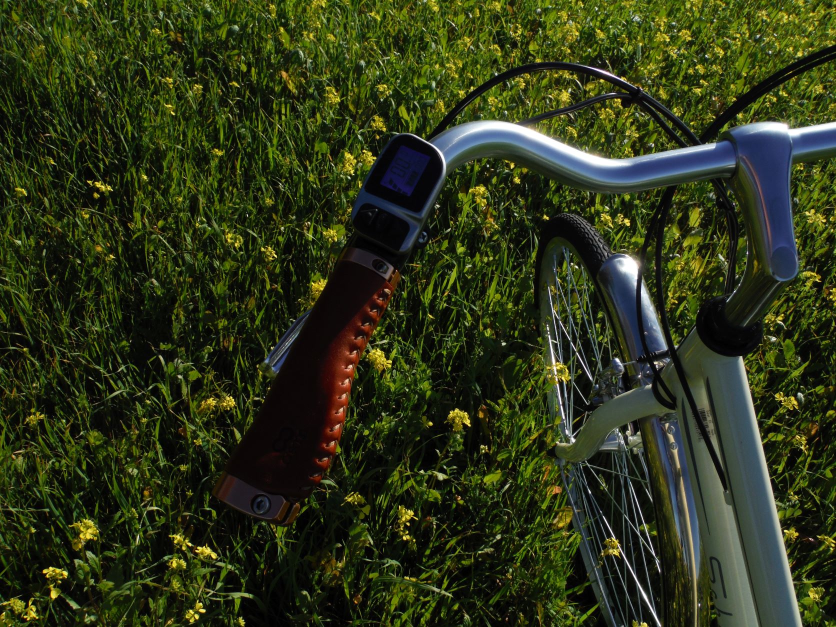

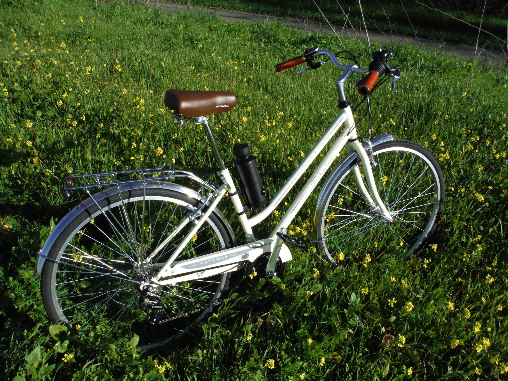

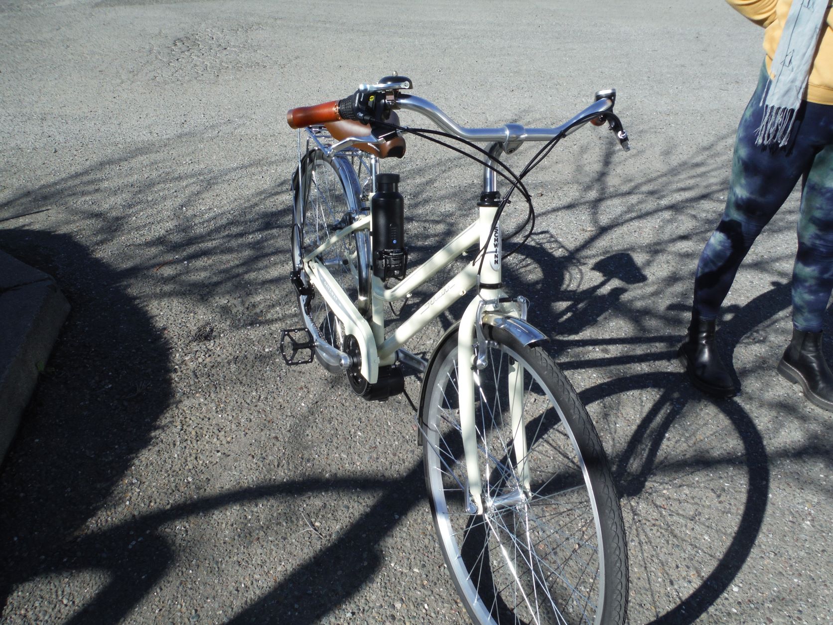

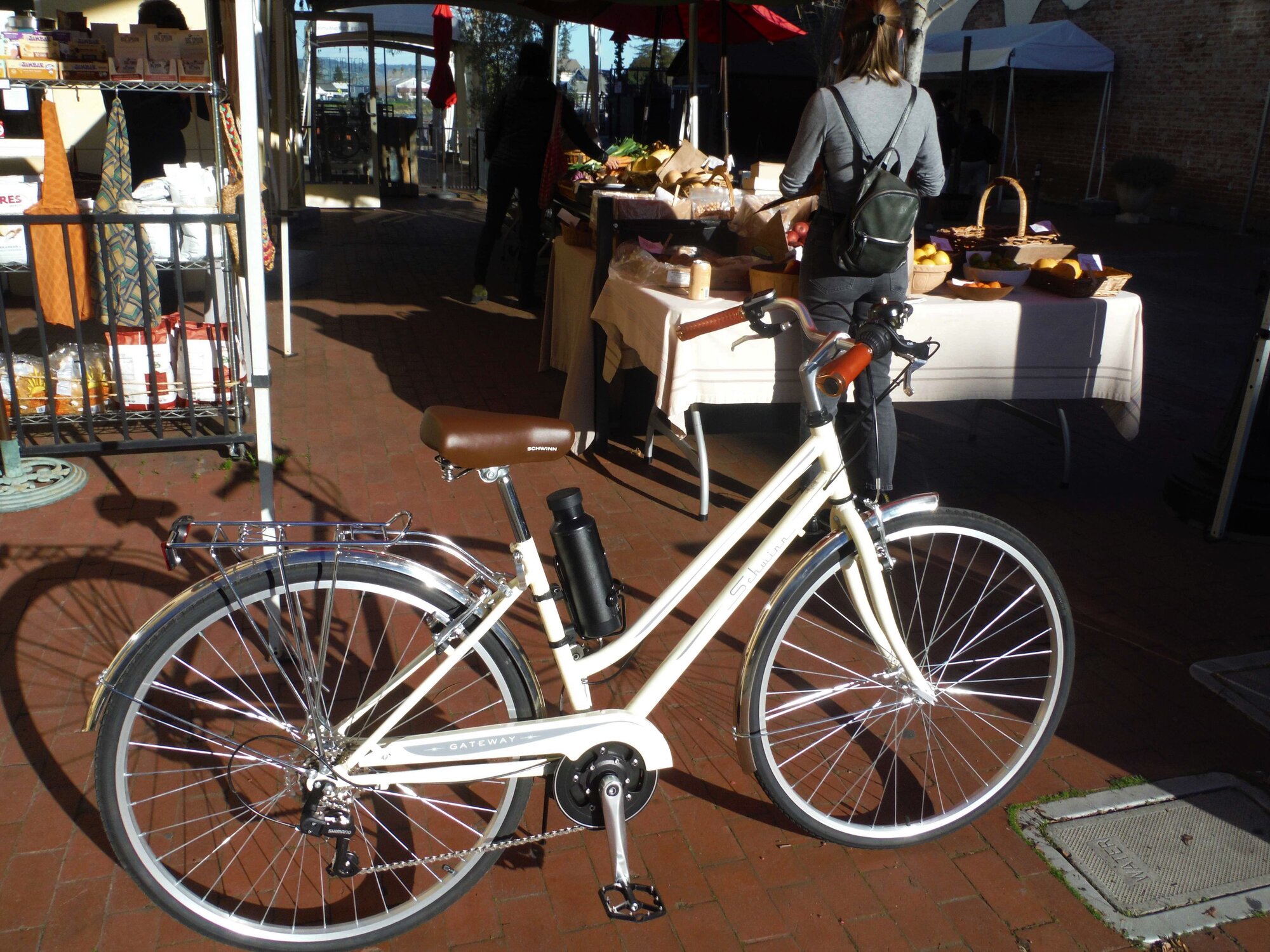

Hi @kmccune! A French chef was given a new $300 bike from Target for Christmas. I made it nicer and installed the conversion. She loves it. The crappy forged steel American crank was replaced by the mid-drive. I upgraded things such as the grips and brake pads. And have been able to eat for free for the last four months and counting. This is not normal food. It is multi-course and top notch. Her bike is called a Gateway, as in being a gateway drug. In other words, it is a starter bike. She is not going to be in any races. It is for around town.
Danged if you don't do good work. One these days I am going to manage to get my gnarled little paws on a TDZ middrive and make a build accordingly,I had a very brief experience with a Mid-drive of this sort, and Must say it was slick! Good build and "Bon Appetit!" Going to peruse the "Gateway' thanks.
One of the challenges converting a women's/step through bike is a place to mount the battery. Will it still be a step through when the battery is mounted? If not, why not just go with a step over frame?

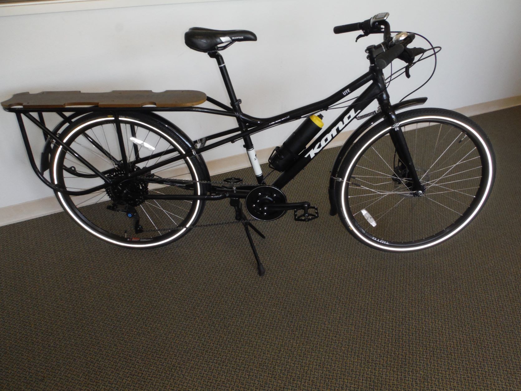

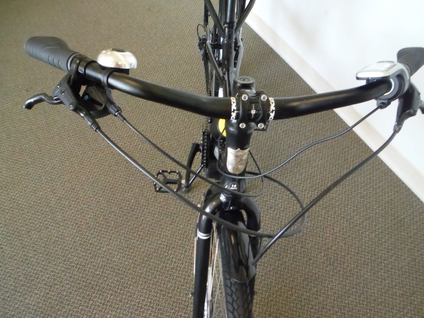

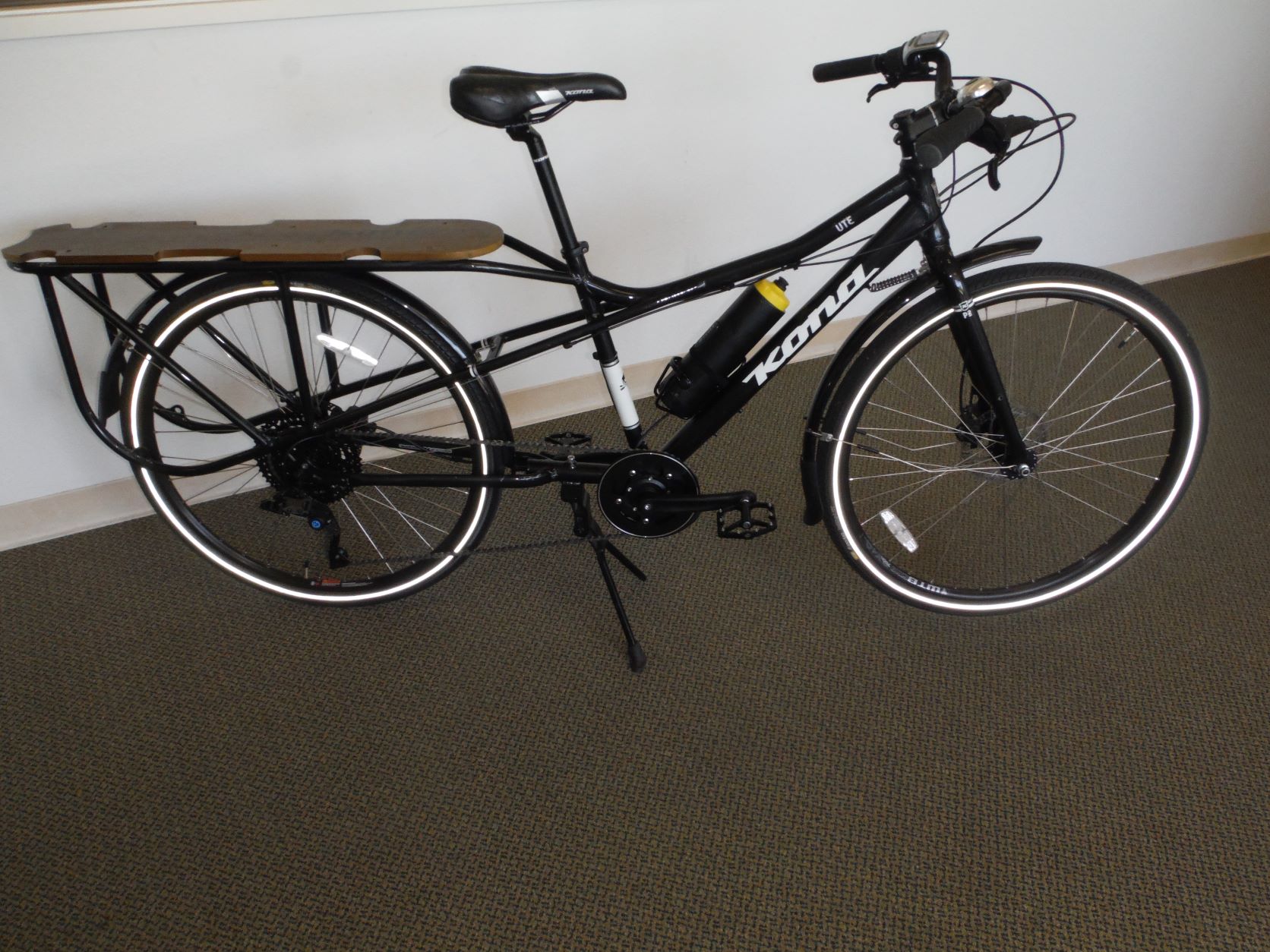

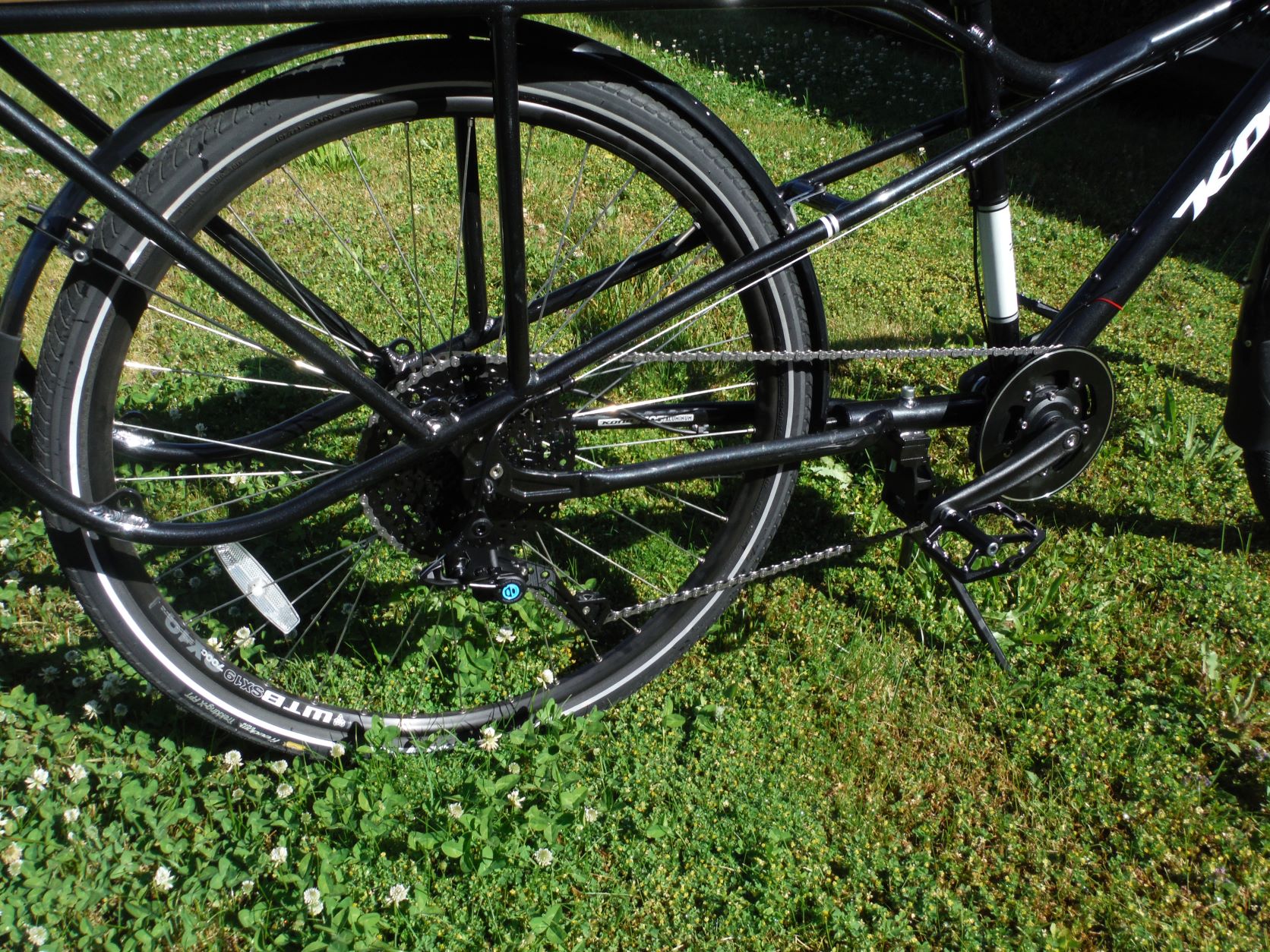

Yesterday I fixed up a seven-year-old light weight aluminum cargo bike with a low step frame. Then I made it electric. People hate non-electric cargo bikes and will sell cheap to free up space in their garages. I put an 11-50 cluster on the rear, so it can climb cliffs and go 30.

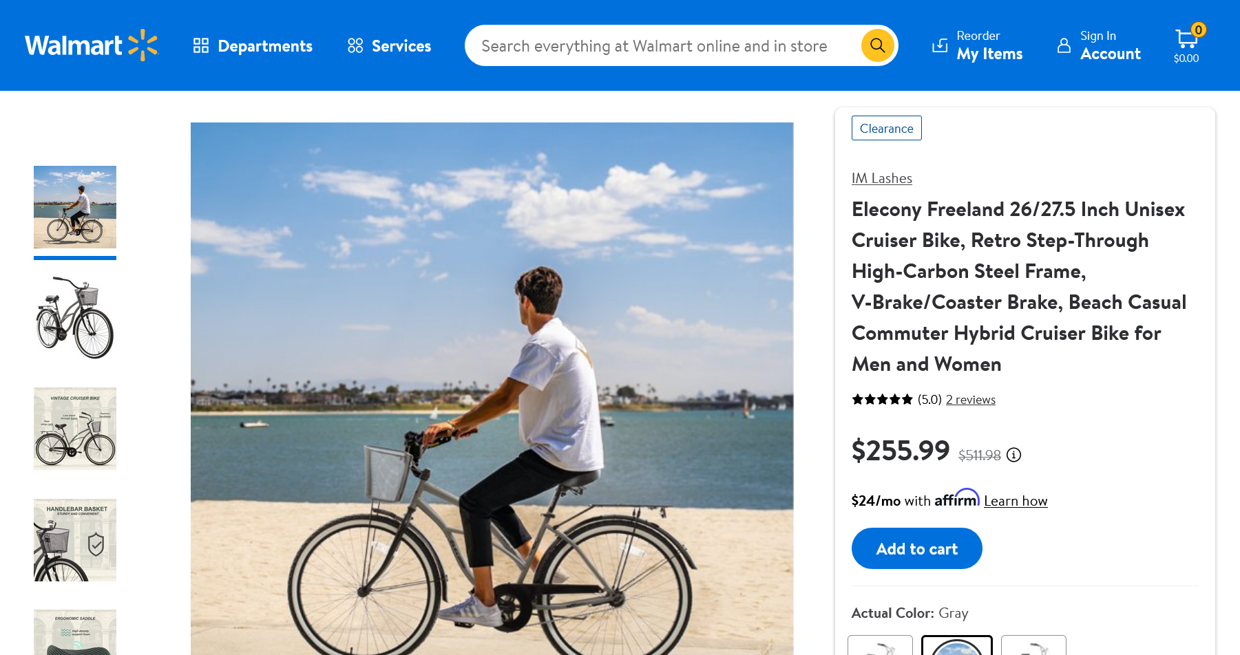

Can you tell us which Schwinn it is... maybe post a link or a screenshot from walmart.com
Didn't have my phone with me and I cannot recall the model name,Wal-mart doesnt do a good job of even putting the price where you can find it,I probably should pull one off the rack and sit on it,I require something like an 18" frame or it feels terrible and confining another thing like Pedaluma makes known is how many different models Schwinn makes,I did see something very interesting for sale on"FBMP" a pair of 32"ers for peanuts, the picture showed a nice low step frame, they were single speed( more and more I am beginning to see the utility of a single-speed because unless I am climbing I leave the bikes in 4th or 5th anyway I will check on WW site to find bike model, kinda crazy I know ,I'm starting to take a "hankering" to "Margaritaville" I love a streched out cruiser.
OK, it was either a "sidewinder" or "Aluminum Comp" 27.5
... I put an 11-50 cluster on the rear, so it can climb cliffs and go 30.

I think even though the Advent cluster I was showing in that other thread is better for mids, maybe the derailleur/shifter should come from Box. I was having some funky shifting from my Advent setup last week - I spent the week riding that bike. Am going to try and spend another week at home starting Wednesday and may pull the panniers off so I can get to the derailleur and make sure I got it set up properly.
Are you using the Box instructions for adjusting the derailleur? Non traditional to say the least but I used them and I'll be damned they work.
I usually use the Park Tool method.

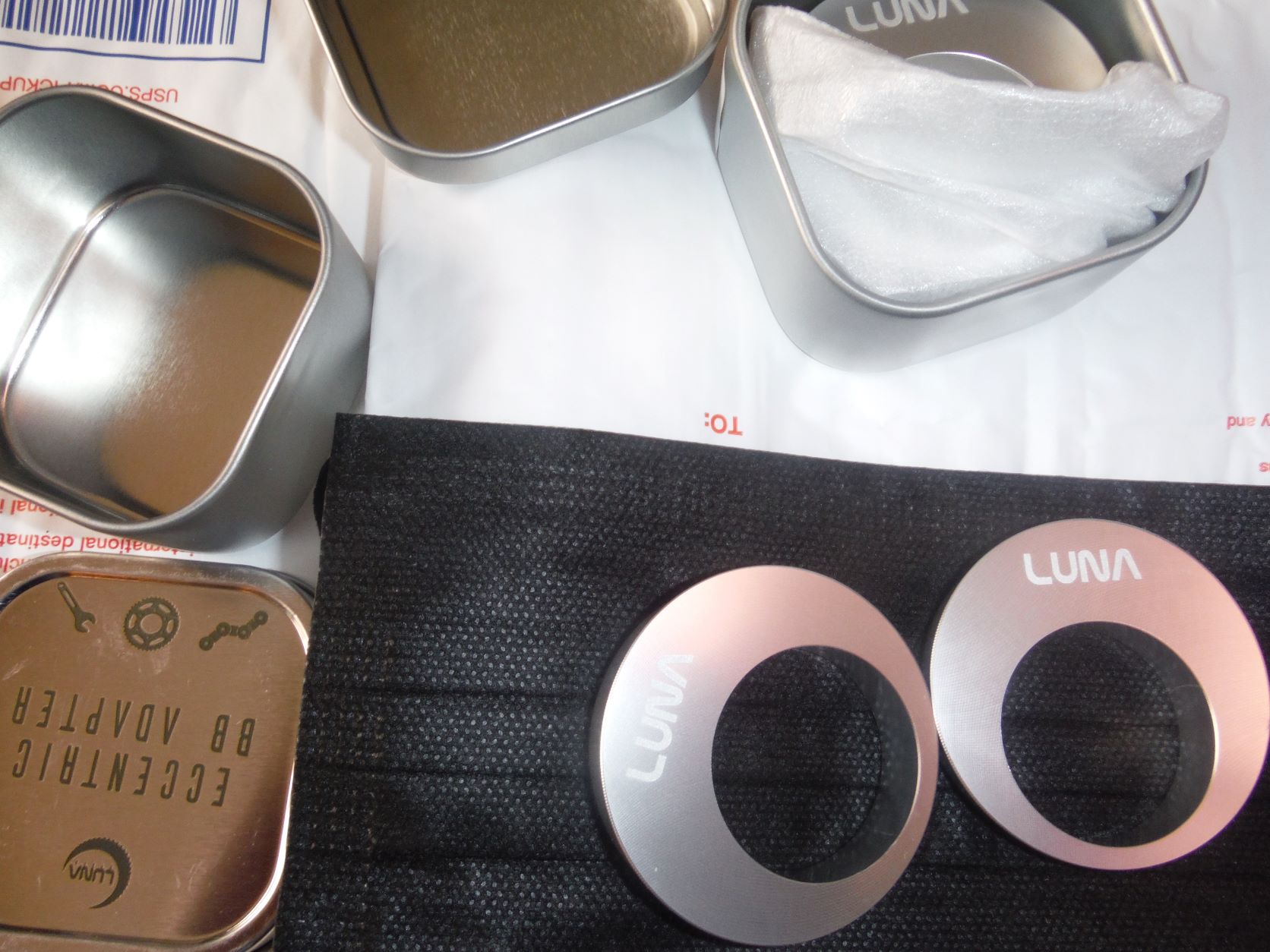

I just saw this one. When you do a conversion of an American BB bike you need the conversion cups, asymetrical, from LUNA. I have been trying to work on my bike all day but I keep getting slammed like Richard Pryor and pussy (cats). I have been doing test rides up in the hills with folks all day and three bikes came in today for tune-ups with conversions when I had nothing planned.
I do it like Tommy plays pinball. I didn't know there were instructions. I bolted it on and set the limits before the chain. The jockey in 2 was rubbing 1 but the indexing was good. So, that took a 'b'-screw adjustment. I bought the box 3 without a place for it to land and the Kona came in as a surprise. It had a Tourney cluster, so when I showed him the Box he said, Hell Yes.
You could have a crimped housing. A bike came in last week and the shifting sucked. Some kid at REI used zip ties on the housing that were tightened down to 11 in a reptilian death grip. Just saw the video. Mine had 2.5mm cap screws not Philips head.

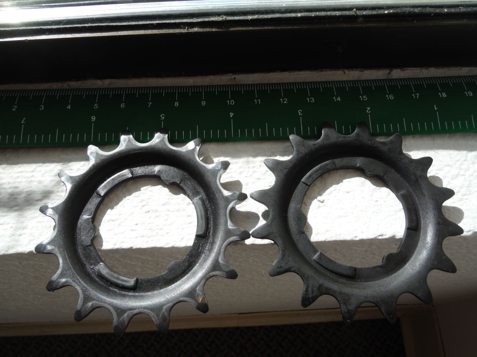

Confessions of a cog killer. I killed the cog on my three speed. I also killed the tires. And it will need a new chainring. The tires were new in Feb along with the cog and chain. Because it is a coaster brake stress is applied in two directions. I ride it hard and take big climbs. Here are the asymmetric converters from Luna.
Where do you get these awesome bikes? and what size bottle battery do you use" I have been having good luck with the small"Hailong triangle batteries( 10 Ah 48 volt and 12 ah 36 Volt
OMFG I think you landed right on it. The shifter cable is in-frame and comes out right onto the motor. I had to position that motor just right to NOT crimp the shifter cable and I bet I could use some grease or oil down same, as I did change cabling. Whats been happening - and this is very difficult to confirm on a longtail you can't just look down at and watch since a) its so far back and b) its covered by panniers - is I shift and sometimes seconds later I get a gear change. Oftentimes shifts are so smooth there is no overt sign they have been completed (I do the stutter-step so I re-engage power a couple seconds after the shift, which takes about 20% of a pedal stroke) , which makes the under-power thunk a few seconds later really annoying. Fortunately I have de-fanged the BBSHD's PAS so I am not risking a Taco Tuesday on the drivetrain.
