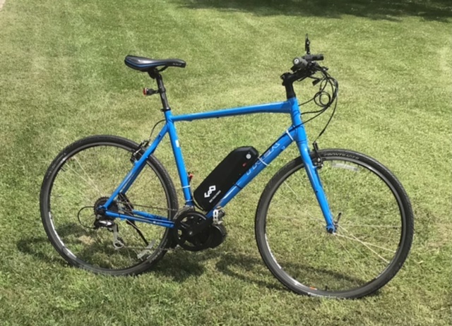

750W 48V BBS02B kit on Trek FX 7.2
MWRider
Just got this together. Need to route the wiring a little better and I got a Shift Sensor to mount. Figure that I will put the Sensor on my wife’s kit set up after I have a chance to try it on mine, ( I do not mind using the brake switch like a motorcycle clutch). I got the P850C Display with this one, which looks a little more user friendly than the DPC18 that I got for my wife’s.
The P850C Display, out of the box was set for 5 PAS levels, with the Speed Limit set at 99. 0 being no assist. On a setting of 1, it took off pretty fast and did not require much assistance from me. Assistance increased with each higher level. With a 44T chain ring I topped out at 31 mph. Went for a 17 mile ride with my wife. Was a pretty flat ride. Averaged about 16 mph. Most of the ride, I had it set at 0.
Reset the P850C to 9 PAS levels and Speed Limit at 15. 0 is still no assist. Levels 1 thru 9 are incrementally greater assistance, with the operator having to help until you get into the higher levels.
I just got a programming cable today, so will have to check that out.
