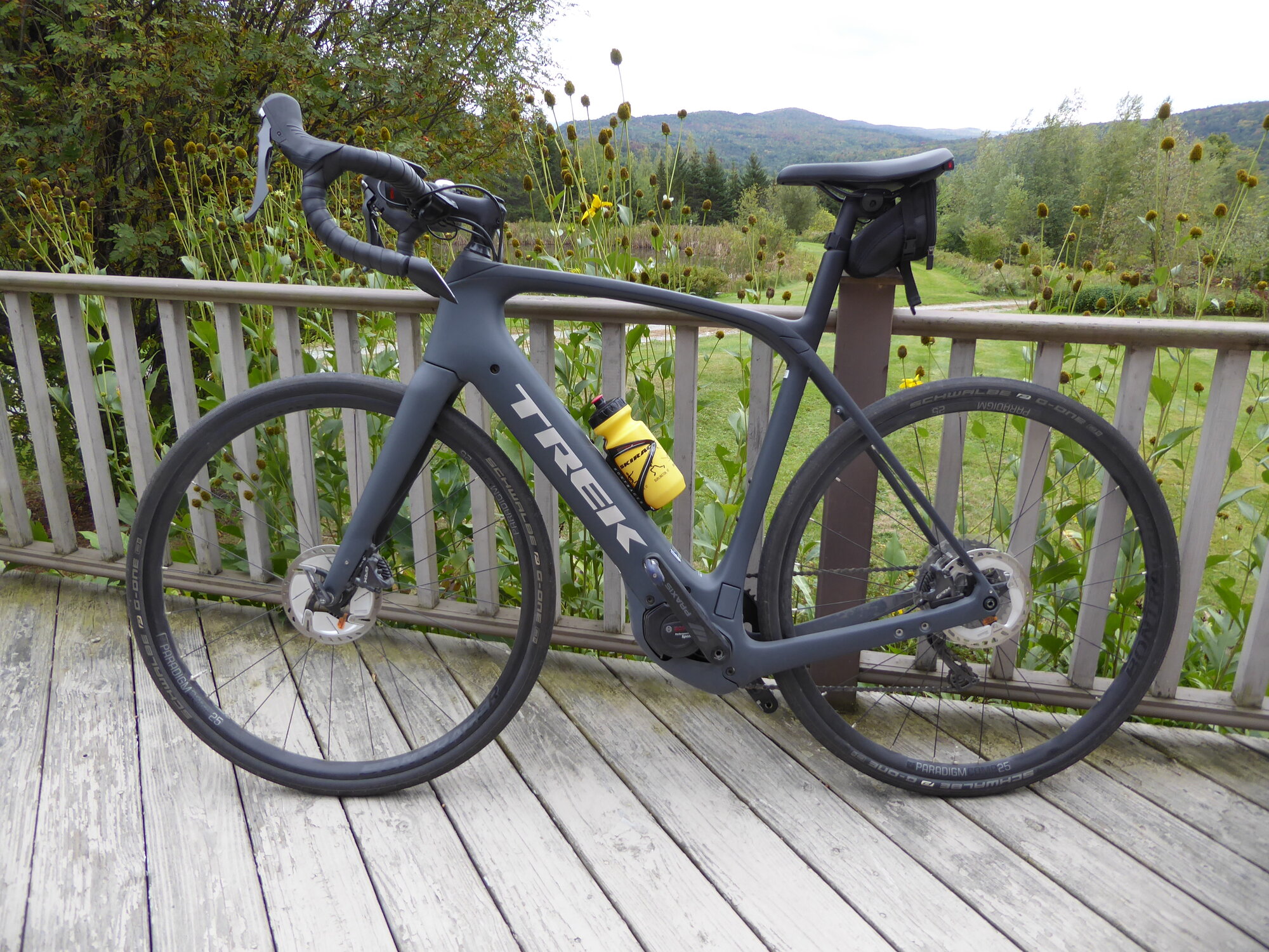

I have had a Trek Domane HP+ since May 21st this year. In order to get this bike in my frame size, 58 cm I had to take a 5 hour drive to Albany, NY. Dealership is Steiners. I took my bike shorts, shoes and a set of Speedplay pedals to test ride the bike. I also asked the dealership to download all the latest software for the Kiox, Bosch motor, battery, and set up lights so I can select them on or off, as I ride. Got a printout of this software update too.
Dealer had bike charged and ready, set the seat tube at proper height, then I went for a short ride. Rear shifter wasn't working properly, took it back to this good bike tech, who was embarrassed that someone else in the shop hadn't adjusted it properly.
Took it for another ride. Had the seat angle adjusted . After third ride, put the bike in my car, and headed home, back to Northern Vermont..
I have over 500 miles on this bike now, some gravel roads, mainly paved roads and absolutely no issues. Nothing. I did remove the sidestand, so you can see the two holes on the rear fork.
I removed my kickstand too. I will turn 1400 miles this week and I love it.
