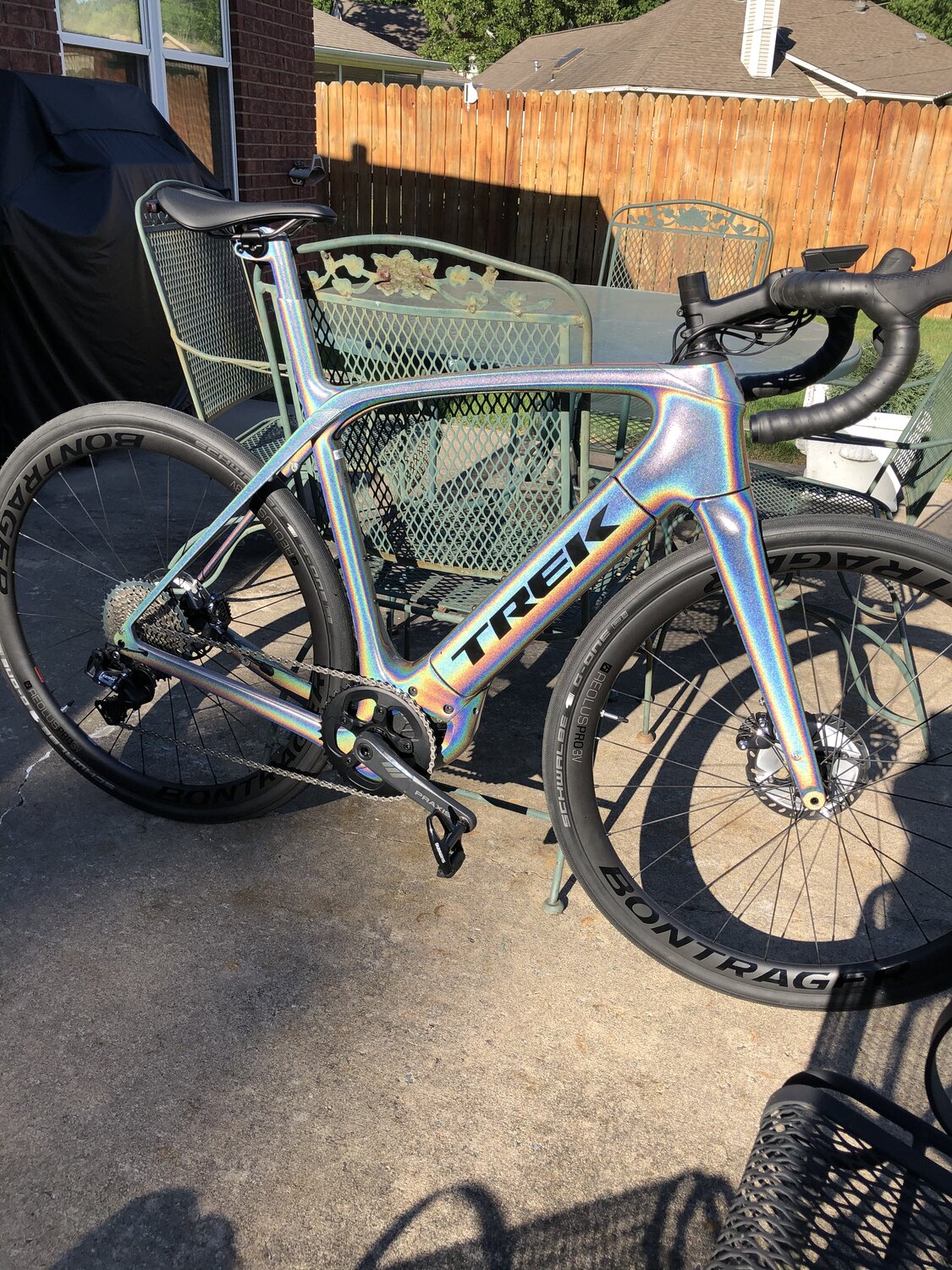

I hear these problems some people are having with the Domane+. I'm not doubting their problems but I can't help believe most of the problems are from poor workmanship when the shop put it together. I've had my Domane+ HP7 for a little over a year now and have had only one problem that was the battery key locking mechanism was loose and didn't want to work very smoothly. Ended up the I tightened up the 4 screws holding it in place now works fine. Other than that I have over 3,500 miles on it and I've had zero problems with this bike. The Domane+ HP7 is the same bike as the Domane+ just with higher end components and wheels. This is a really amazing and fun bike. Over my many years of road and mountain biking on numerous Specialized and Trek bikes this is my best investment of all of them as for fit, reliability and just most fun to ride. If I had my choice of any ebike it would still the Domane+ HP7. My bike below.
Amazing paint!
Absolutely gorgeous!
