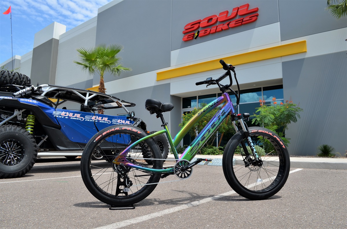

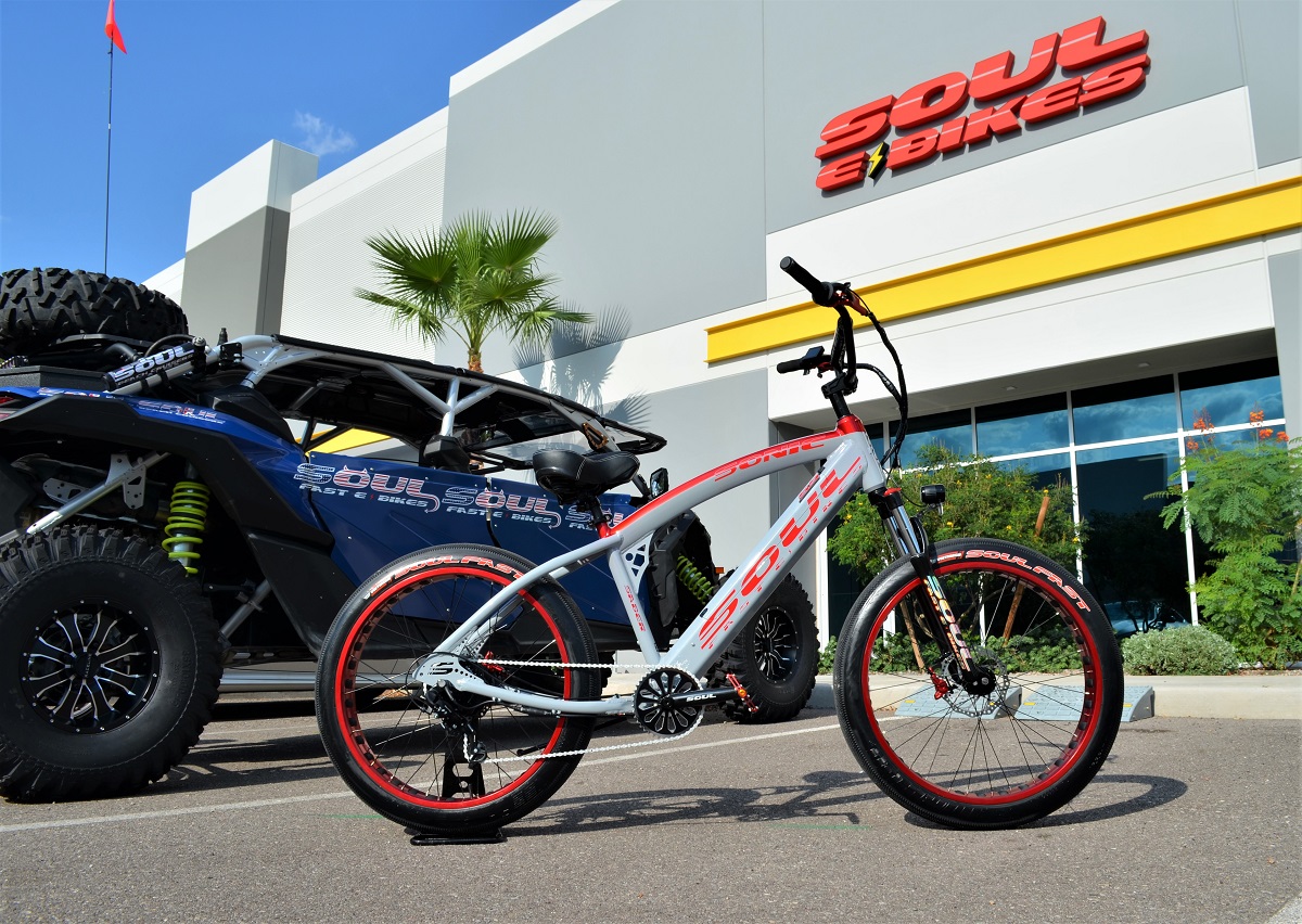

https://www.soulbeachcruisers.com/shop/
Big cruiser style bikes. I'm 6ft - 285lbs. Moves me around at a pretty quick pace. Liked my first bike so much that I bought a second one in a different color. Don't be mislead by the "Miss" version. It's a big bike. 26" wheels, plenty of power and plenty of seatpost height adjustment.
I looked at these and have to revisit, their st's are classified as woman's models and have to see height and weight restrictions. Thnx

Don’t let the “Miss” model deter you. It’s for marketing. It’s a step through. They have a 24” model with less power for the ladies. Nowadays there isn’t a ”women’s bike. They’re called step throughs to get past the stigma. I had both of my knees replaced and I have to lean the bikes Wayyyyy down to get my leg over.

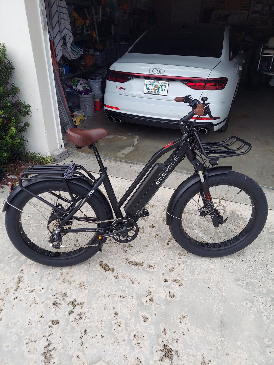

And keep your crank bolts tightened, 15mm socket does the trick, as they are famous for coming loose and if they do the only repair is a new crank......They are on a tapered spindle and will seat eventually.
Pedal is connected to the crank arm, and the crank arm is connected to the crank shaft. Bolt that can cause an issue on occasion is the one that fastens the crank arm to the crank shaft. Looks like it might have a cover hiding it on your bike. Likely something that's easily popped off to allow you to see if the bolt is tight.
It is likely a 14mm socket if it has a cover. Black on black it is hard to tell. Could be a 8mm hex.
