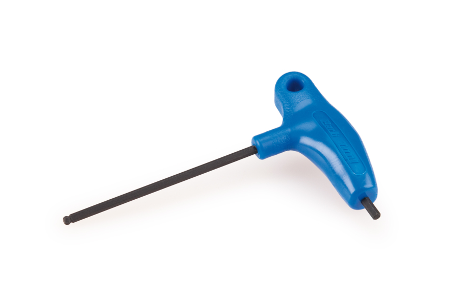

If you insert the short end of a Park Tool 4mm wrench every day into hex screws of face plates of stems, it will give you the same deflection on the end of the long side every time when it is properly torqued. It is a kind of torque wrench in that way.
