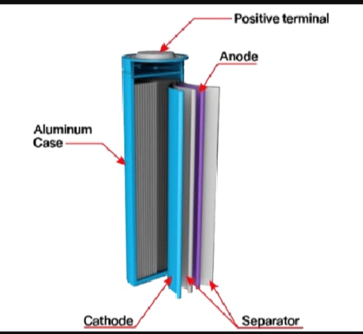

When a lithium battery is empty, it usually means that the BMS is over-discharged, but it is not completely no power. If the internal polarity is short-circuited or in an extreme temperature environment, it may still catch fire.
Therefore, when choosing batteries, you must choose batteries from regular manufacturers that have obtained safety certification. Similarly, the charger for charging lithium batteries is also very important. For example, in the US market, you should choose a UL-certified charger, and do not choose a charger with a charging current that is too large for your battery capacity. You should also choose a charger with multiple protection mechanisms, such as over-current protection, over-voltage protection, short-circuit protection, and reverse connection protection.
