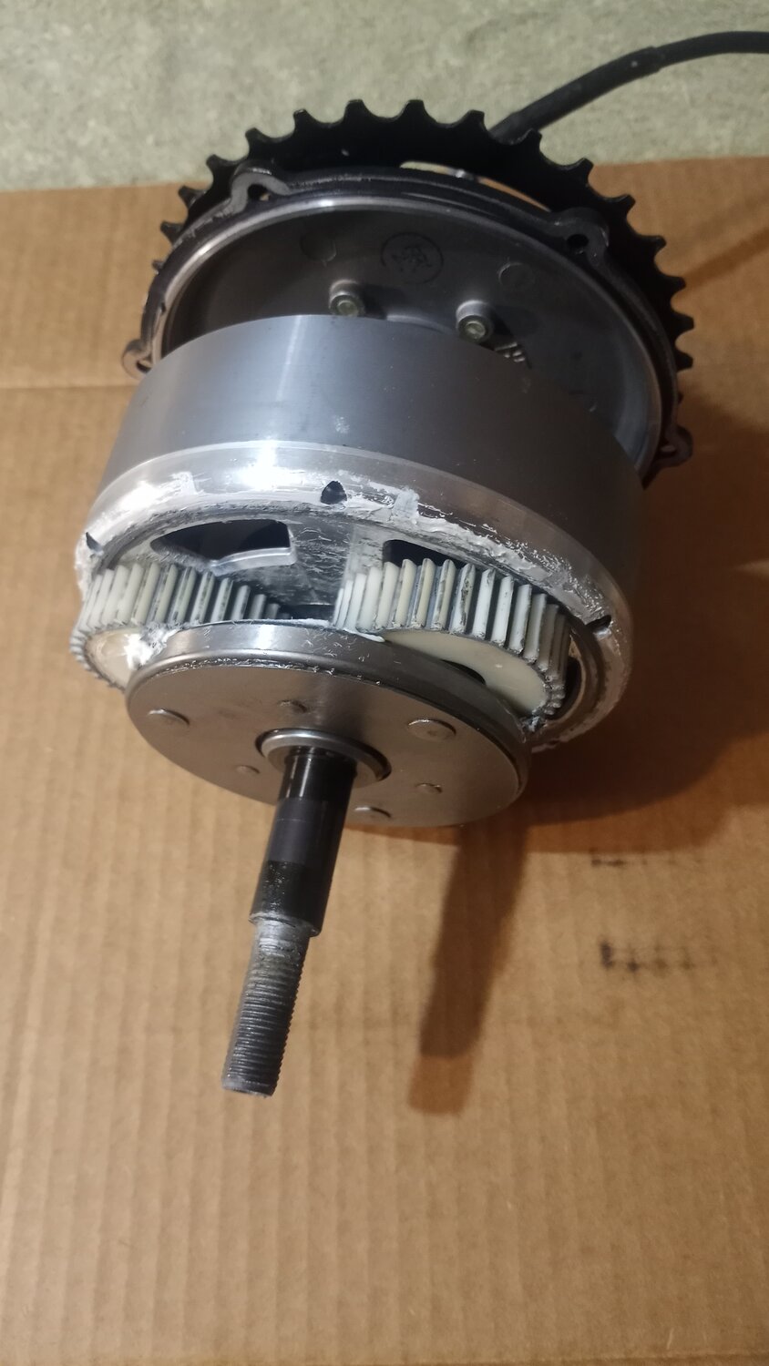

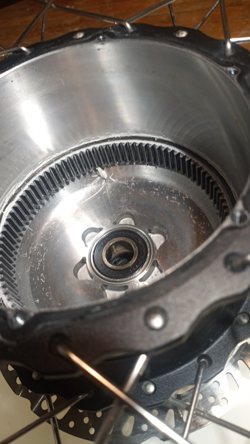

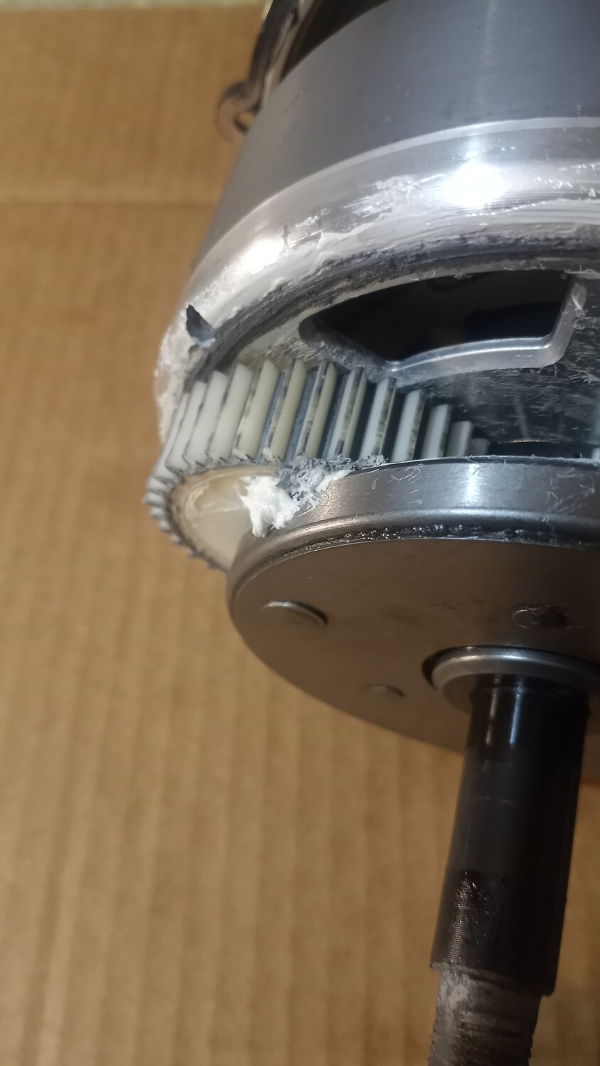

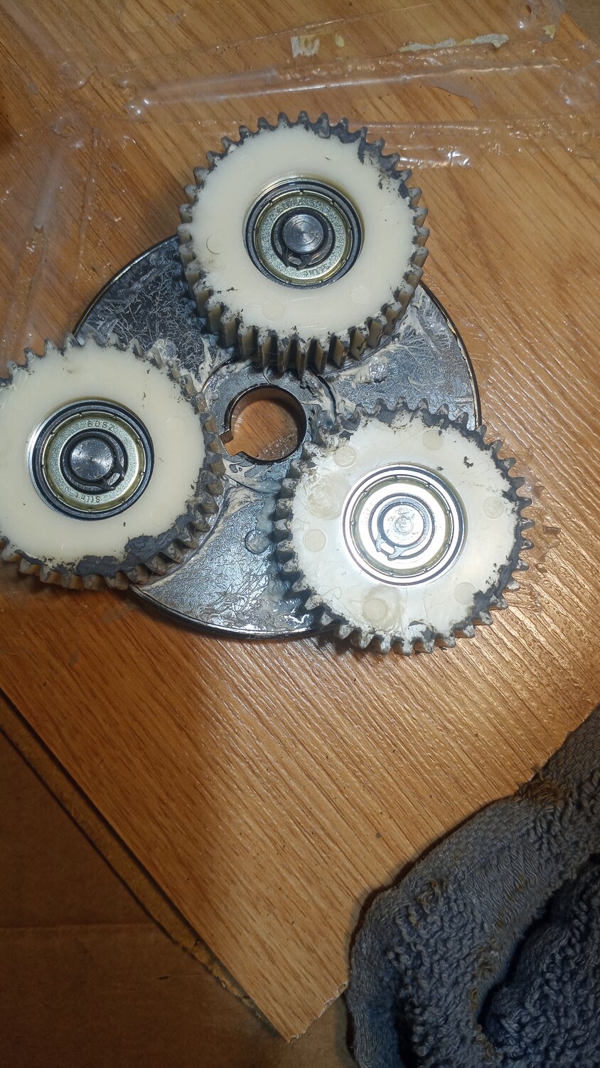

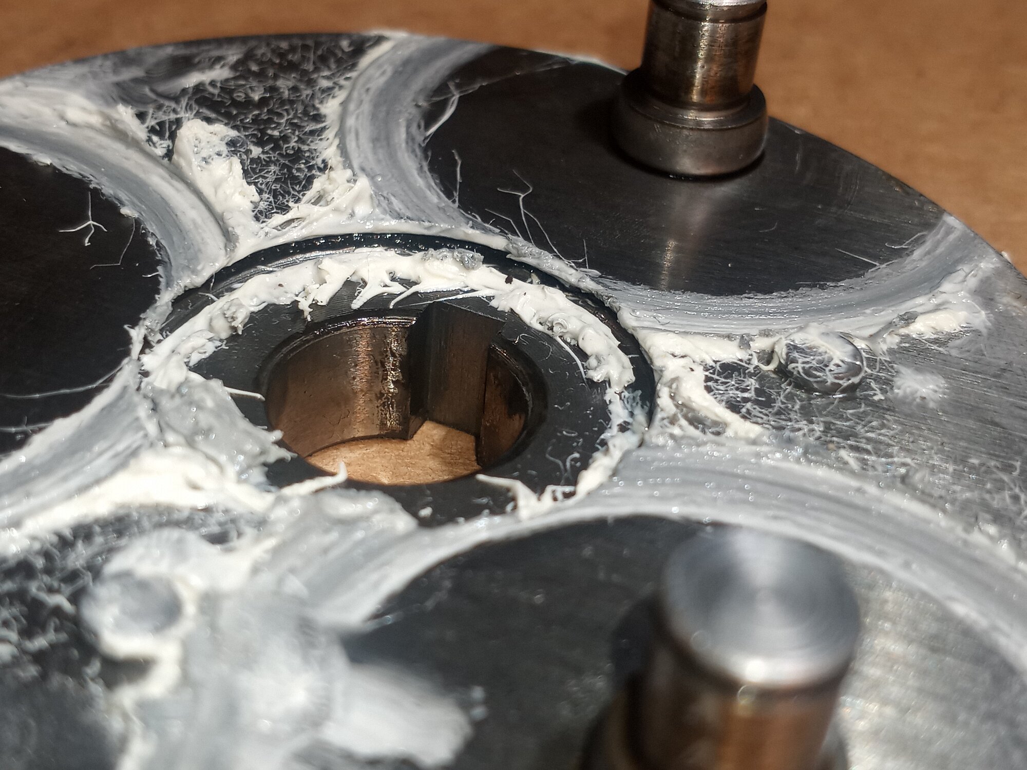

,.. I've opened up many Bafang hub and mid motors and found the gears moist (which is sufficient) but no real blobs of grease anywhere to be found.
I just opened up my hub motor to regrease it after 3500 km, and found very little grease,..
The grease in the teeth of the gears was like plasticine.
I spent hours trying to pick it all off with popsicle sticks, dental picks, q-tips and rags.
I didn't want to get any solvent in the bearings or electrics so I did it manually.
Apparently you aren't supposed to mix greases, so I wanted to get it all off.

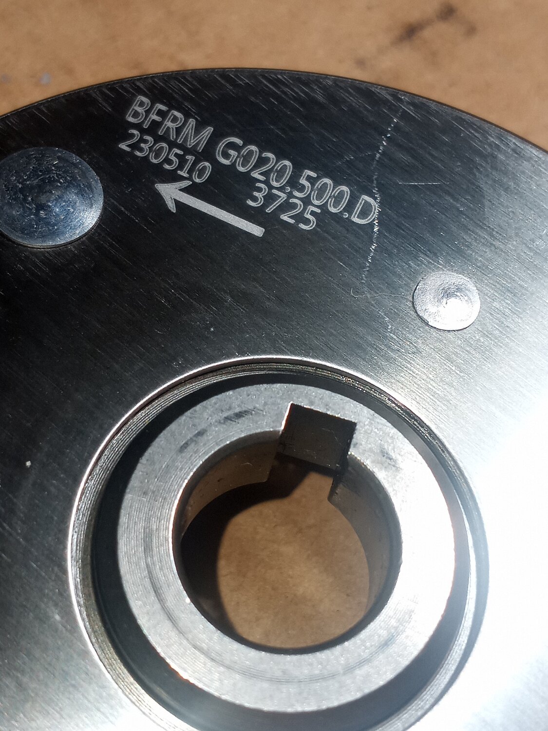

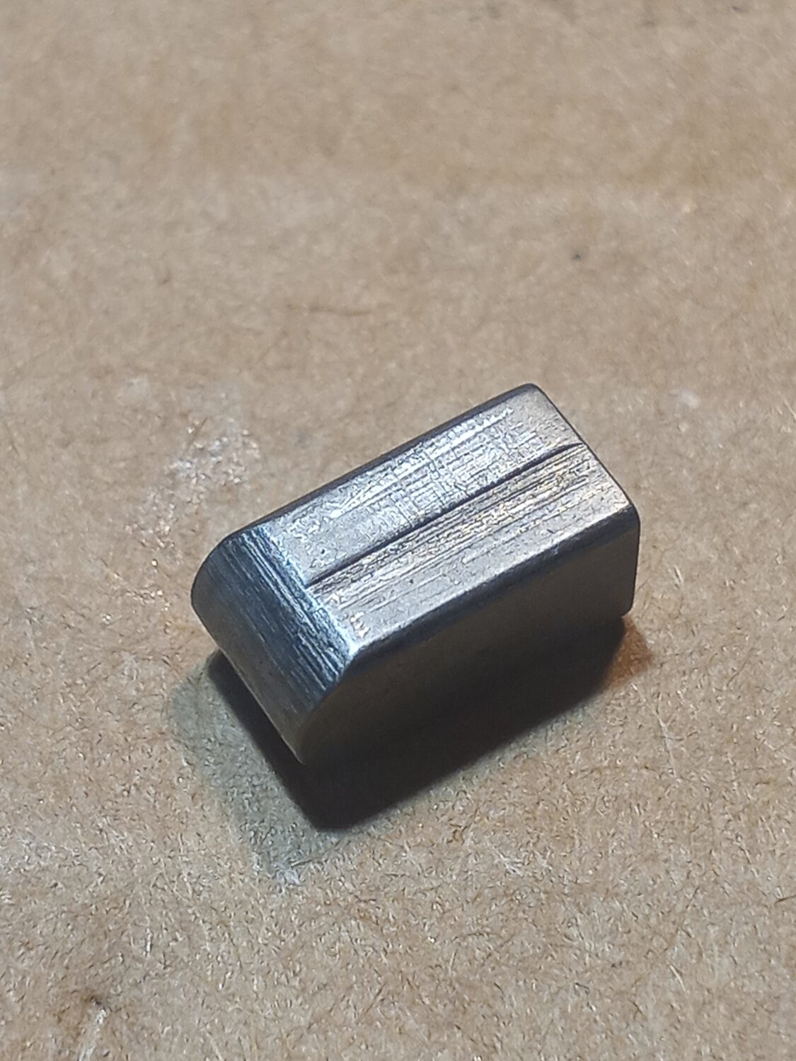

,.. - and look at a couple of Youtube vids and familiarize yourself with what needs to be done.
Take lots of pictures as you take things apart for reference when you put it back together.
My motor has a shim washer on the shaft that I ZipTied in place so I don't forget it or where it goes.
Put all the nuts bolts screws and washers back where they came from as soon as you get something apart so you don't lose it or forget where it goes.
Small things can be really important.

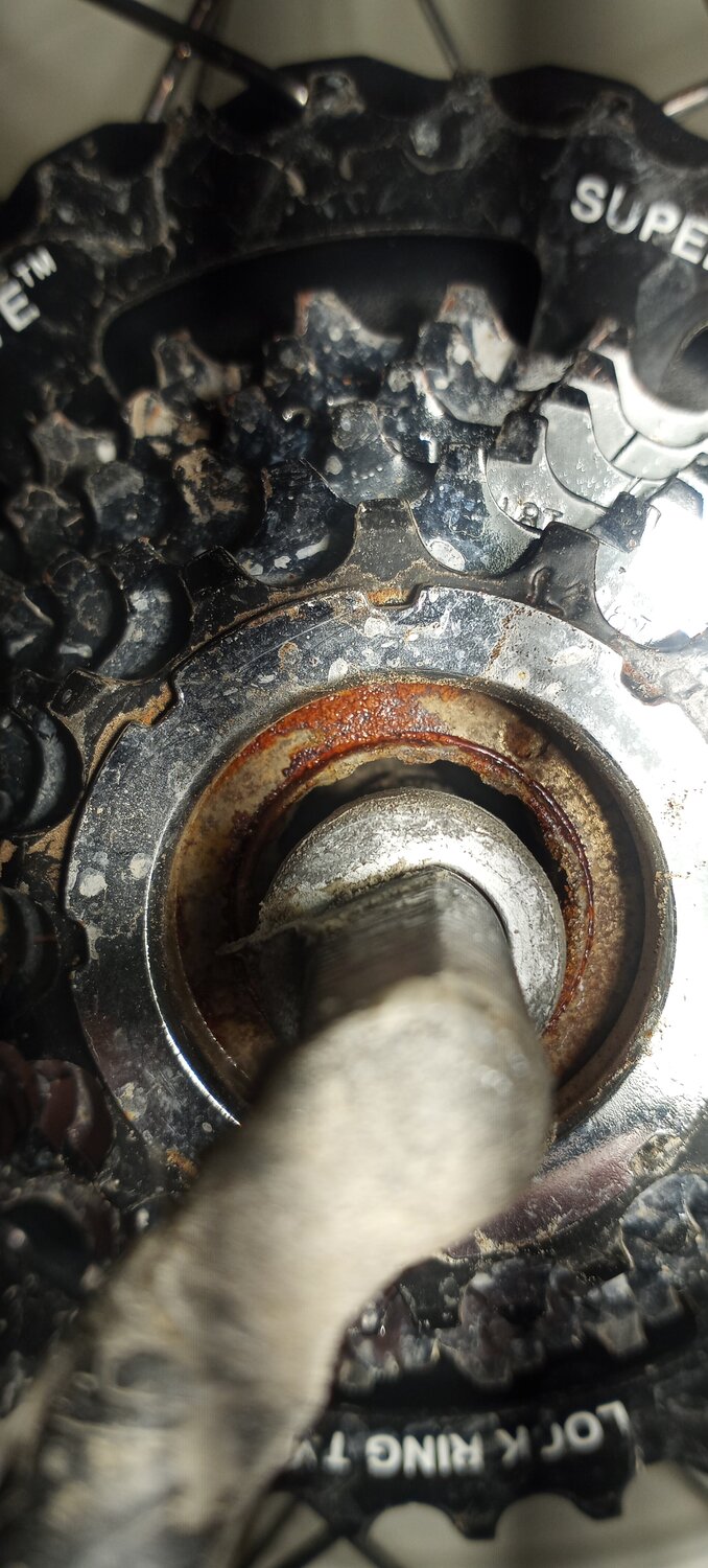

My motor has been apart for a week now while I struggle with trying to not fix something that ain't broke,.. 😂

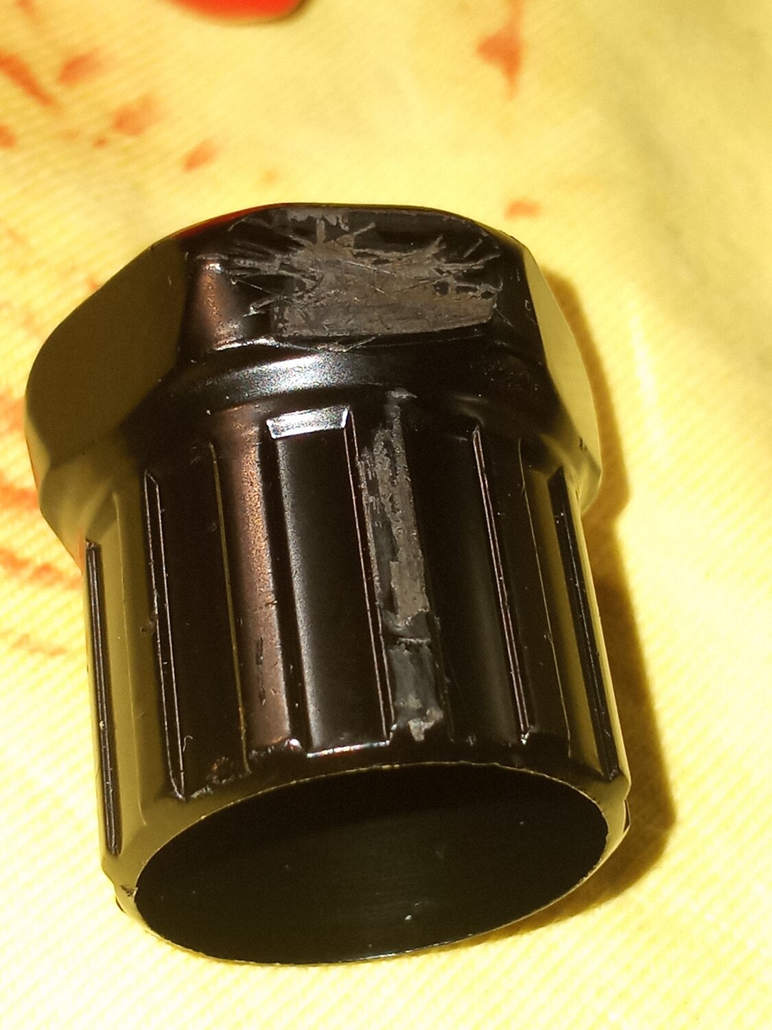

My freewheel works fine, but it's a rusty turd.
I almost never pedal so I'm not going to bother trying to remove the freewheel to take the motor completely apart and pull the armature out of the inner hub for a complete cleaning and repacking of everything.
And my freewheel tool is a 2 dollar piece of crap anyway, that was specially hardened with black paint. 😂
And I might need a lock ring tool, but I think it will come off as one piece ?
Either way, I don't care, I've been carefully cleaning the crap out and will just add a bit of really light oil to stop the rust.
I figure anything heavy will just attract dust and grit and make things worse??
There is a proper dust seal with a tiny built-in stainless steel coil spring on the axle shaft to keep the seal sealing.
It keeps water and crap from getting inside the motor.
I've been cleaning it and will repack it with grease again, then just put it back together.
