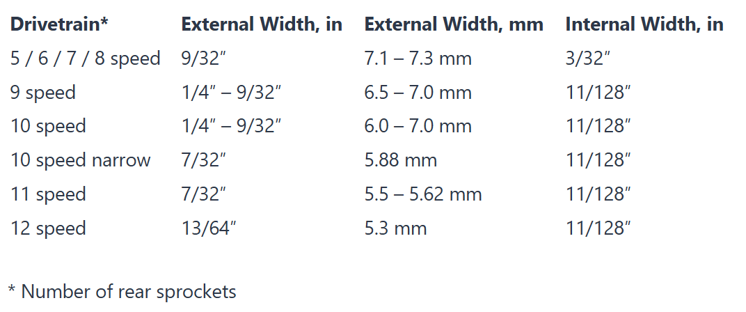

Had to get a new #7 chain Quick link for the OEM chain, as it is a solid chain,

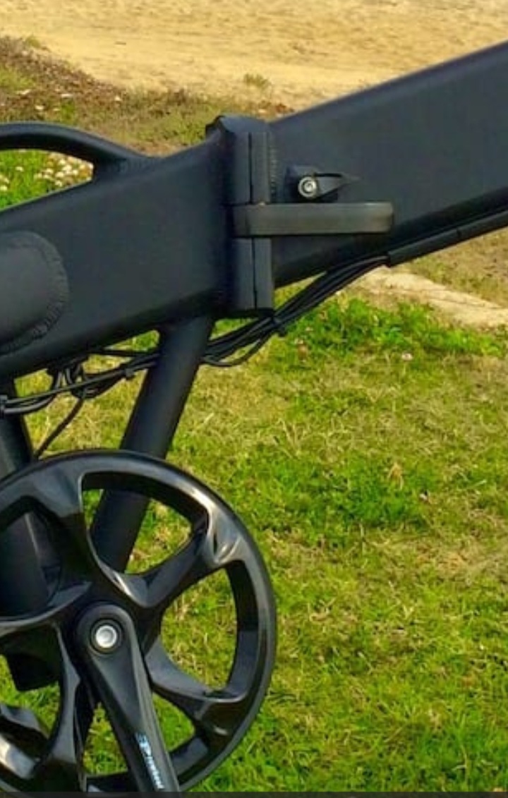

The folding mechanism on your bike Impresses the Hell outta me !!
It works by design and is fully sealed in case you land in the water after you jump out of the plane. 😂
All the other folders have some version of this crappy design,..
It either seizes up and you have to kick the s*it out of it to open and close the hinge, or it loosens up and your bike rides like a wet noodle. 😂

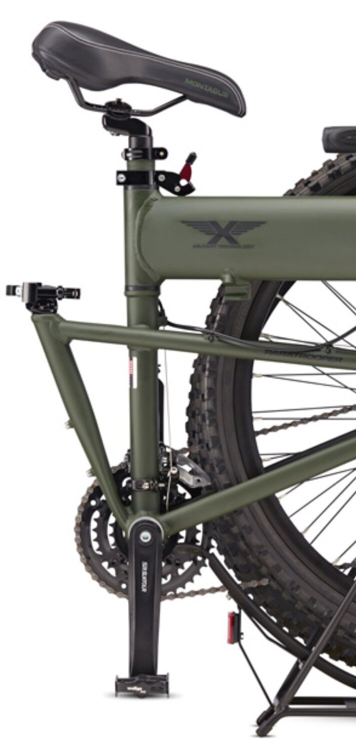

I'm sure you know that @PedalUma installed a motor on a Montague for @Art Deco.
I'm sure they can give you some pointers.
Does Montague make an ebike?
That square top tube if perfect for fitting a battery and controller inside.
(I haven't looked into it because I don't want to want another ebike. 😂)
PC
Yes, Montague ebike info here:
The oval top tube is only 4" tall and is only 1.75"+ thick, and is sealed at both ends via the welding to the frame parts etc.
