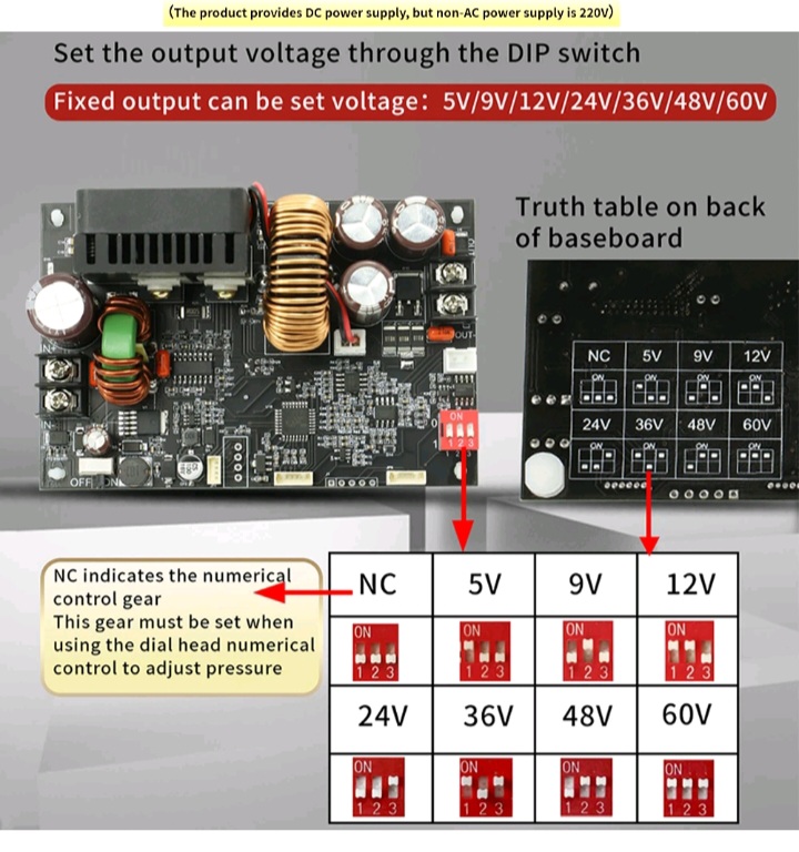

You can use one of these to convert your 48V battery output to 12V if that helps ?
I wouldn't actually try to pull 20A/1200W out of it though, or you'll smoke the thing.
Running it at about half the rated power is always a good idea.
You can use the dials on the display to adjust the voltage output to whatever you want, or not buy the display with it and use the DIP switches to pick the output voltage,..
You can set it to 12V to power anything that runs on 12VDC or set it to 5V to make it a USB Output.

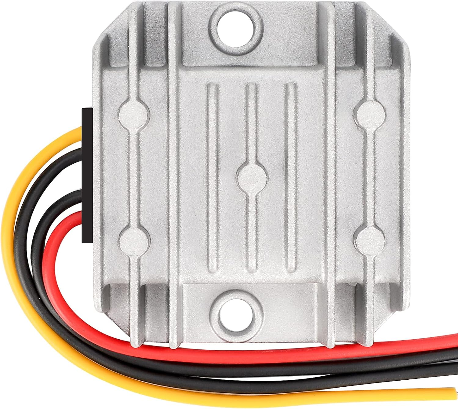

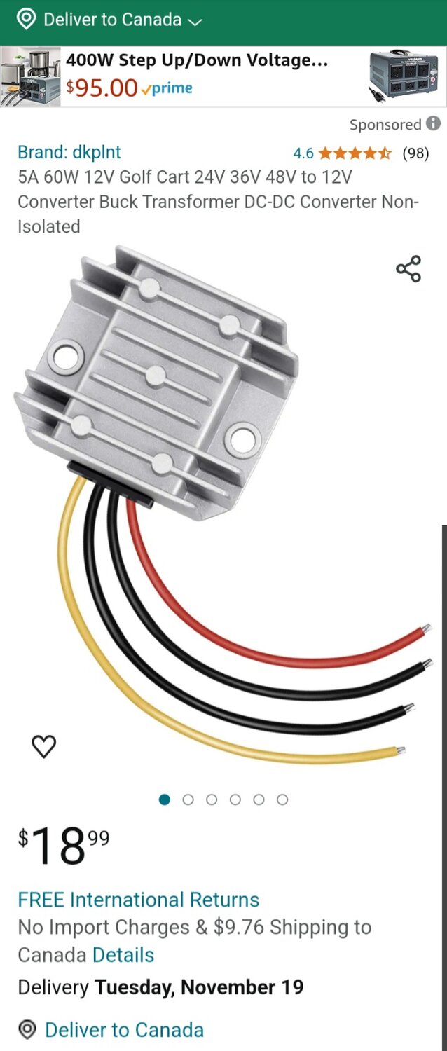

I'm not sure what you are trying to power from your e-bike battery but many of us use DC buck converters, such as this one, to get 12V from a 36 to 60V e-bike battery:
Good call 👍👍🏻,..
That looks like it's built for for the job.
My link is more for bench top use, and it's not waterproof.
Or leave it set at 12V and use a plug-in USB charger for a car to get your USB outlet.

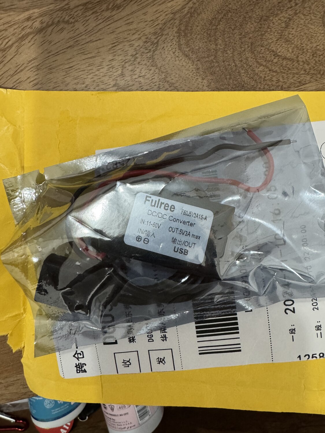

oh yes, I have a few converters like this but wanted one device to run 3 devices from just the one unit rather than have 3 step down converters connected to the battery going to different places. My controller have an input for a tracker and usb charger but unsure how much power I can draw from them.

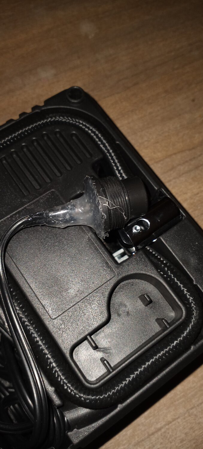

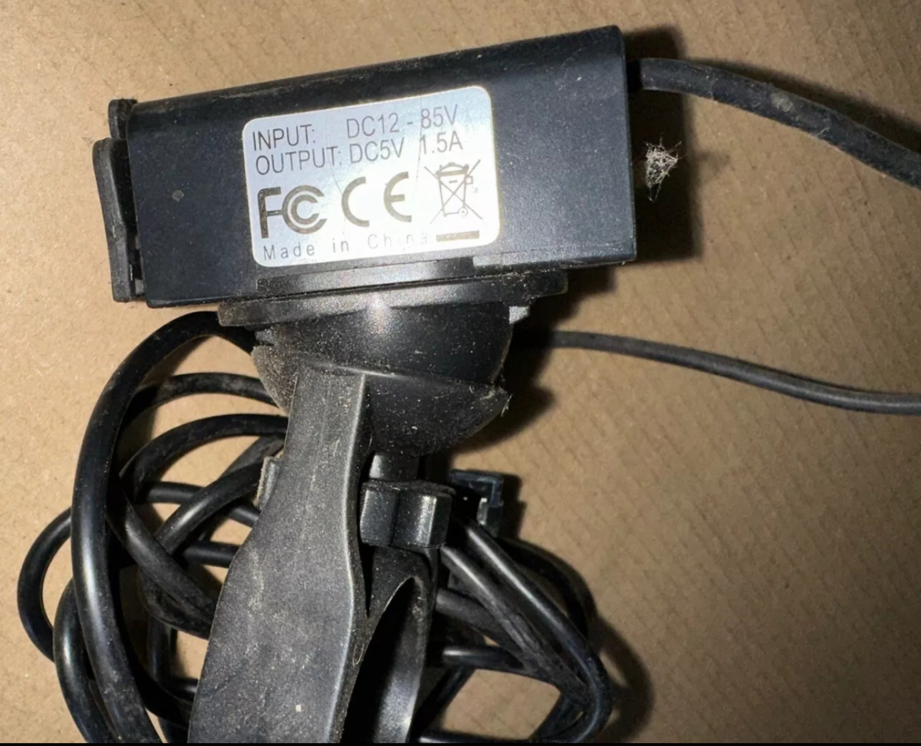

The first picture (with the packaging) is a usb port with 3a draw and the other is the one I’m using currently connected to the controller a SM plug.

@6zfshdb Posted a much better option if you want to install it On your ebike.
The one I linked to probably couldn't deal with the vibration and variable outdoor temperatures, and it Certainly can't get wet.
It's got a little built in fan that needs to breathe and would probably suck in dirt and water then crap out on you, possibly in a really bad way. 🔥

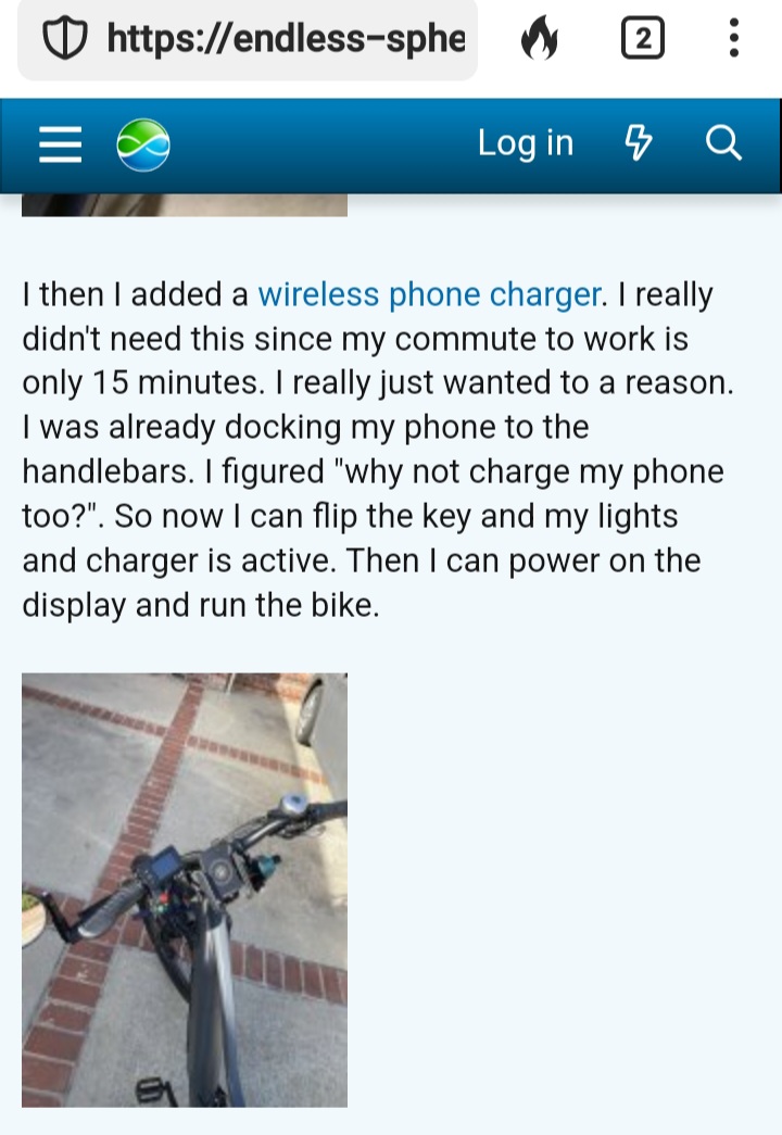

I tapped in to the 48+ and GND between the controller and display. I connected that to a DC-DC converter like the one pictured above. I had it powering my lights, turn signals, horn, and phone charger. Worked fine.
The DC-DC converter was wired after a key switch. So the key turned on all the lights, then I could turn on the display. The key, when removed, killed power to the display and you can not power the bike.

The buck converter I posted only has one output, but you can dial up a voltage or set the DIP switch.

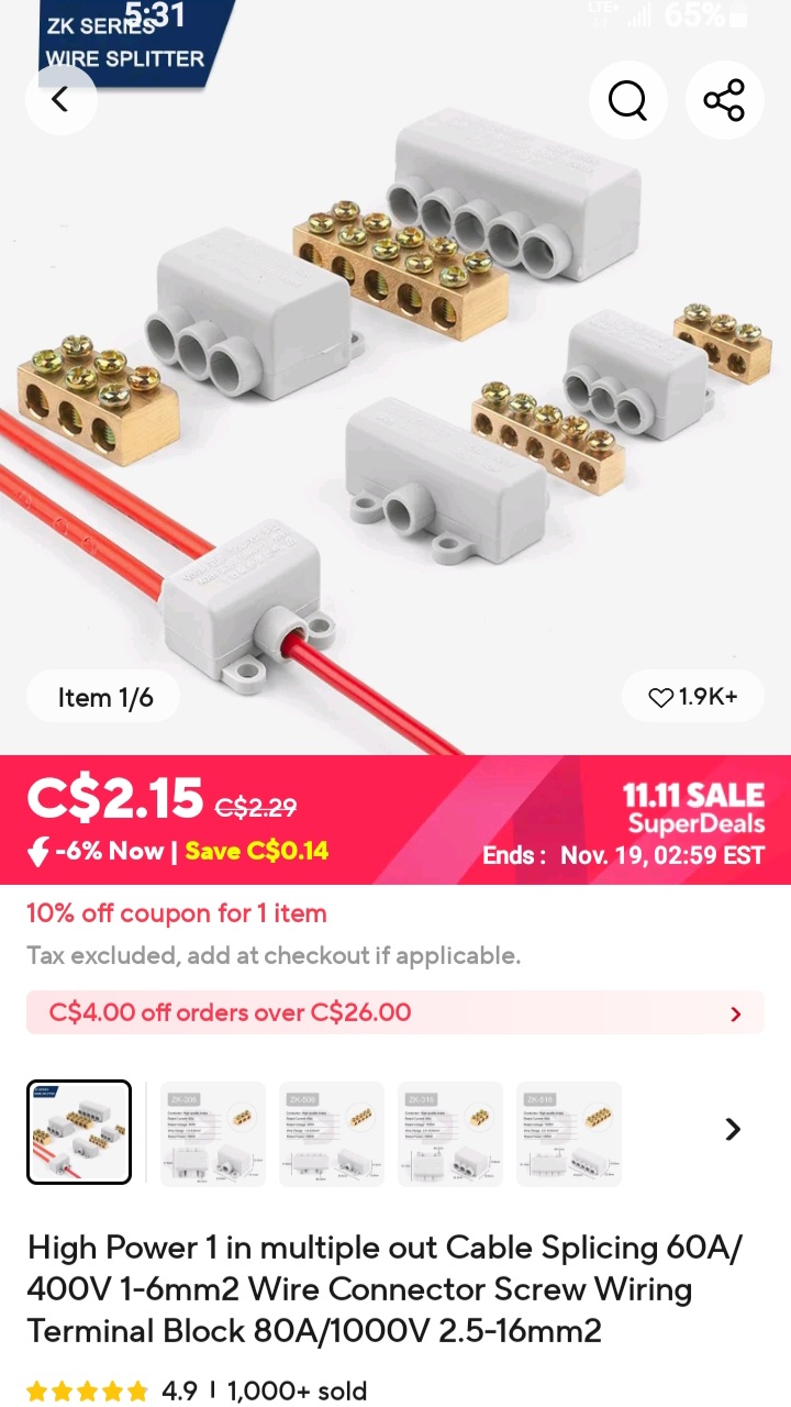

I don't think the splitter box is a good idea.
It's just an extra box with circuits that doesn't really serve a purpose.

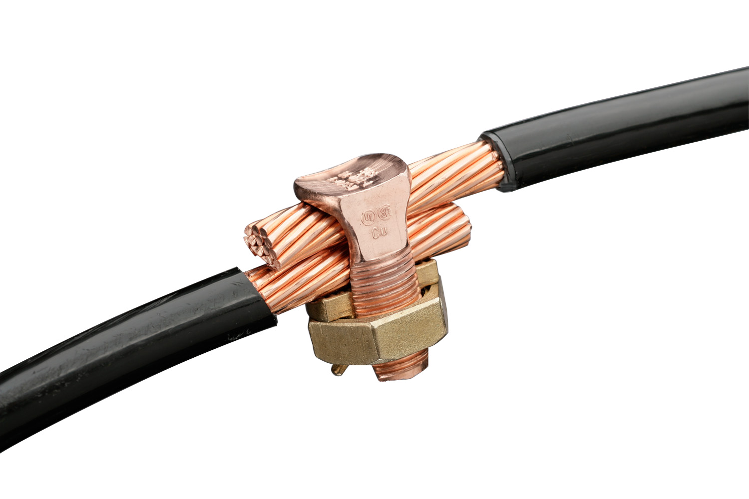

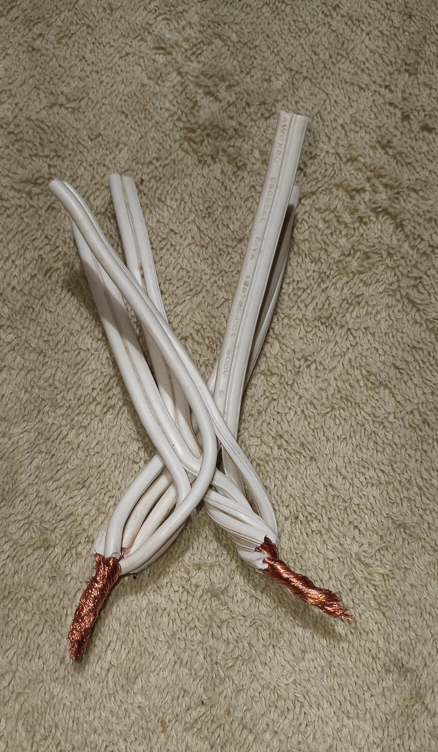

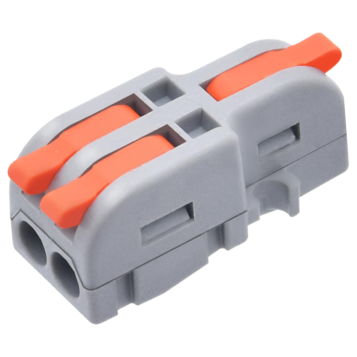

I think you should make your own splitter using two copper split bolts to join the output of the Buck Converter to a bunch of commonly available 12V connectors.
You can use two pin 12V connector plugs like this,..
Or a bunch of XT 60 male/female connectors with leads,..
Pinch all the leads together under a split bolt, then coat the split bolt and connections with clear Shoe Goo to seal and insulate the connection.
That's what I did to connect my 48V compressor directly to my battery,..

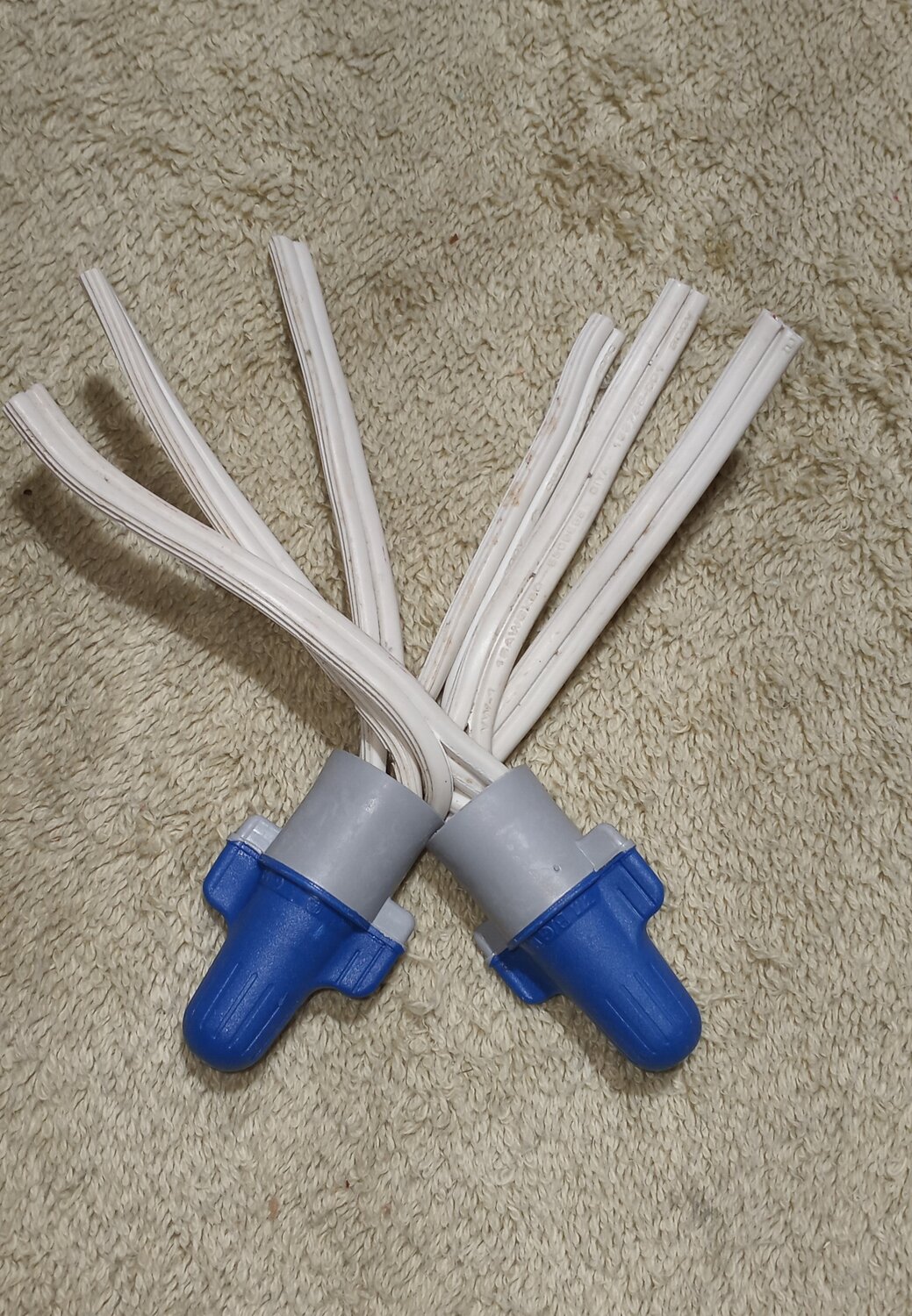

I just made a 5-way splitter using Mar Connectors (wire nuts),..
If I was going to use that on my e-bike, I'd also fill the connector with silicone or shoe goo to seal the wires and help prevent corrosion.
I just found these,..
I'm going to get some. I'd take it a step further and fill the inside of the box with dielectric grease or silicone to seal it once all the wires are installed.

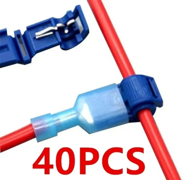

I'd stay away from crimp on connectors like this,..
They don't make very good contact and they tend to fail over time. They can cut into the strands of wire and let moisture in that starts to corrode.

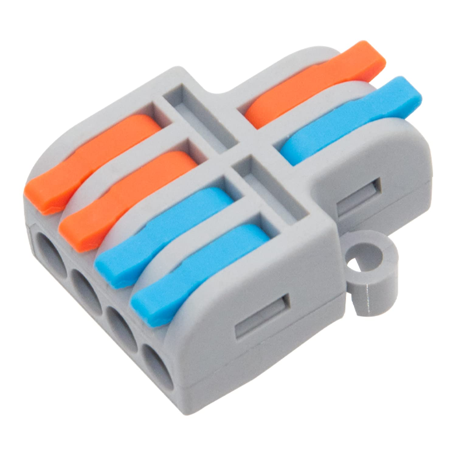

Don't forget these connectors:
They're reusable and require no tools.
