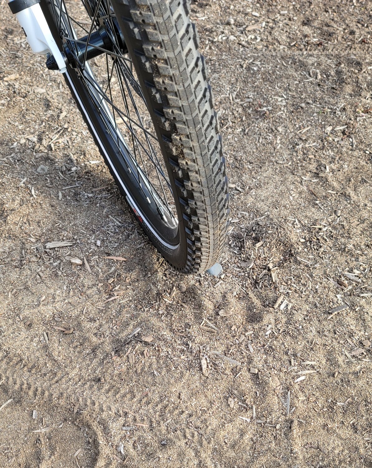

These are my ebike-rated 27.5 x 2.3" Specialized Crossroads Armadillos. The tracks show how the side lugs engage soft surfaces. The "Armadillo" indicates Specialized's highest level of puncture protection.

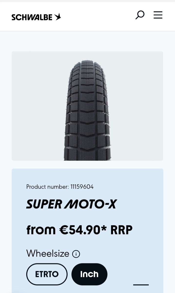

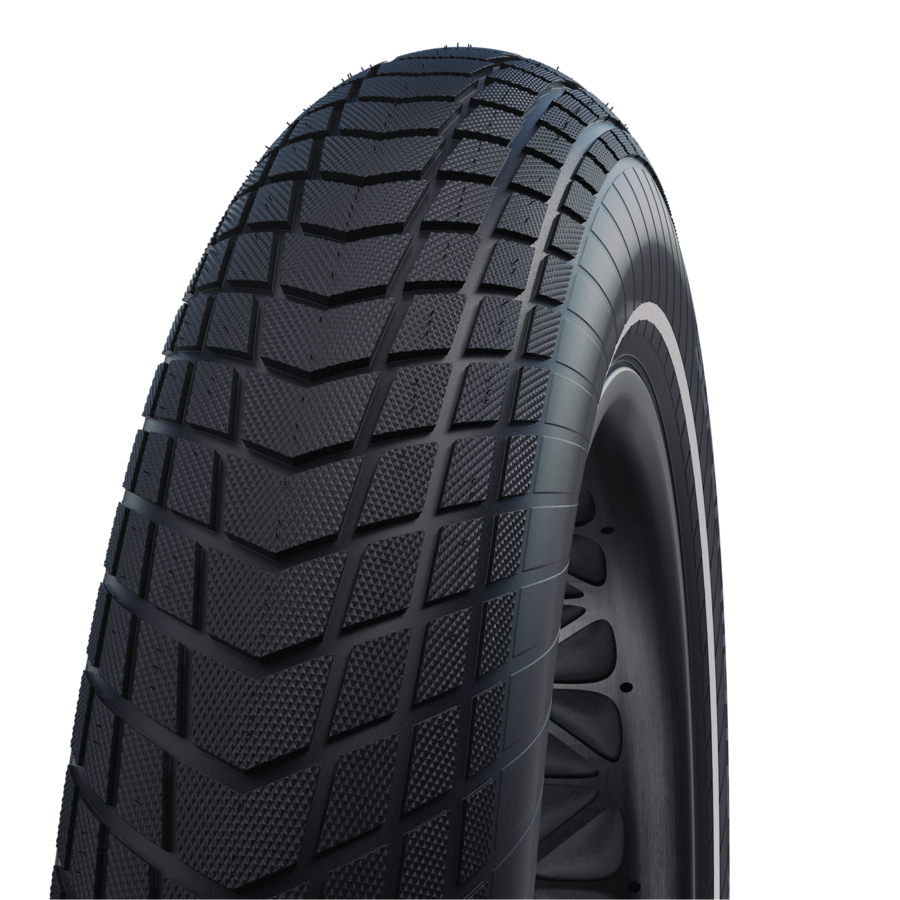

Schwalbe makes a Super Moto X tire in a 27.5" X 2.4" size.
,.. I found one set on amazon that's 27.5 x 2.40 but I worry those might rub the fenders
I think you'll be fine with that size.
That's only 1¼ mm bigger than your 27.5 x2.35 tires.
Take a look at the space between your fender and tire.
I'm sure that you've got a couple mm to spare.

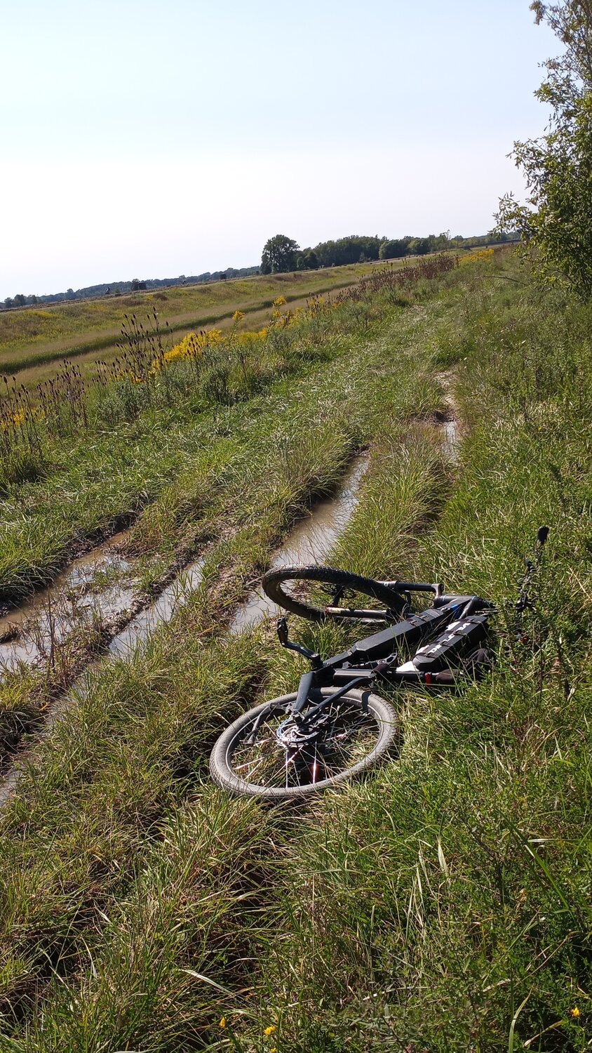

I only miss side knobs when I do dumb shyte, like I did today. 😂
My tires work great on pavement and trails, but they aren't made for ruts or muck. 😂

I too use Super Moto x tires and find them excellent on pavement. Also ride on dirt roads and some gravel and they're fine there. I have also found they wear very well and I ride a heavy e-bike. And as above poster stated, I doubt that the 0.05 inches will make a difference.

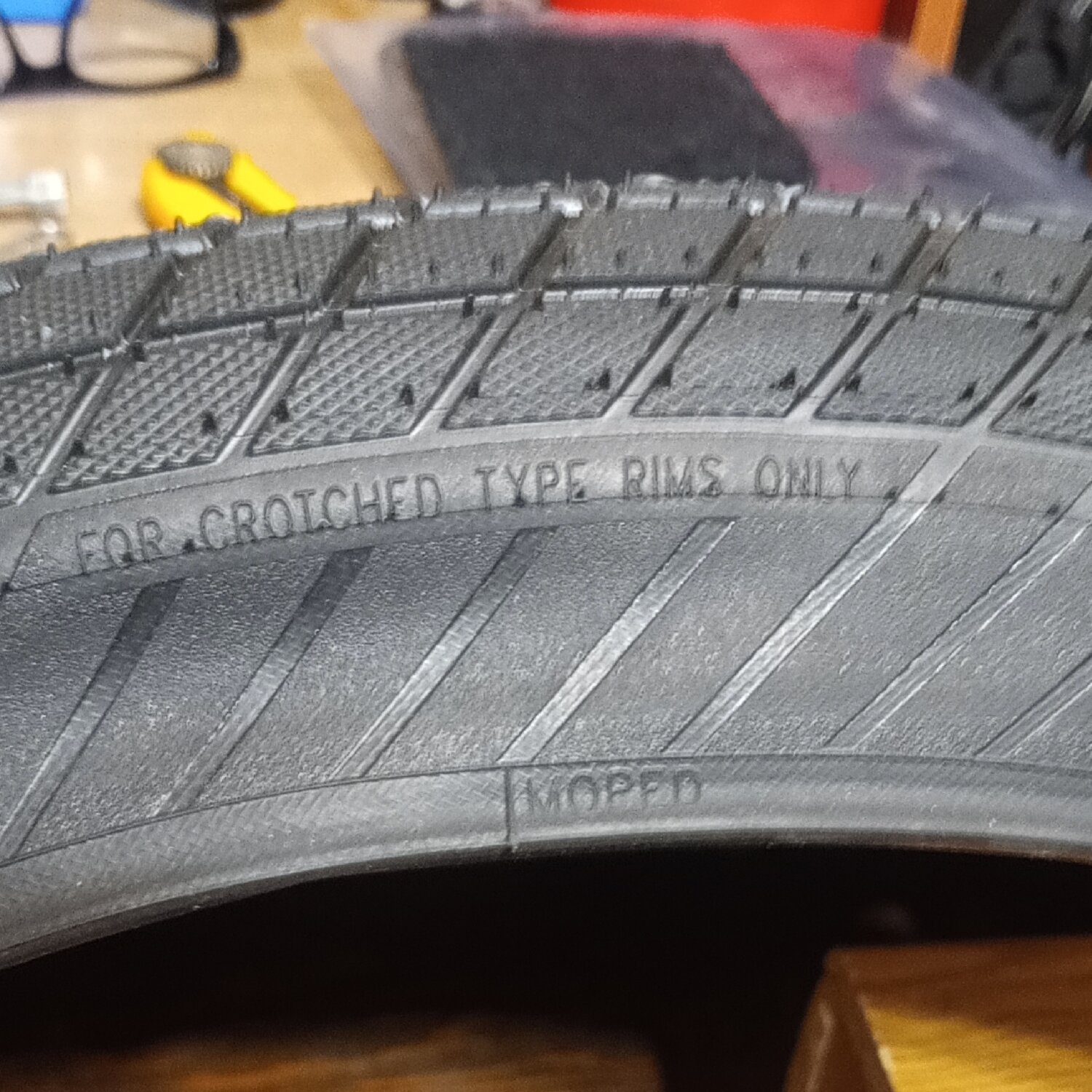

I really likes the looks of the super moto X... I see the tire has wires in the beads. How do I tell if these are compatible with my wheels? The specialized tire looks good too but slightly narrower, that might be good, less worry of fender rub

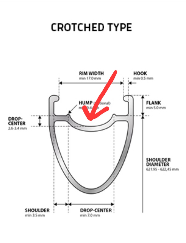

You need to check your crotch. 😂
A crotched rim has a concave in the center that you push the beads into to give you room on the other side of the tire to get the bead over the rim.
I can easily get my tire on my rim with just my hands by using the crotch.
A wire bead tire is stronger and less likely to blow off your rim, but it's heavier and doesn't fold up, so it's not really possible to carry a spare.
(Unless you put it around your neck and carry it like a handbag. 😂)
