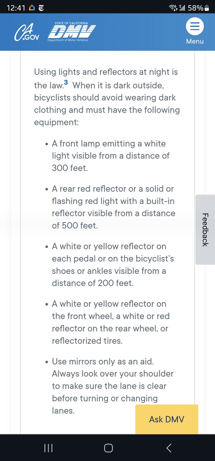

Light and reflector requirements are likely to vary by state. California example:
All quite sensible. Note that tires with reflective sidewall stripes satisfy the wheel reflector requirement.

In California, you can legally wear reflective ankle bands in lieu of pedal reflectors, but you have to do one or the other. Makes sense to me.

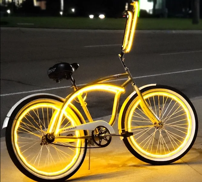

You can buy 25 foot rolls of peal and stick DOT reflective tape. My yellow one ran out after four years. I need to get another. My new helmet with a bright head light on top that can flash is matt black. I want to get some reflective yellow stripes on it. In the US the Consumer Product Safety Commission requires that all bikes come with reflectors. It does not state that they need to be installed by a bike shop prior to sale. Just that they are offered. We are gearing up for my town's Third Annual Holiday Lighted Bike Parade. It is so much fun. We get a motorcycle police escort. This year we are touring the best decorated houses on the east side. It is Friday December 20th. The Police have enough on their plates with stuff like guns and drugs to not hassle people riding safely and visibly who are not in total compliance with the letter of local laws. A judge would toss out such a case.
