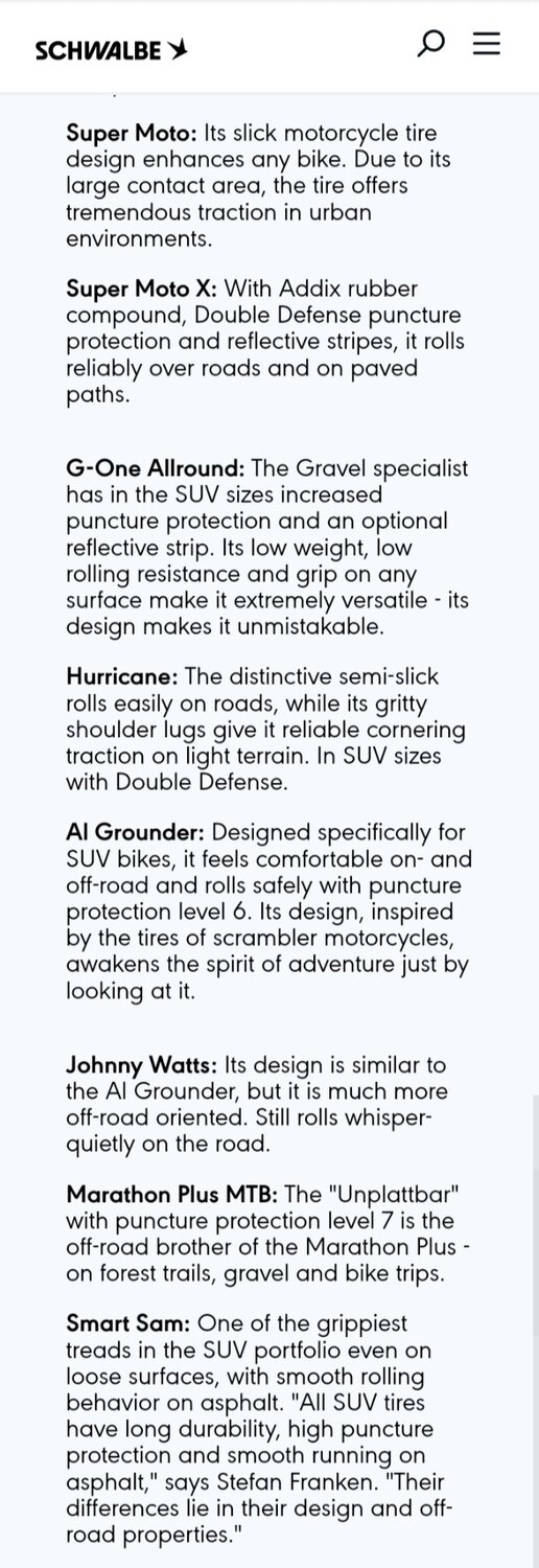

@DTCsjoerd: Please read this review :) There is also a Johnny Watts thread.

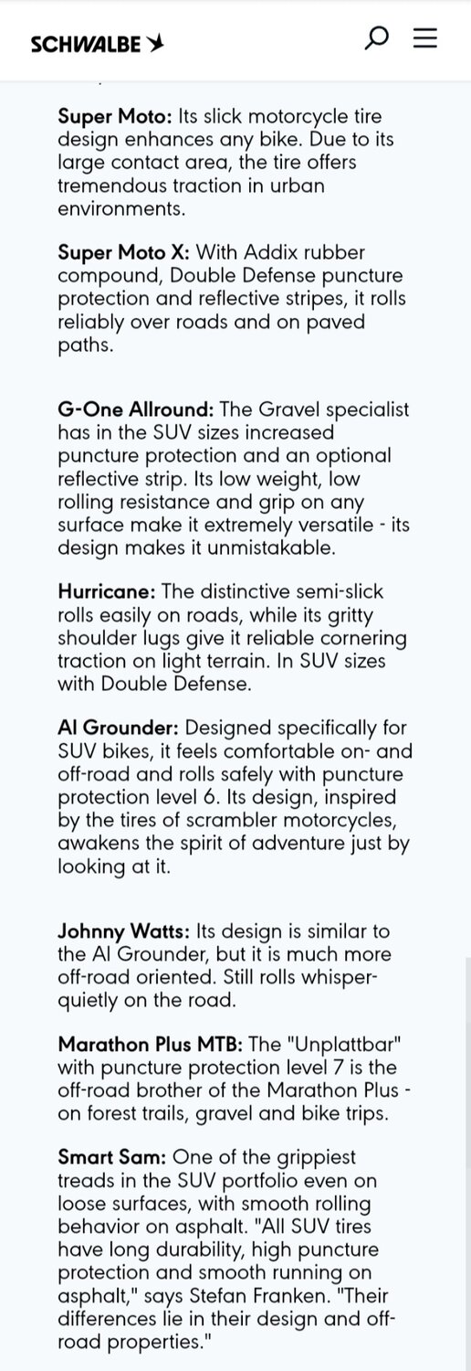

Smart Sam’s appear to be more off-road based according to this summary.

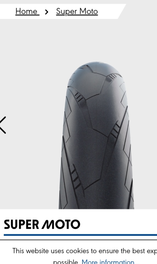

The "E" tire ratings for ebike use are standardized.

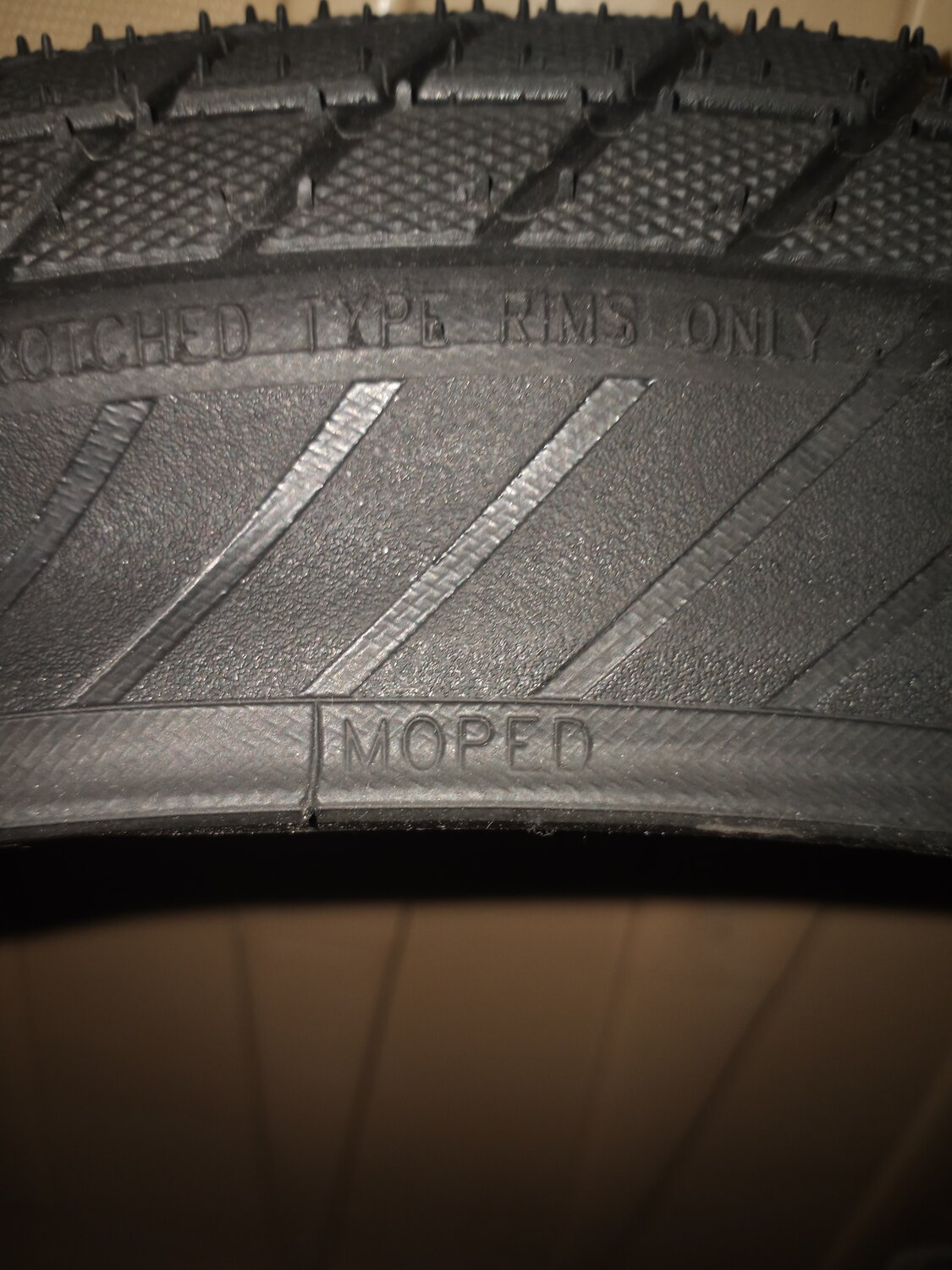

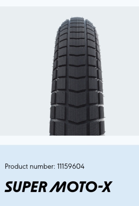

My Super Moto X tires have MOPED printed on the tire.
I feel more comfortable knowing it's Moped rated.

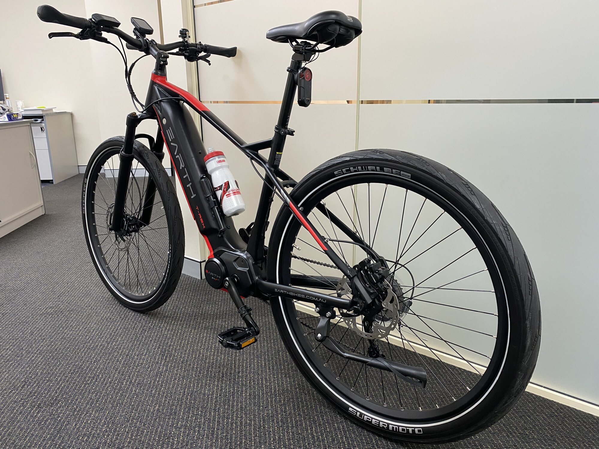

I went with the wire bead version figuring that it's a tougher tire.
You can't fold it up and carry it as a spare though.

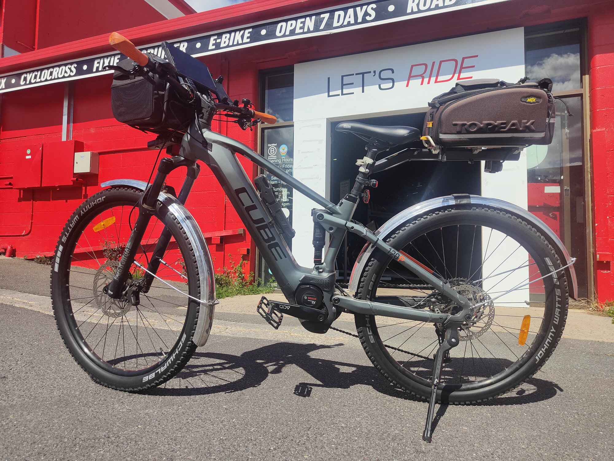

I bought a Cube Stereo ~18months ago, stocked with Smart Sam. I found the Sams noisy on the bitumen and concrete shared paths. The Cube is set for touring and I've ridden it Canberra-Sydney three times (twice with Michelins). Like you I'm ~80/20. I replaced the Smart Sams with Michelin Protex Cross Max. Not cross at all; very unstable on gravel and all offroad, But at the time most use was road, so they stayed on for ~12months. Now more offroad and after YouTube research decided on Schwalbe Johnny Watts. I think they're great. Call it soft or supple, they're quiet on the roads and they do a great job offroad. I highly recommend Johnnie Watts
