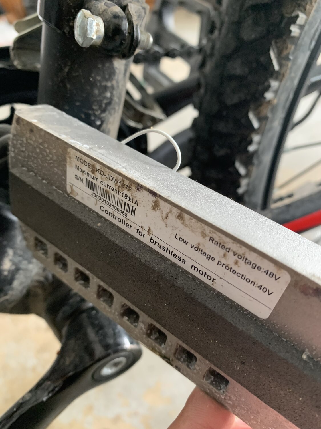

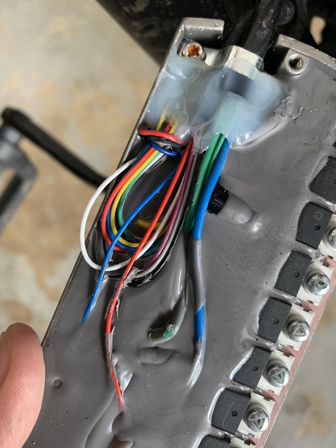

I need to find a replacement controller for my ancheer e-bike
Shahaabmir4

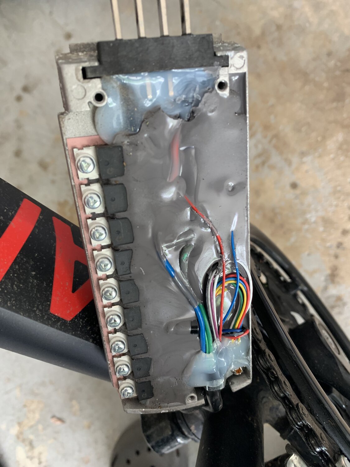

Hi I have a 26 inch ancheer e-bike that I have had for well over a year I love it https://a.co/d/in2kqqc
Recently my controller blew and I need a new controller but I can’t find a exact match online below are some pictures and I hope someone will tell me where to buy and exact replacement thanks in advance

If you cannot get it from Ancheer, it's a long hard path. I was exchanging posts with someone a few years ago ago with the same issue and I'm not sure he ever got the replacement going,.

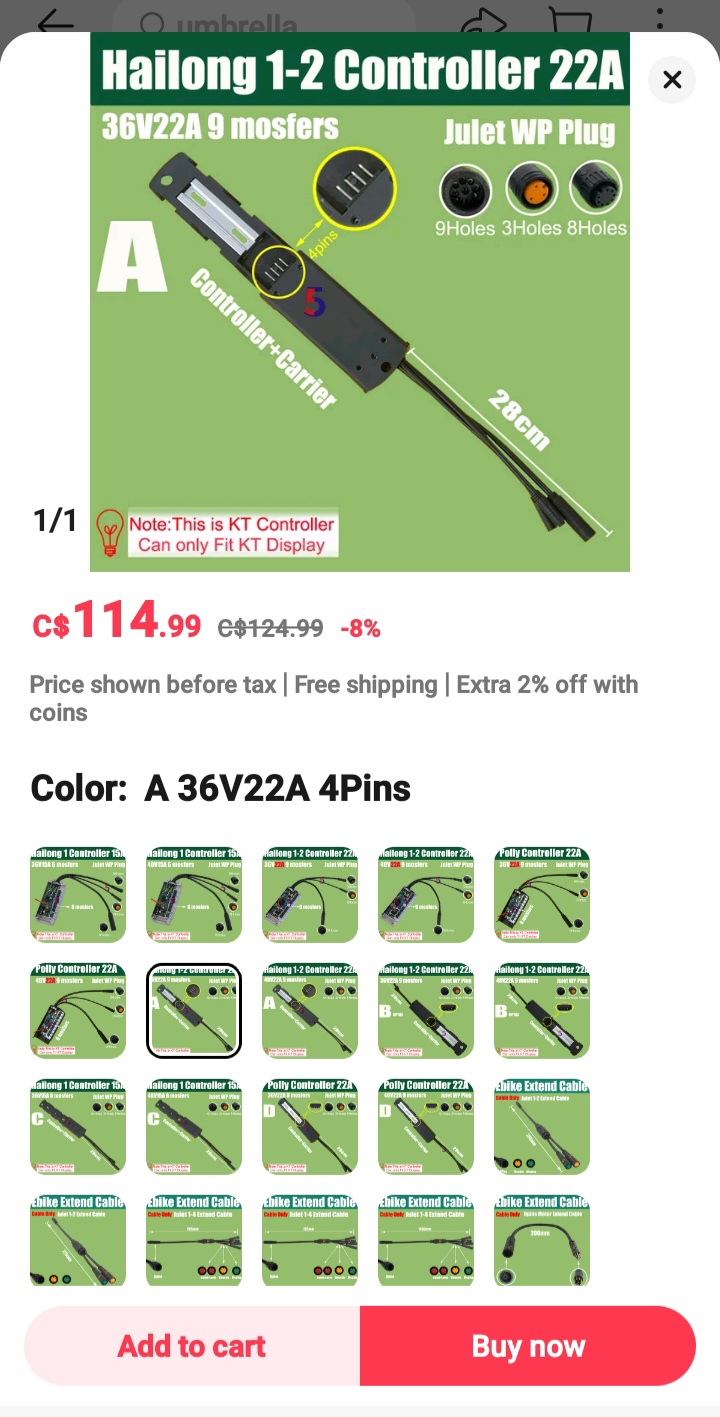

It looks like a controller that fits inside the battery cradle. Most of the units you probably have found online are probably KT controllers that may not work with your bilke display Controllers only work with displays from the same manufacturer, If you buy one of them, you probably should be prepared to replace the display too,

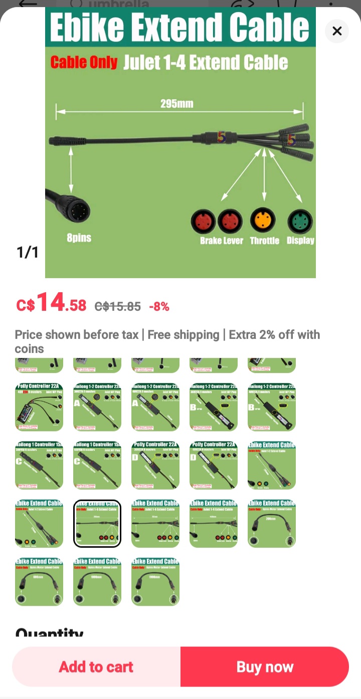

These guys, for exanple sell the controller/cradle together, but the cradle may not fit your battery, Just pointing how tricky it is to buy something just looking at pictures.
A possibility is to buy a discrete case controller/display and mount it on the frame. You can extend the wires from the battery cradle to it.

Hi all. Same issue. Motor dormant. It's down to controller or mxus rear hub 36v 350w ? brushless. Bought Bike used, not working Ancheer. newbe (duh) to ebikes. Full ~41.7v battery power. All red LED's (PAS levels) on display blinking RED. Anybody know what 5 reds means? I am using this bike to learn the ropes and still think I could get it going, knowing all too well what the community thinks of my efforts. Edison tried over 5,000 combos until he got the incandescent light bulb to work. I'm only up to 7 or 8!
Discoed brakes, PAS and throttle and motor. No 5v to throttle, PAS (with external 5v applied, working - puts out ~4v intermittently when spun) and no B+ to motor. Ready to take Harry's advice and purchase controller (mounted on downtube) and display package but need to know if motor is the original culprit. If so, what is an inexpensive controller set to purchase keeping same volts, etc.

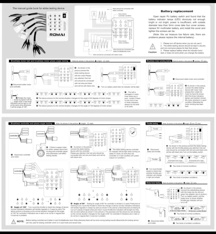

Can anyone tell me how to check the motor? I think to mimic the controller with external B+ source and then recheck sensors and phase wires (no continuity for all three pairs and have read that this indicates "internal issue with motor"). Need to know proper Voltage from controller to mimic (test sensors) or is this motor toast? Any thoughts are welcome and thanks to all for your great past advice.

Since battery seems healthy. Could be a stuck brake sensor. You can disconnect the Ebrakes and retest. I believe the first order of business is to identify the display. There might be a model number on the back. Sharing a photo will also help as some one may know exactly what that display is.

Disconnected brakes, PAS and throttle and motor. No 5v to throttle, PAS (with external 5v applied, working - puts out ~4v intermittently when spun) and no B+ to motor.
That's not right.
The controller "makes" and sends +5 Volts to the PAS sensor, the throttle, the brake switches, and the display.
If you aren't getting +5 Volts at those sensors, then the controller is at fault.
The controller should always be putting out +5 volts, unless there's something with ANCHEER programming that is shutting it down. (But I doubt that. The +5 Volt circuit in the controller is probably fried.🍟)

From @harryS 's link, there are a bunch of options available,..
This is the cheapest option at ~$62 USD,..
It should work for you but it needs to connect to your battery.
@harryS can help you pick the right one.
You might need cables and a display too??

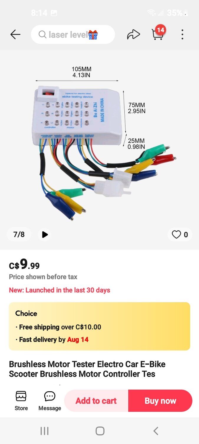

You can buy a motor checker tool for around ten bucks,..
Lots of fun figuring it out,..
You can also test your motor with your multimeter, but the little tool with the blinky lights makes it a lot easier.
(And it's kinda cool too.)
