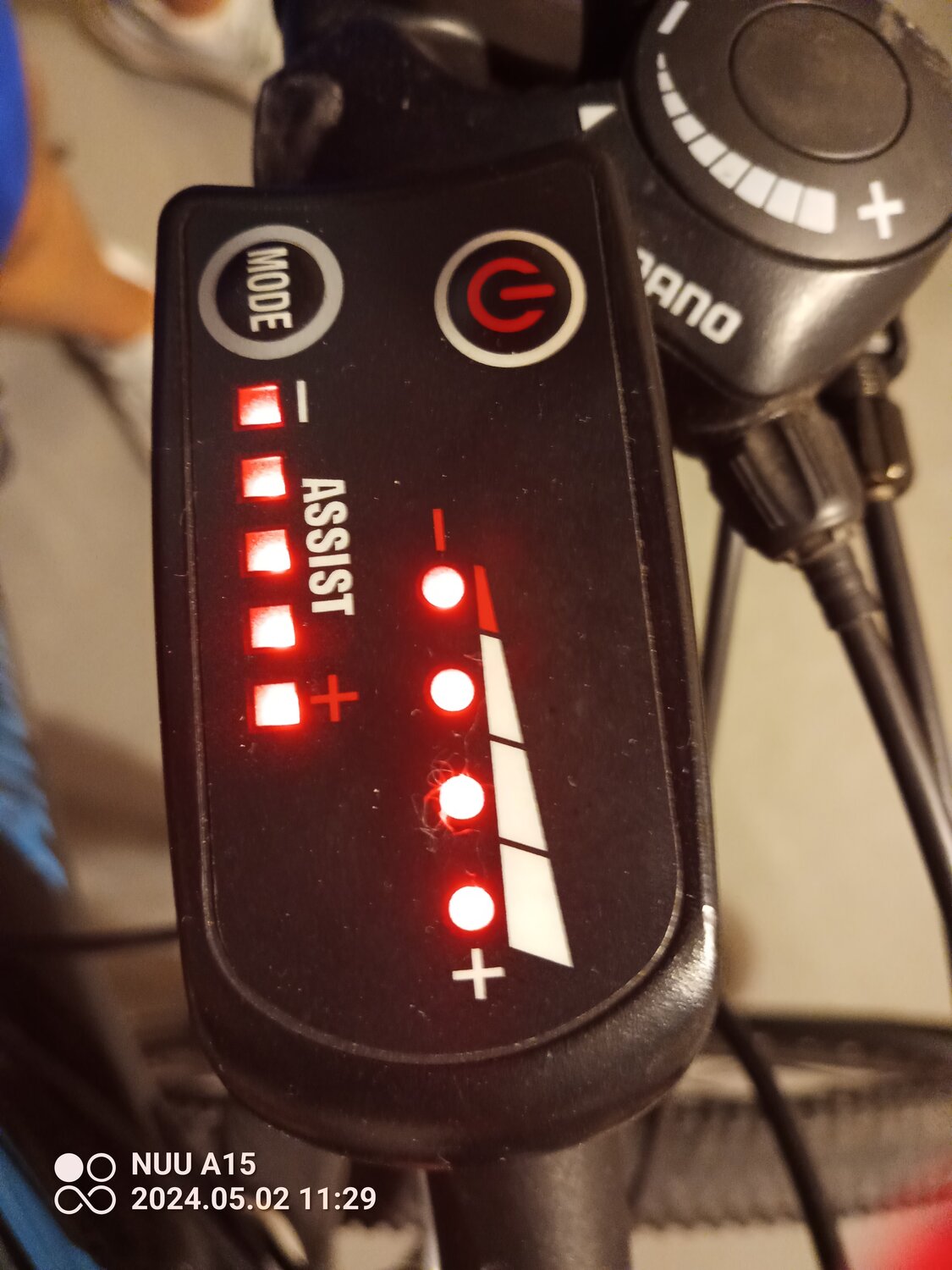

New to ebike. "assist" all 5 lights on. batt 42v full, bought used 36v. Anyone have a troubleshooting guide, preferably with voltages. See picture.

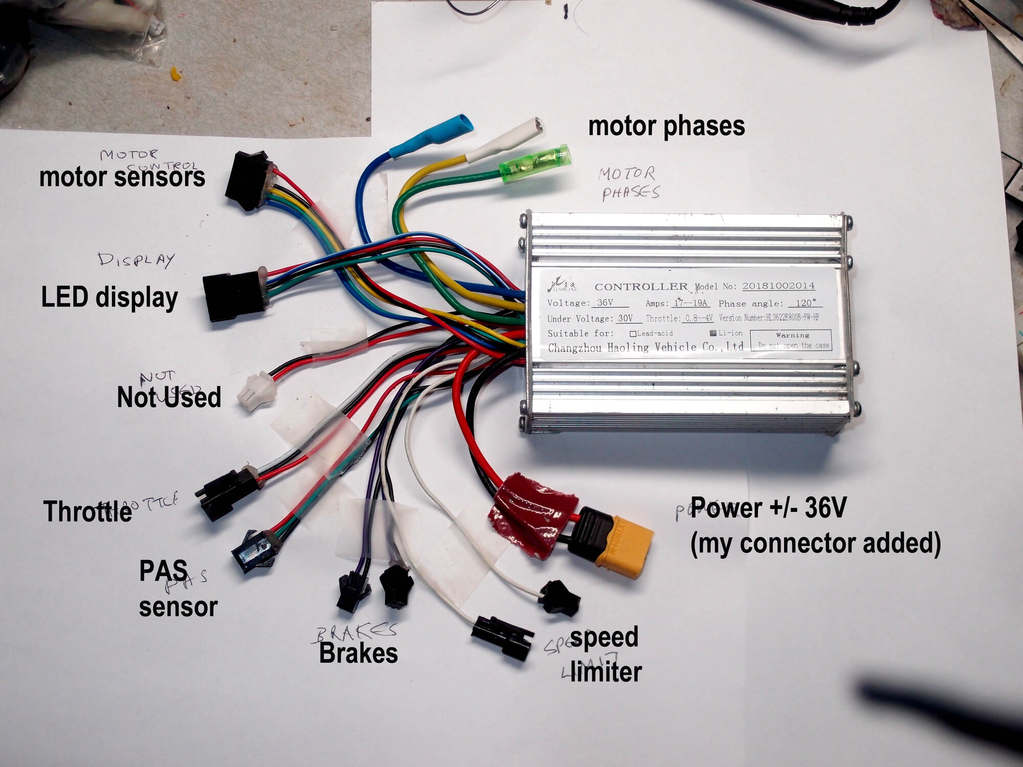

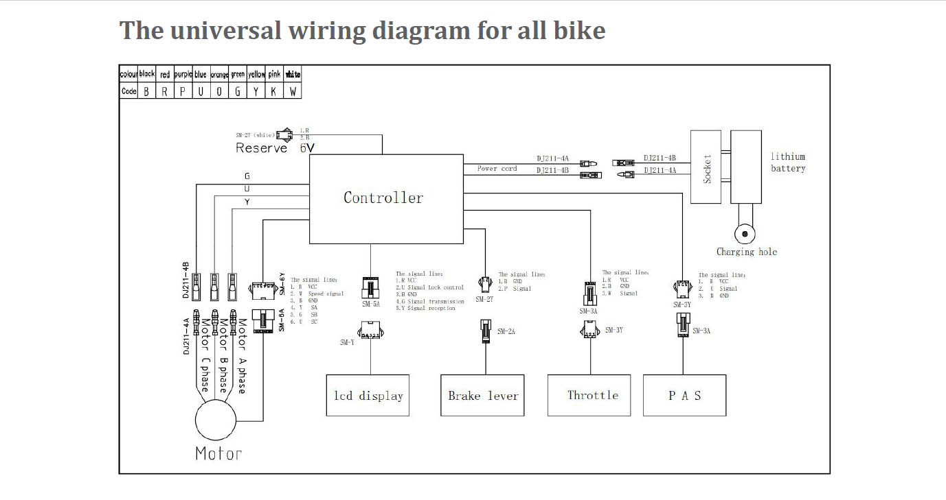

These basic ebikes are very similar anf will have the following schematic.
The controllers all have similar connection categories>
1. Motor is three phase wires and 5-6 sensor wires, Either done with 8-9 discrete wires or a 9 oin molded cable,
2. Brakes are two sets of double wires, The brake switch is on/off, normally off when brakes not engage,
3. Throttle in your case should be 3 wires. It uses a rotating magnet in the throttle and a magnetic sensor chip, Powered by 4.5V and output goes to 4V at full throttle,
4. Pedal Cadence senor has a disk with 6-12 magnets that spin past another magnetic sensor, Powered by 5 volts, the output flips between 0 and 5V as the magnets pass by.
5. LED display, This runs on 36V battery power. It has 4-5 leads. Two arepower and groumd When you turn it on, it raises a third lead to battery level, which is used to power up the controller. The four lead models use a discrete DC voltage levels on the last wire, to signal the controller what power level is applied. The five lead models are much more sophistiocated as they will send serial data back and forth on the two remaining leads.

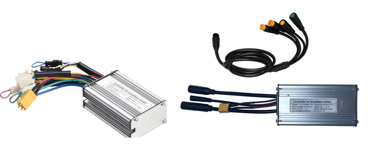

This is typical of what;s used in $700 ebikes like the Ancheer. Tell us what your controller looks like,

Just saw your most welcome response with schematic; and downloaded the manual. Would really love to find which of your damage suggestions or how many of the problems this bike actually has. I enjoy working on it and would like some day to ride it! Just can't measure much electrically as I must be missing something. Controller sits under the battery, sort of, and after opening, found only black covered sets of wires going various places. Nothing like the picture of colored wires exiting the controller. That keeps me from testing. No color wires anywhere. Thanks again

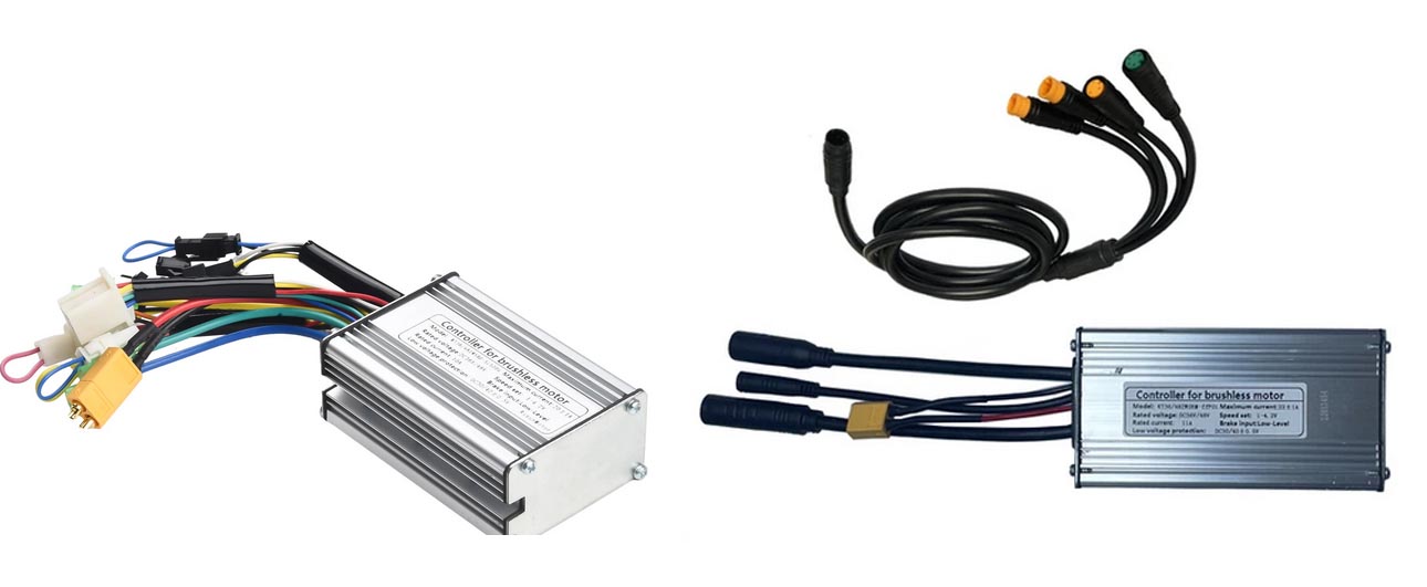

You never mentioned what kind of connectors on the Ancheer controller. Whther it has the flat or molder connectors. The latter are difficult to access.
If you have the cheaper ones on the left, which I would expect on an Ancheer, you could stick pins into the back of each connector to reach the contacts.

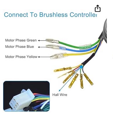

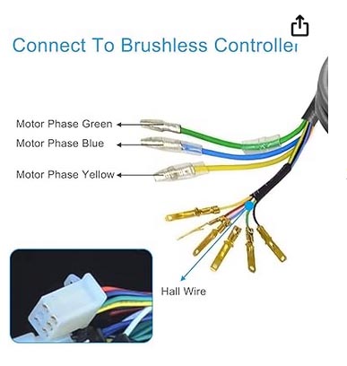

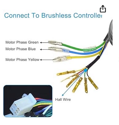

Follow the motor cable to the controller. It should break down to three thick wires with bullet connections, and five or six thinner wires in a rectangular connection.
Unplug it, power up the controller and see if you have 5 volts across the red/black wires in the rectangular connector. That will tell you the controller has internla 5V power. It uses this to run the throttle and pedal sensors as well as the wheel sensors.
Now that you've identified the motor connector, you could plug it back togther and test the sensors, Tou'll be checking the blue, yellow, and green wirs vs grYund (black) on the connector.

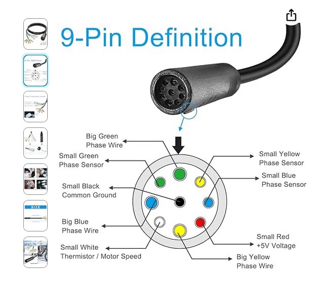

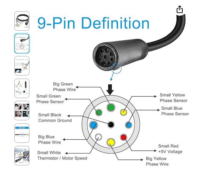

Round molded connectors require a DIY mentality, You can figure out that yourself, I will leave you this diagram for the 9pin motor connector if you have one. First. make sure it's seated properly. It's keyed, but some people have ,anaged to force them in backward and fry the controller. You can at least test for 5 vlt power easily.
