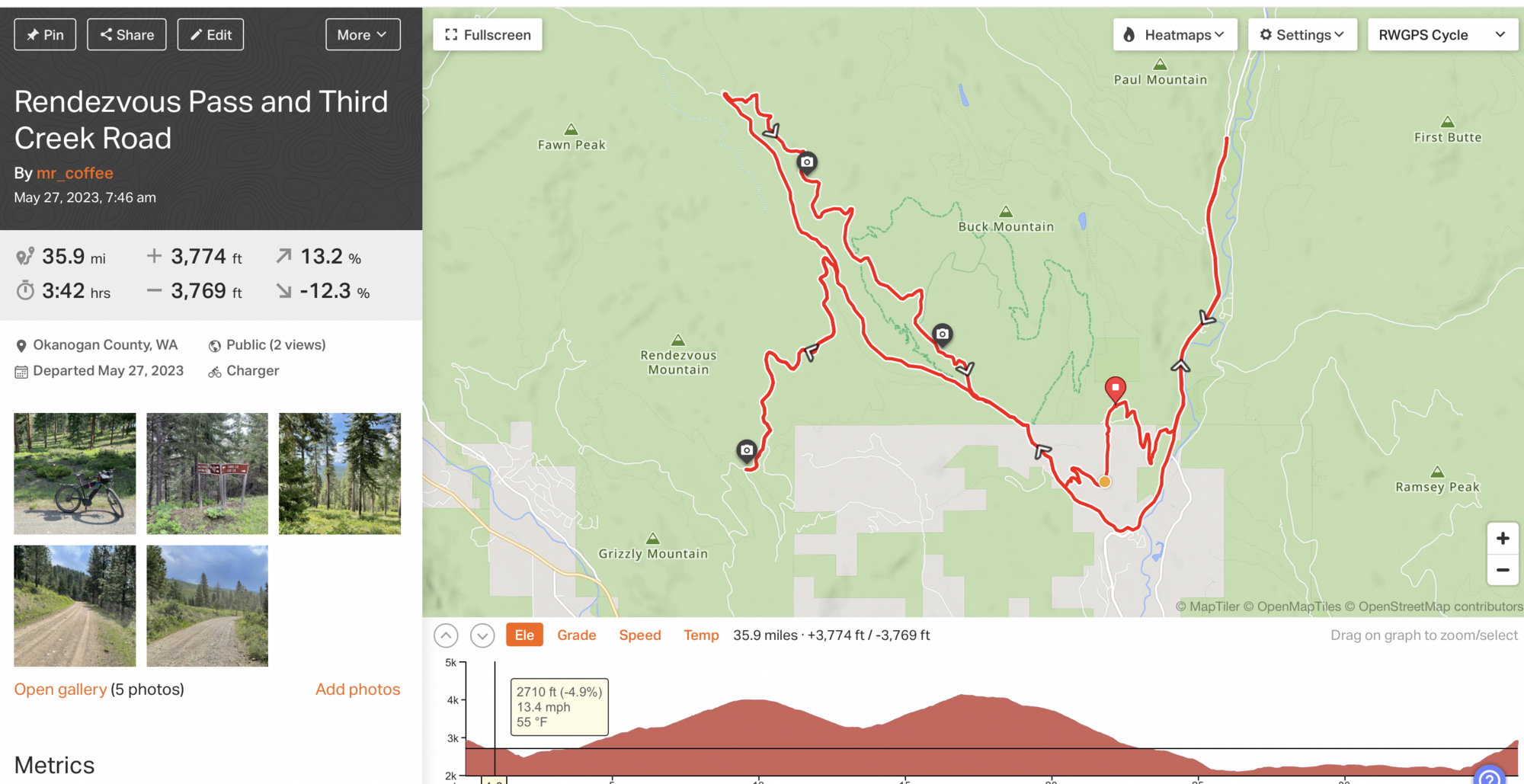

15" grade is no big deal on my Bosch. when I say grades I got up 18% grades every day and and one 20% grade almost every day. with the mid drive we can do that on our tandem too. it takes effort but its doable. I have done 1700 feet of climbing in less than 10 miles before.
