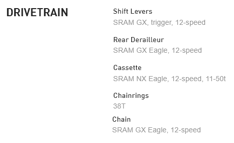

My riding buddies all are telling me I should not replace the freehub body but just buy the SRAM NX Eagle PG-1230 12s cassette (11-50T). That cassette fits the HG freehub body, and the only thing you cannot have is the 10T cog, which I do not need anyway :)
I wonder whether I could use all other drivetrain components from Shimano? (Except for the chainring, which I could choose freely from a wide MTB offer). My brother tells my I should totally go SRAM to be kosher in this case :D
@sanyata, @Bavi:

@sanyata, @Bavi:

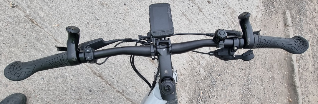

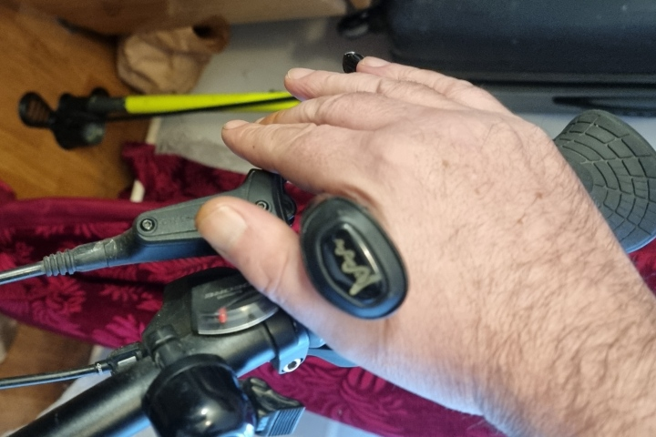

I wanted to show you why SRAM shifters are a no-go for me. I could not take the pictures while riding, so the hand position on Innerbarends is slightly inaccurate here. Plus, I have rotated the Shimano shifter even more (the pictures are exactly one year old) so now the SRAM shifter would be even more inappropriate for my needs.
A normal hand position on the bars. The hand rests on the handlebar grip, and the Innerbarend only fixes the hand position. (You do not hold on the IBE!)

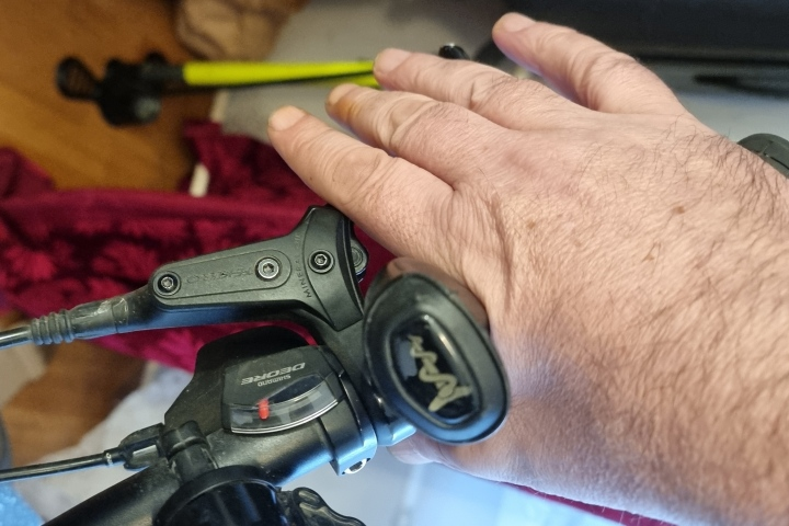

Upshifting with a Shimano shifter. I just pull the lever.

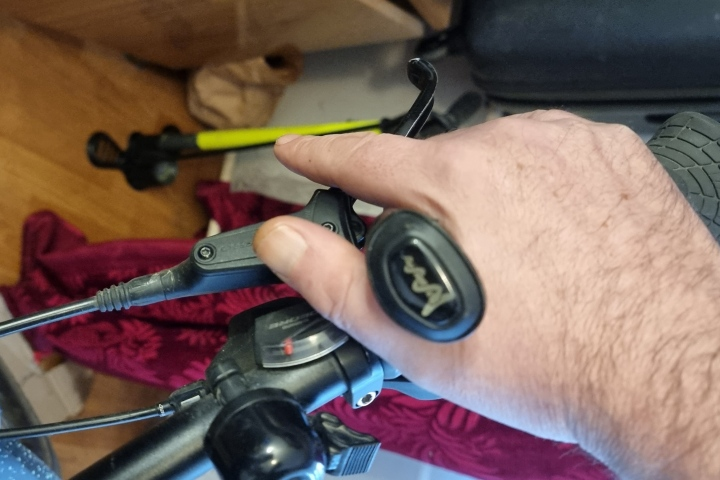

Downshifting. It is possible to push the lever down even by three positions easily without changing the hand position.
(Almost) the current setup. Now, the Shimano shifter is oriented the way the silver bolt is fully on the vertical. An easy access to push the downshift lever and it is also easy to pull the upshift lever.
I was riding a bike with a SRAM shifter and it was managable if no Innerbarends present.
