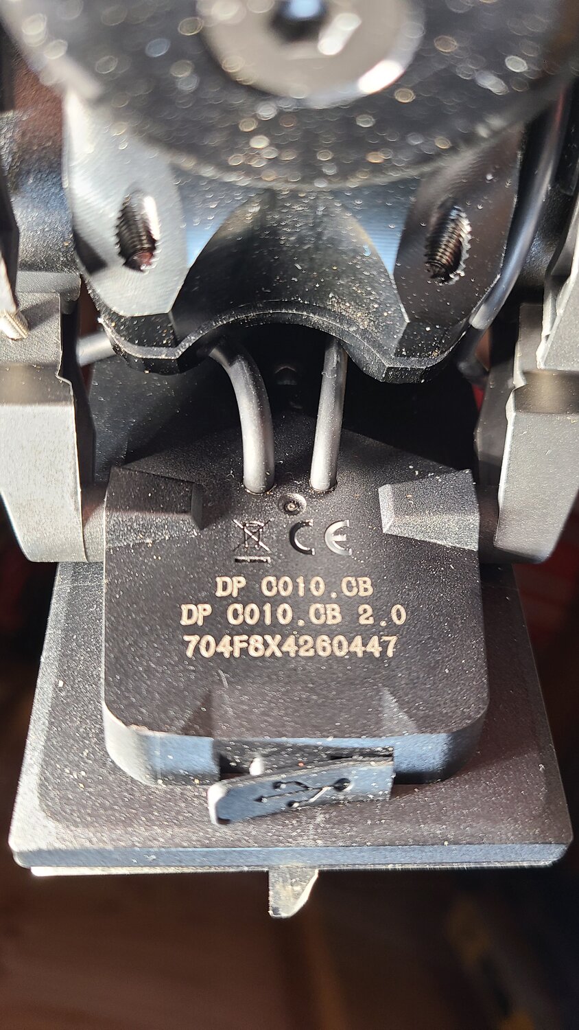

Just got a new bike! Bafang M620 G510 Ultra (CAN Bus) and the display / HMI is the DP C010.CB
The specs say there is Bluetooth 5.0.
I downloaded the Bafang Go+ app that was mentioned in the manual for the display.
Unfortunately, I'm unable to complete the connection. The app sees the display, but nothing happens once I try to connect.
Currently unable to change tire size, change max speed limit, nor switch battery percentage to volts
Any help appreciated.
(Using Android 13 on a Galaxy S20+)
Tried on a Galaxy Tab A8. No joy
