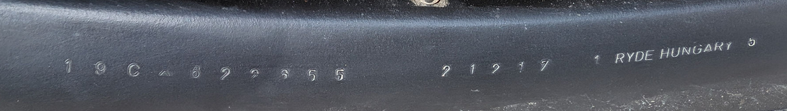

I want a second set of wheels so I can change out tires more easily. I want another set of the same wheels or something equivalent, but searching for online leads me down rabbit holes. I simple want the same wheels or something equivalent. Does anyone know of a source for these wheels? I searched for "Ryde Hungary" but that company only appears to be the manufacturer of the rims and not full wheels.
This does not look like an easy cake. Here is the rim itself:

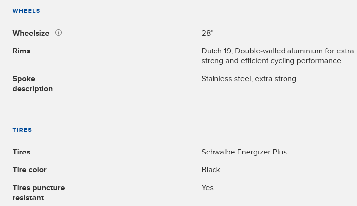

The issue with regular "full power commuter e-bikes" is these do not usually have the standard wheel hubs or rims. The issue with the Gazelle is the manufacturer even does not give the wheel parameters, which is so different with some other brands.
Gazelle spec for the T10+ wheels... Hardly any information.

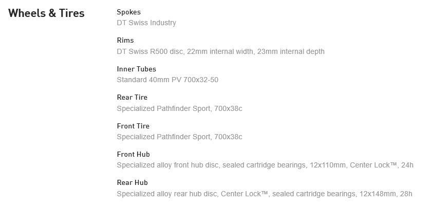

Specialized spec for Vado 4.0. The only missing information is the inner rim width (but that can be easily measured). It is the standard MTB front hub and the rear hub is MTB Boost standard, a 27.5" wheel with 32 spokes.

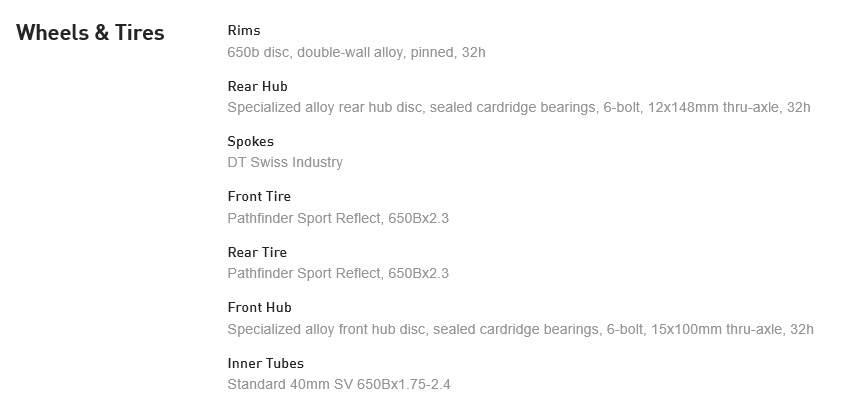

Specialized spec for Vado SL 5.0. Based on these specs, you could buy or build a spare wheelset. It is the Road Boost standard.
It is too bad that Gazelle does not provide more details on their products. I called into Gazelle USA offices with a question, and they were very helpful. It might be worth a call to see if additional wheel specs are available. Short of that it would seem to be possible to simply get the measurements off the existing wheels and frame. A quick google search pulled up some quick resources. Here is one example:
