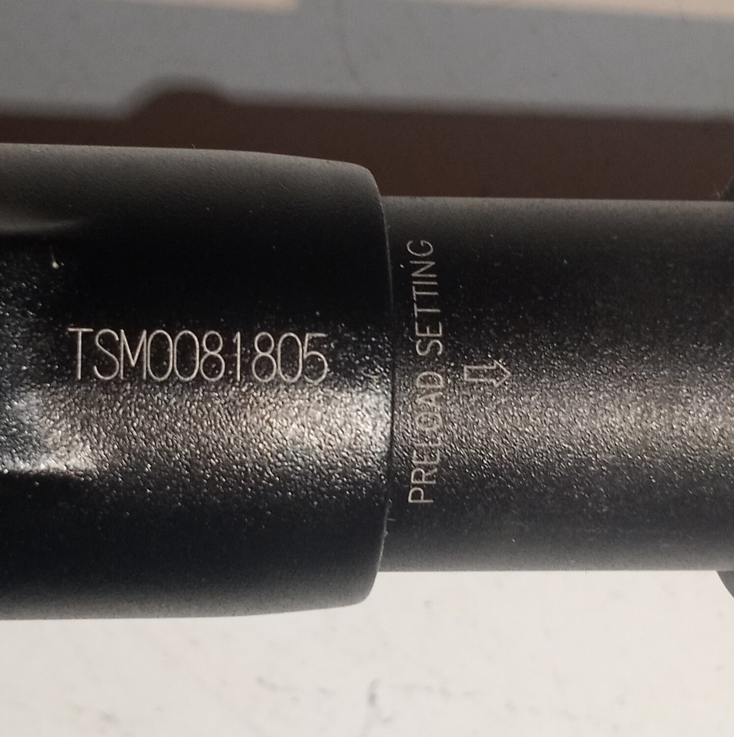

Hello all -- I've recently purchase a Suntour NCX SP12 suspension seat post, and am setting it up for the first time. I realize that getting the preload setting correct is a bit of a "dial-it-in" exercise, but I thought I'd ask folks that I consider experienced how they have their preload set up.
Below are three photos.
Top = preload from factory
2nd = preload +1 turn clockwise (increase)
3rd = preload +2 turns clockwise (increase)
I'm wondering if anyone has a good photo of how their NCX looks when they have their preload set to 1/3 damping as instructed by the manual, or any advice on which of my photos may be the closest to "correct" preload on the unit.
Thanks in advance,
Y

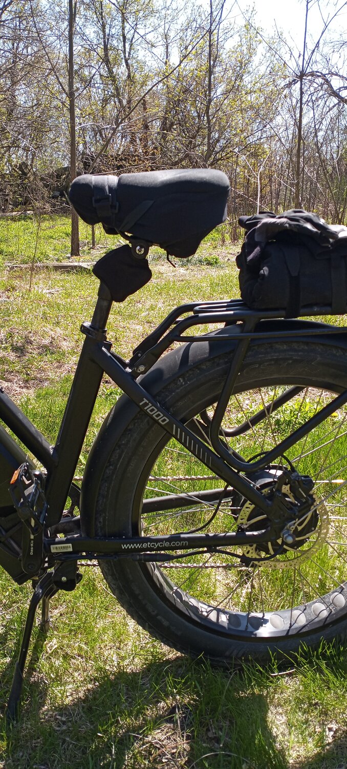

I started out with NCX SP12 with my hardtail Radrover and had similar results. Perfect for larger bumps; but, still felt smaller cracks, bumps, chatter (road/sidewalk cracks, washboard dirt trails, uneven pavement, etc...). I switched to Cirrus Kinekt Bodyfloat a year later and that was a noticeable improvement with the "chatter". I think because you still have a direct physical connection with the SP12 spring compared to more isolation and "floating" with the ebike moving under you with the Cirrus Kinekt Bodyfloat system. I just couldn't get the SP12 dialed in for most situations with work commuting or single track riding like I could with the "set it and forget it" Kinekt Bodyfloat.

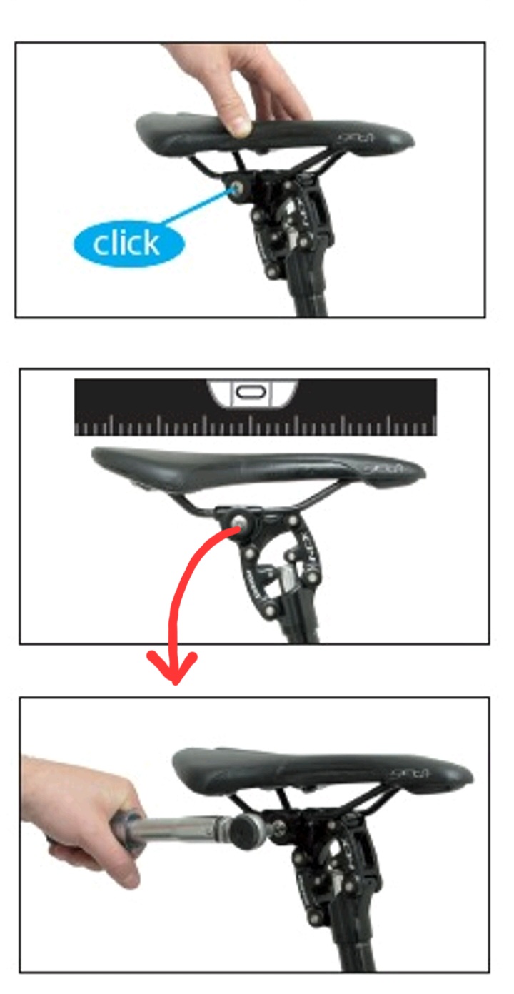

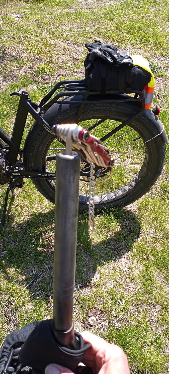

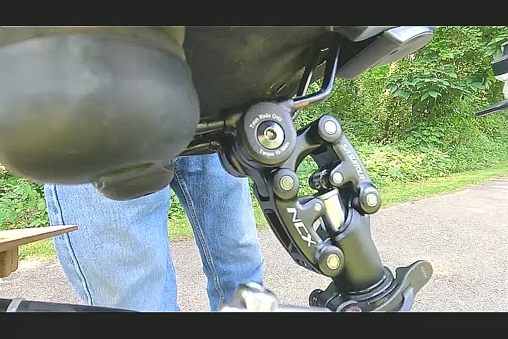

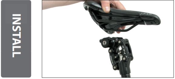

I didn't want to start a new thread to ask a stupid question about the Suntour. I purchased the NCX a few years ago to use on a bike I no longer have. I forgot about it but found it in my storage closet today with a saddle attached so I thought I'd give it a try again. I downloaded the manual for recommendations on setting the pre-load but discovered that the official assembly instructions have the post in the opposite direction of every demo or illustration I've seen elsewhere. The 1st screenshot is from the manual and the 2nd from a YT review but it's the same as a thousand other user and online store pictures. Why does the manual have the NCX in front?

I've been riding my NCX for years with it to the rear. I don't think seat suspension would operate properly with NCX to the front. I think the manual writer made a mistake.
Yes, the Occams Razor explanation is likely correct, and might also explain why few users read the manual: It's simpler to watch somebody on Youtube install his or hers, which is likely what I did a few years ago. I had it set up the way you have it, with the NCX in the rear.

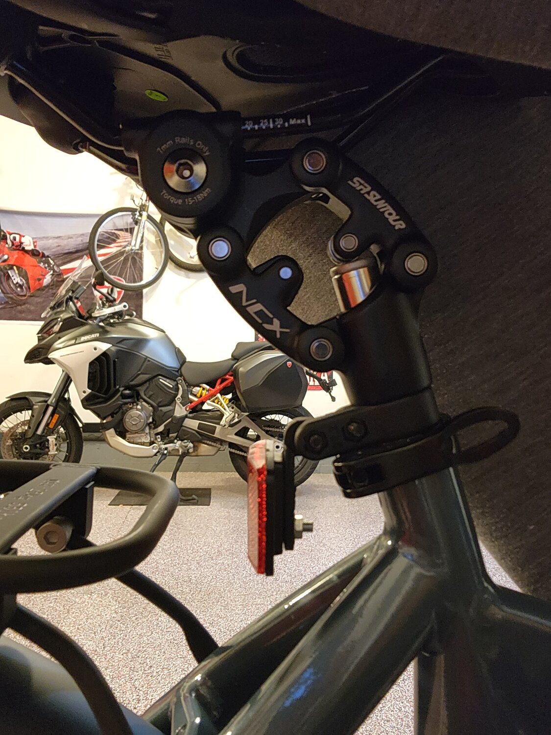

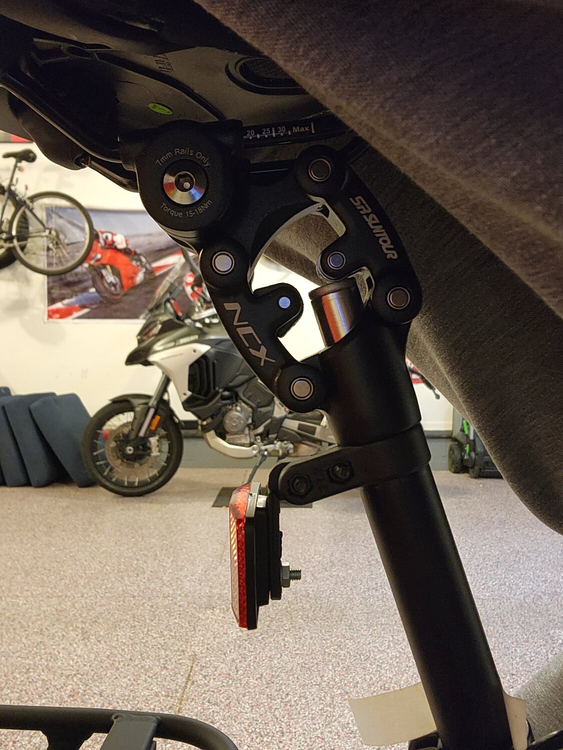

I have the same seatpost and checked the manual, and the seatpost is actually installed correctly.
The seat moves down and back as the suspension compresses,..
For some reason, the post in the manual has the NCX logo on the front instead of the back like all the seatposts they sell. 😂
Maybe it's an older or newer model or for a different market or something, but they should fix the pictures in their manual.
That's just stupid.
My post is the same as yours.

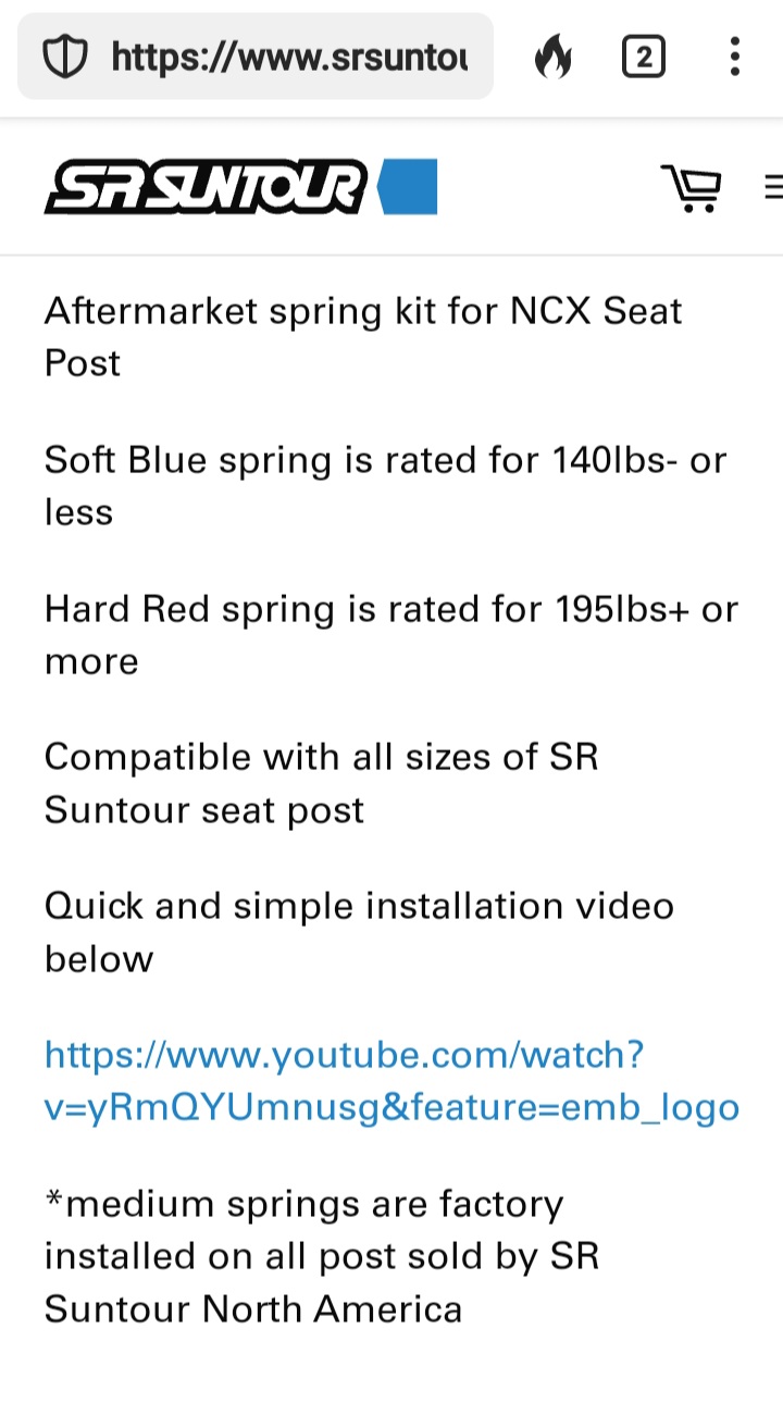

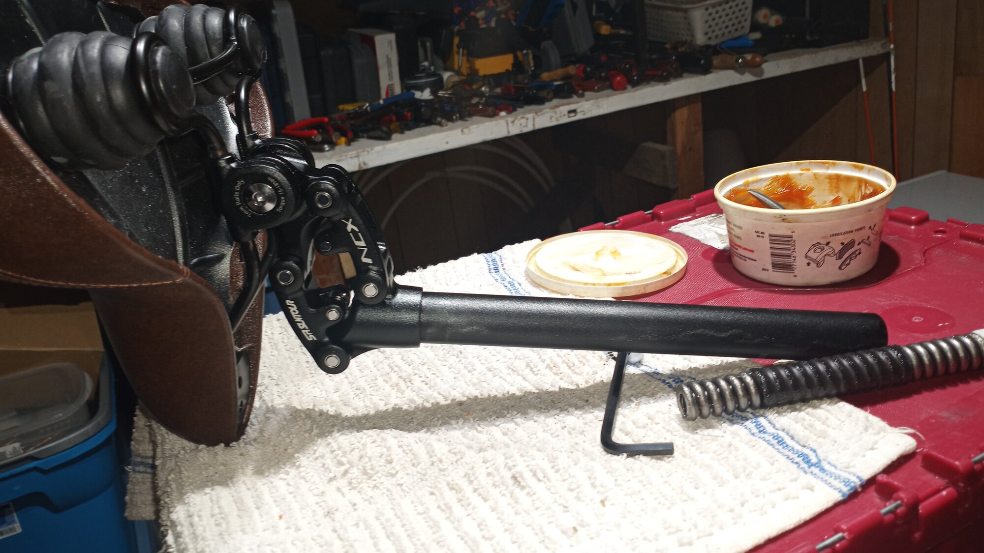

Many people found that the spring is WAY too stiff and they couldn't even loosen it up enough, so they replaced it with a softer spring.
I loosened mine off until the seat started to sag, then snugged it up about 1 turn.

When you bought you NCX seat post, what colored spring did yours have.
I have bought 2 of these seat posts and both have had the Silver colored spring with the Black shrink wrap on the spring.
I think, we need the Blue spring for a softer ride, as the silver spring is very hard.

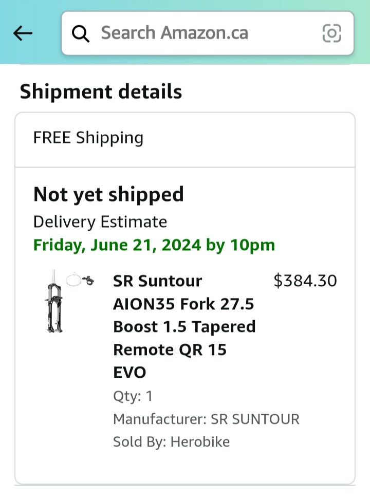

So I went ahead and took a chance on a fake Suntour Air Fork from Amazon,..
I got the last one,..
