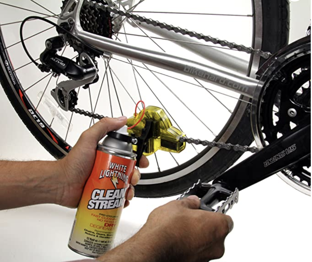

Hard to go wrong with Park Tool stuff, but I found that this Clean Streak setup to be better for me:

With a hub motor you shouldn't have a problem with backwards pedaling to move the chain with either setup, but for mid-drive bikes one has to be more inventive since the cranks ratchet and doesn't move the chain backwards.
With a hub motor you shouldn't have a problem with backwards pedaling to move the chain with either setup, but for mid-drive bikes one has to be more inventive since the cranks ratchets and doesn't move the chain backwards.

I used one for awhile but I dont think it cleans as well and its a lot harder to hold and use plus the smell and cost. when I use the park cleaner it helps debunk my whole drivetrain.
I might agree with it being harder to hold, but not on the other points. It's good that there are different high quality products for us to choose from!
