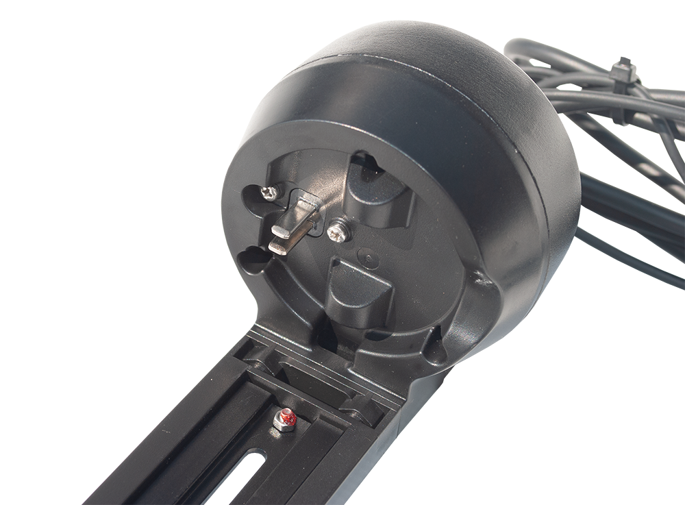

My friend has the same kit and is in the same situation. It appears the controller is built in the bottom of the battery bottle.

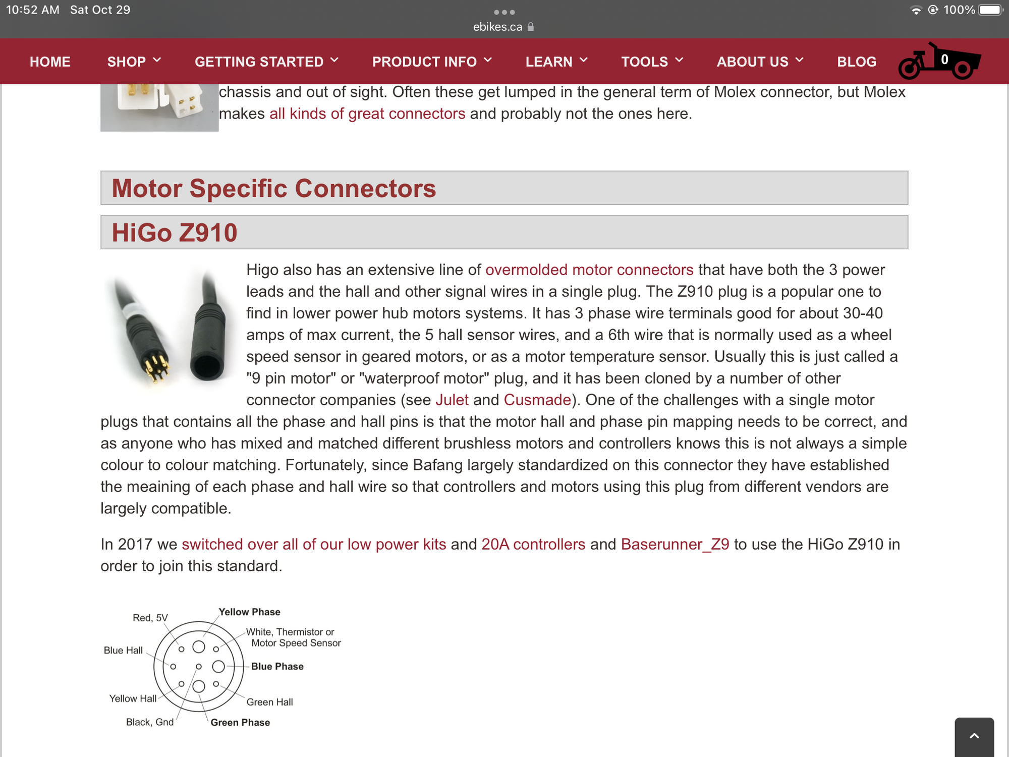

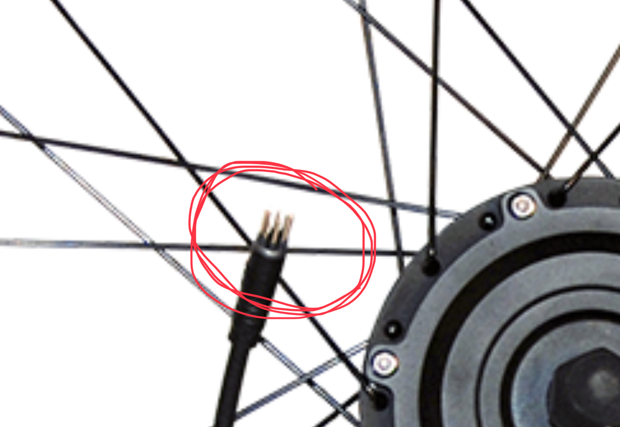

I can see the motor plug and it’s typical and common. @AHicks and others here are extremely happy with KT controllers and displays. That would be a good upgrade option. Someone suggested 48V but we don’t know that your motor can handle that. I’d not try a voltage upgrade. A 36V controller and battery upgrade may increase speed but not over 20MPH IME.

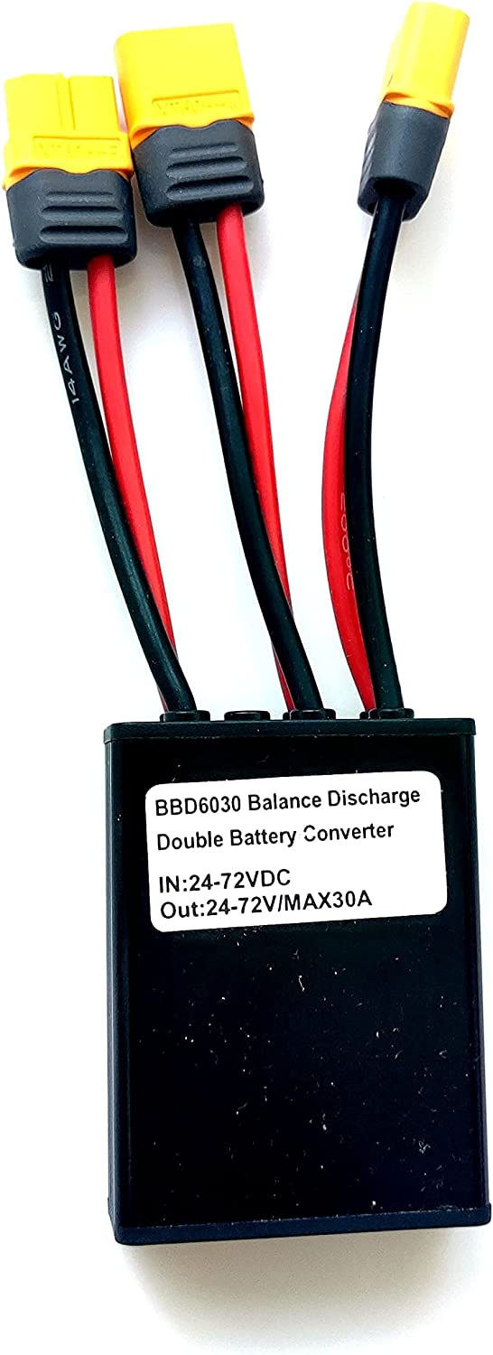

If it is really worth the effort for a higher capacity/more range and if you still want to use the OEM battery and controller it seems there would be limited options. If the controller is in the battery housing I suppose the battery input wires to the controller could be tapped with one of these dual battery switches. If I understand correctly they drain the higher voltage battery (both have to be the same rated voltage) until voltages are equal then drains them both simultaneously.
I have one but am a bit concerned about its use. Have you seen any reliable reviews?
You and I have different levels of confidence in Amazon reviews. Two same appearing products have total of 15 reviews, none negative. I'd try it if I had the need but I don't. No idea how it works, maybe just a couple MOSFETs and diodes in the housing?

I just looked at an Amazon one a couple of days ago and its description sounded like BS to me. Go to Area 13 Ebikes and they are taking pre-orders right now on one of these with an expected December delivery. The owner made a detailed video about how it works, and he and his company are a vendor I trust. I also like that it uses XT90s which are a much better connector for this sort of thing than an XT60.
With all of that said, parallel'ing batteries together do not require a device like that. Its a bit of a crutch. I personally believe you should only parallel packs if you have a firm grasp on what you are doing and what the increased risk level is. Its not something that should be undertaken by the novice.

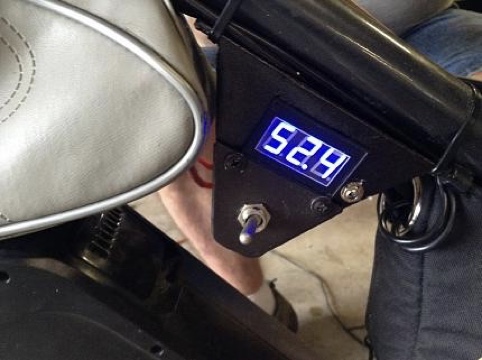

And exactly why I prefer my DPDT switch solution.
Since the Sprinter controller is in the battery, you have to use it that way. And so there is no external battery connector to access for paralleling.
I don't see anything technically wrong with the y-cable boxes that have diodes and heat sinks inside, They are overly expensive for what they do, so they better be reliable. If the diodes short out, you lose the protection..However, the OP can't use them anyway unless he/she has the skills to tap an XT connector to the inside of the Sprinter battery
For a safe installation, it may be less expensive to buy a second Sprinter pack vs spending a hundred bucks on an active y-connector and a second battery.
These dual battery connectors are probably just connection boxes with diodes then. I'm curious to know exactly what diodes and ratings are being used for any of them but the Area 13 looks like a safer choice. With ordinary diodes there are losses due to heat and voltage drop across the diode. For the OP buying another hilltopper battery seems the easiest and most sane path but per their product description the hilltopper controller is in the base of the battery holder rather than the battery housing itself.
An inexpensive higher ah generic battery using connectors compatible with the posts on the battery base should work also. Remove the stock battery and plug in the replacement battery, just don't reverse polarity, strap the battery onto the holder. For sure not an elegant solution and I wouldn't do it myself vs OEM.
