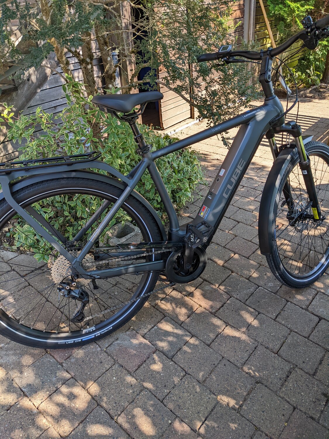

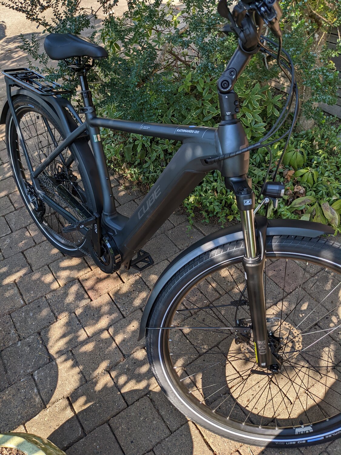

I'm not trolling 😒 Okay I'm trolling.
As a courtesy please include photos of said ebike.
Kathmandu sounds like something smokeable with THC.
Just for you

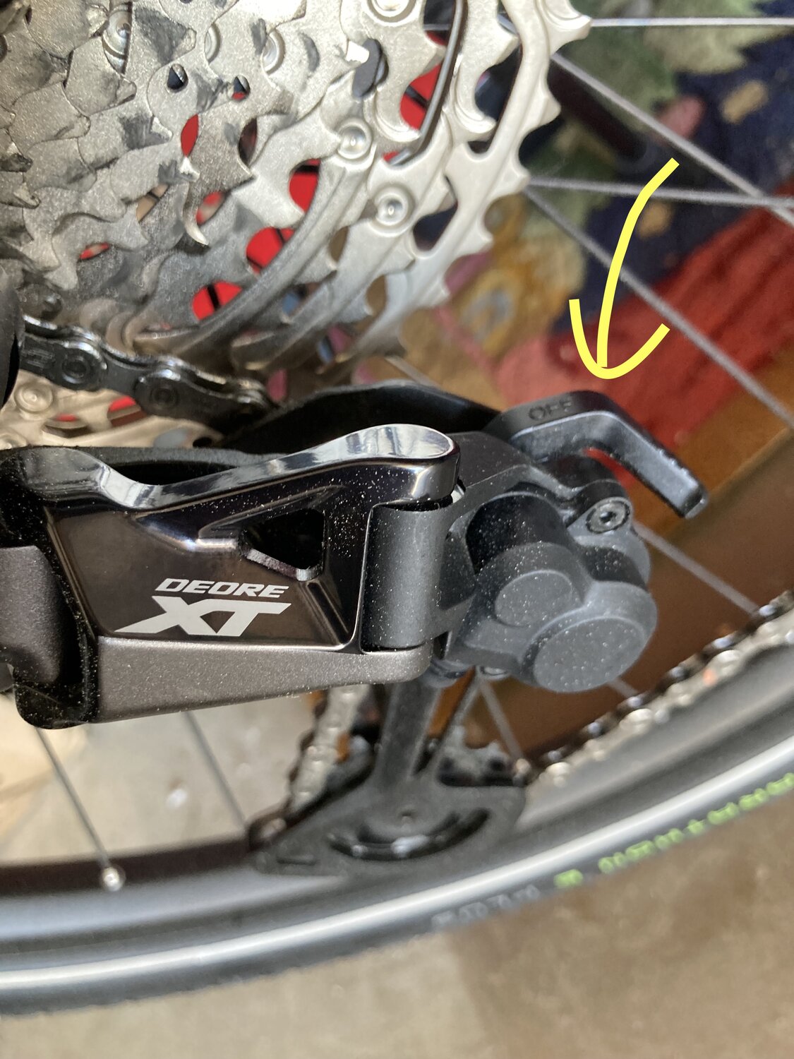

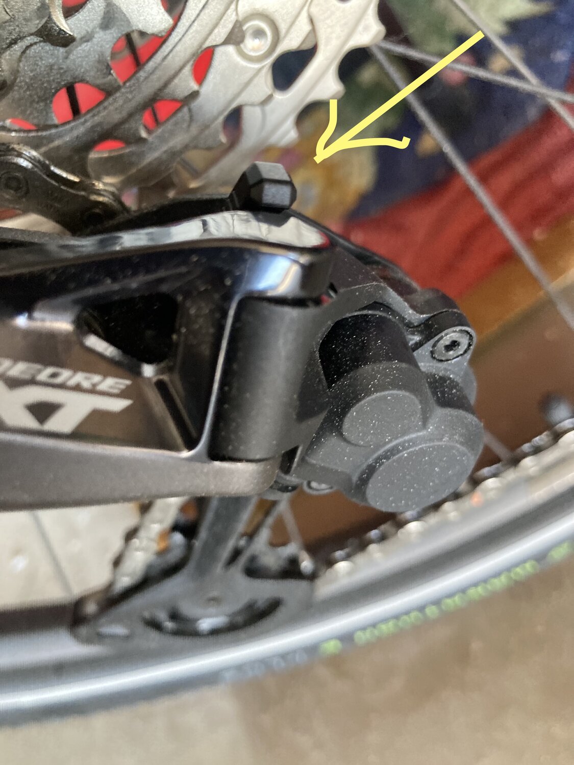

Is there a clutch on the derailleur and is it engaged?
I don't know. I don't think I've had (or known I had) a derailleur with a clutch before. The exploded view for the Shimano Deore RD-M4120-SGS, 10-Speed doesn't show anything like that.
I've been able to reliably reproduce this vibration now. It happens in a lot of different combinations of parameters but it's easy to get it to happen in the 60-70 rpm range at 10+/- mph in eMTB mode on the fifth cog and on flat ground. It definitely feels like a chain resonance and it goes away when I apply more torque to the pedals. My neighborhood is pretty hilly so for the most part it doesn't show up there. It's been a long time since I had a new bike and I'm really blown away by how tight the chain - cog tolerances are. This one is an 11-42 10 speed cassette and I think the prior model years were 9 speed. I am really hoping it can be adjusted away since I really like this bike. @Comfortably Numb which cassette do you have?
I believe my cassette is a 12 speed, 53-11. My Kathmandu is a 2021 625 EXC. For the life of me, I've misplaced my Cube's Manual. I'm confident the big cog is a 53.
I think you're getting there. Check the clutch like Dave says, and maybe physically check every link in the chain for free movement. Also check to see if the chain was installed on the chainring correctly. There's an inner tooth and an outer tooth on the chainring and the chain needs to be on right. CN
Geez....I was just down at my bike seeing if the Manual was in a pannier. I could have taken a picture to show you the clutch. I'll go back down and do that. CN
I have to wait for the photos to come into my laptop. If you look to the derailleur just to the right of where the Deore logo is, there is a lever that will flip forward to release the clutch. Mine has OFF stamped on the lever that shows when it's forward. This lever is vertical when the clutch is engaged. It'll look like a little tab sticking up, just to the right and behind the logo. CN
Ah thanks. No clutch for me. I wonder if there's a way to simulate the functionality temporarily to see if that has an effect. I'll have to look at the chainring later. I don't know about the inner/outer tooth thing. Sounds like another new thing since I've been out of the biking world. Google should help i hope.
Here's the photos.
Do a search on this site. There are many threads regarding the chain being on correctly. CN

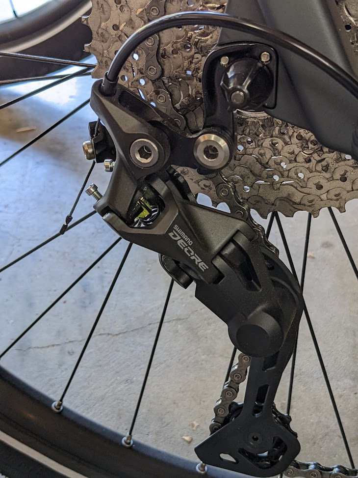

Attached a pic of the derailleur. I don't see a clutch there.
I'll have to look closer later. I just spun the cranks a few times and can see no indication of an inner or outer tooth geometry on this chain ring. The crankset is described as Acid E-Crank 38T, 175mm but I haven't yet found documentation about it.
