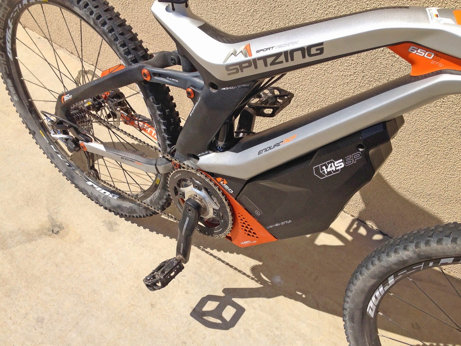

However, there is one bike that uses 14s packs. M1 Spitzing.
Here is a 14s-6p pack from M1.
m1-sporttechnik-spitzing-battery-pack

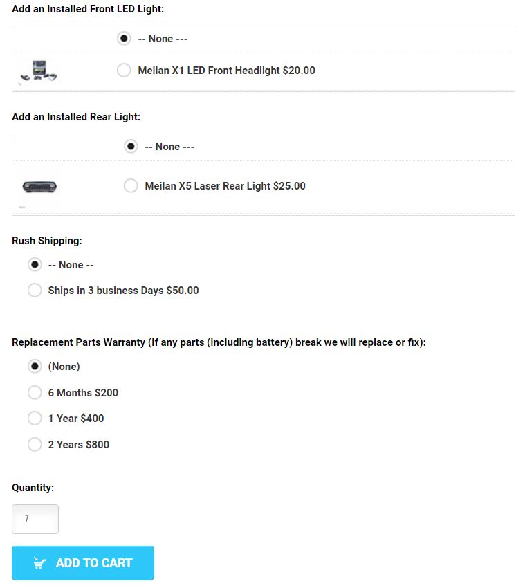

Luna Cycle is now selling complete ebikes so we are not just for DIY
All Bosch bikes or BH bikes come with 2 yr warranty. You don't have to pay $800 to get 2yr warranty unlike Luna.
